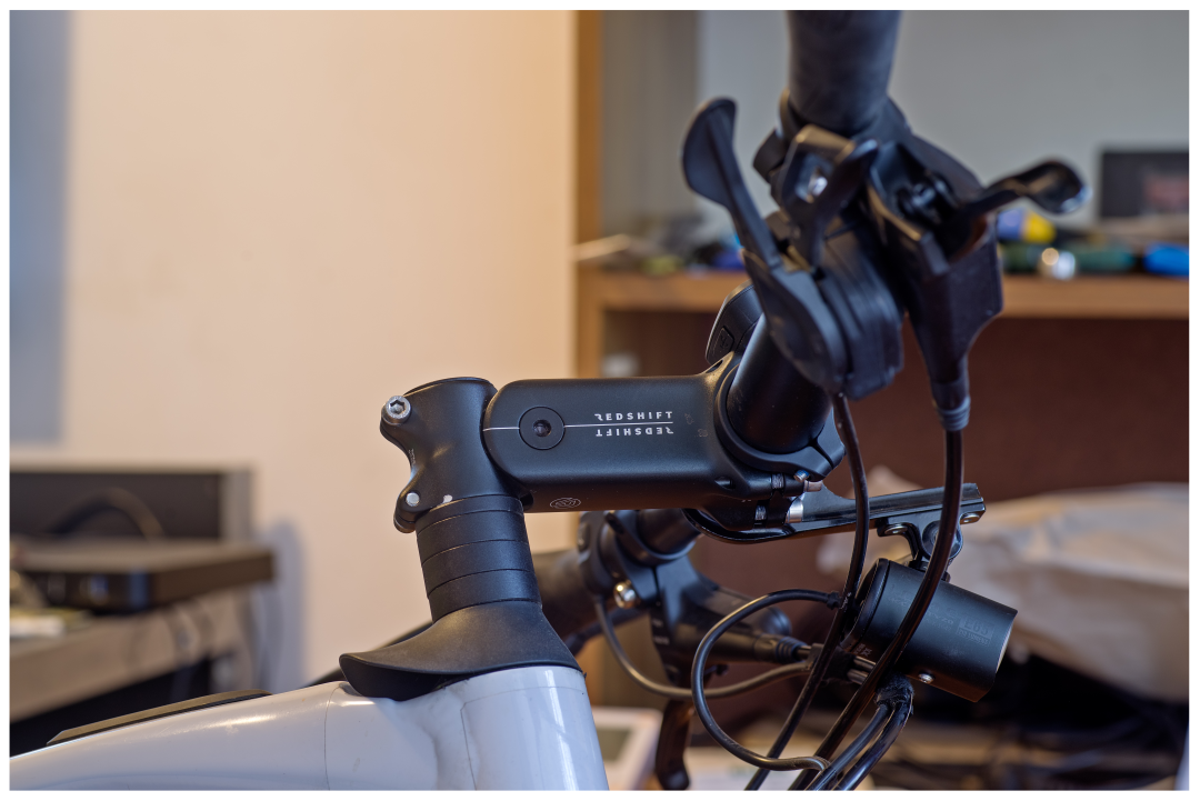

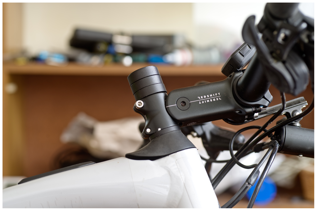

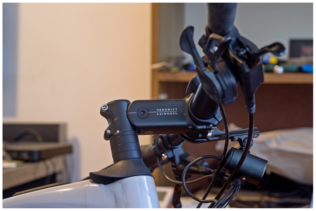

The first step in the right direction:
Redshift stem flipped, elastomer moved to the correct chamber inside the stem.

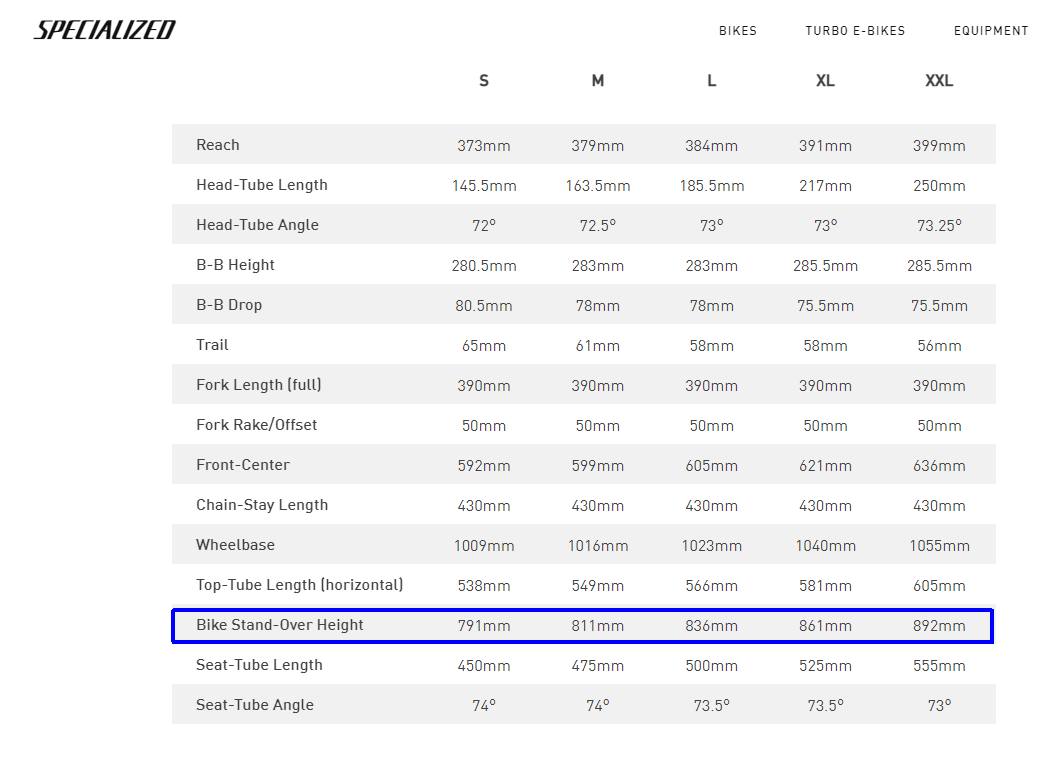

One could asked why I didn't buy a Creo (Alu). The answer is very simple: the top tube in Creo (even in size S) is crazily tall! Who has invented a road bike with the minimum standover height of 791 mm?! There are many people who are far shorter than I am...

Kahn: What is your own "standover height"? Mine is 780 mm. With the 811 mm Standover Height of Creo size M, I would lose my private parts on the first ride! Why in the earth Spesh thinks all people have long legs?!
I don't see "stand over height" specifically listed in the spec but I might not be reading correctly. I do clear it with some spare room on the medium.
Have you seen those lithe Californians, both men and women. Long legs, no bellies, perfect specimens or Specialized-mens!
