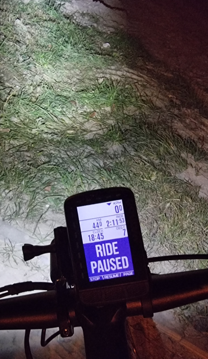

Guys,
The Lezyne StVZO headlight as delivered with Vado SL simply rocks!
I was on my first long night ride with the Vado SL since I have bought it. Long kilometres spent on a smooth service road allowed me setting the angle (both vertical and lateral) with the GoPro mount I'm using. There was nothing I wouldn't see on the road at a distance of at least 25 metres! And the beam top cut-off made the approaching drivers happy.
At that short stop, I also assessed the visibility of the tail-light: just perfect. I felt so safe during long hours of pedalling in the darkness, with the subtle motor whirr, so I didn't feel alone...
See the temperature read-out: 7 C or 45 F. The Wahoo ELEMNT Roam has been eventually calibrated against GPS for Wheel Circumference for Schwalbe Smart Sam 37-622: the figure is 2157 mm (as opposed to 2180 specified by Specialized). 100% match with Strava! (In the Correct Distance mode, the distance ridden according to the map was virtually the same as given by Wahoo. And Wahoo gets the distance from the e-bike's rear wheel RPM and specified WhC).
