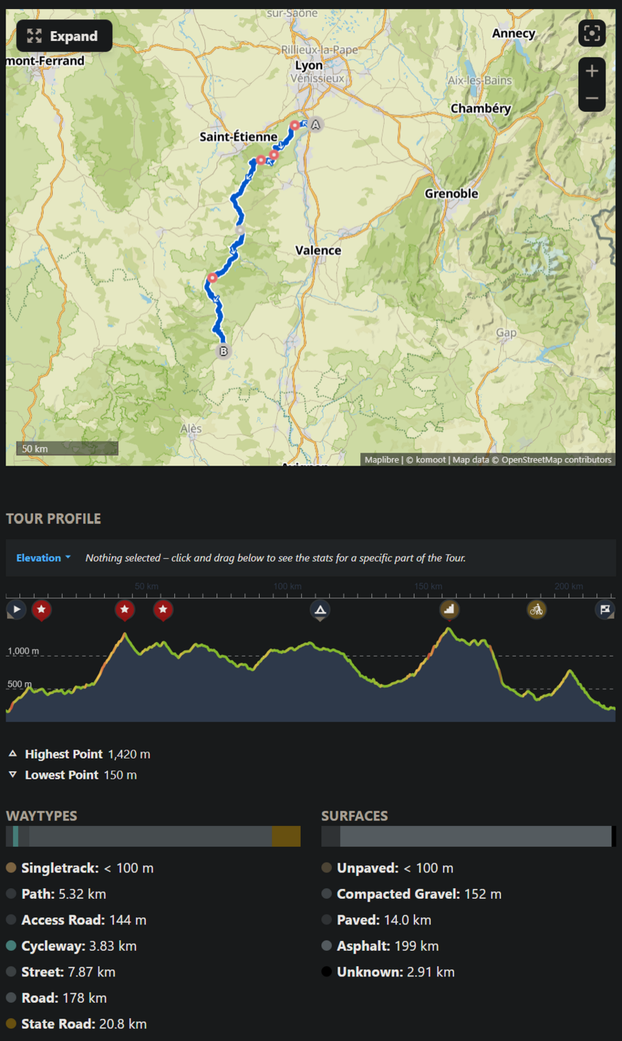

That's what my first real adventure looks like :) And I'm all prepped up thanks to this forum, so a big thanks to all the people who shared their knowledge and took the time to answer my maaaany questions. It's really awesome to count on such a dedicated and helpful community.

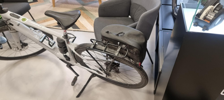

Do not overload your rear rack! The 15 kg limit is true. Unfortunately, I used to overload the rack with panniers, and also experienced several crashes with at least one pannier on the rack. As the outcome, the rack got bent beyond any repair. As the rack is integrated with the rear mudguard (a.k.a. fender), I had to replace the rack with a new one, ordered from the Specialized LBS (it cost around US$100).
The replacement is very easy. Three screws and a single bolt plus a provided spacer will do.

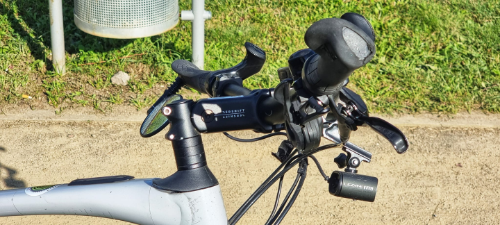

Now, I started thinking whether I did not overdo my mods for Vado SL that put me in a very aggressive forward riding position? I have given it a test by raising the stem from the most bottom to the top position on the steering tube:
Outcome:
  • Worse aero
  • Immediate pain in the butt
  • Far better e-bike handling and steering.
Then I moved the stem to the intermediate position, with the narrow and a wide spacer below it. Let us see how it has worked out! Of the two options, I prefer no butt ache to better steering of my Vado SL!

Very interesting. Following your lead, I’ve been using Innerbarends which are great and found my posture was more aggressive. This has caused some hand numbness. That required some ongoing saddle position adjustment to bring me a bit closed to the handlebar so I’m not putting too much weight on my hands. (About a centimeter.)
Getting this right became more of a challenge because my saddle tilt adjustment kept slipping. I finally had to remove and remount the saddle using a level to get the position right. I think it’s working but now I’m having gear slipping issues so ride position adjustment finalization have to wait until my LBS can figure out the drive chain problem. It’s always something, I guess.
Back to your lesson. The more aggressive position due to the Innerbarends has been tempting me to reconsider a drop bar bike. When I restarted riding a few years ago I was reluctant to even consider drops as they weren’t really available to me when I’d stopped riding as a teenager in 1964, so I’d had no youthful experience. As an oldie they seemed intimidating. I guess I’m lucky (?) that current extraordinary medical expenses make seriously considering another bike unlikely.

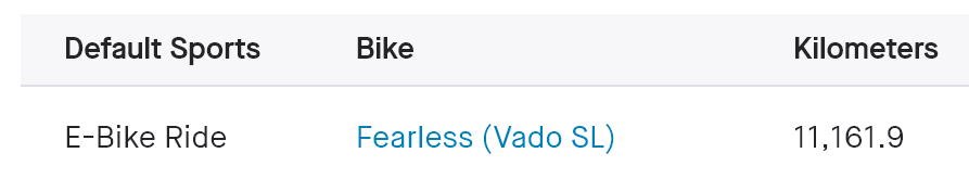

I do not complain :) Never have asked the dealer for help during the first two year warranty term. Updated the firmware only post-warranty.
It does not include other people who rode my Vado SL for a couple of hundred kilometres more.
