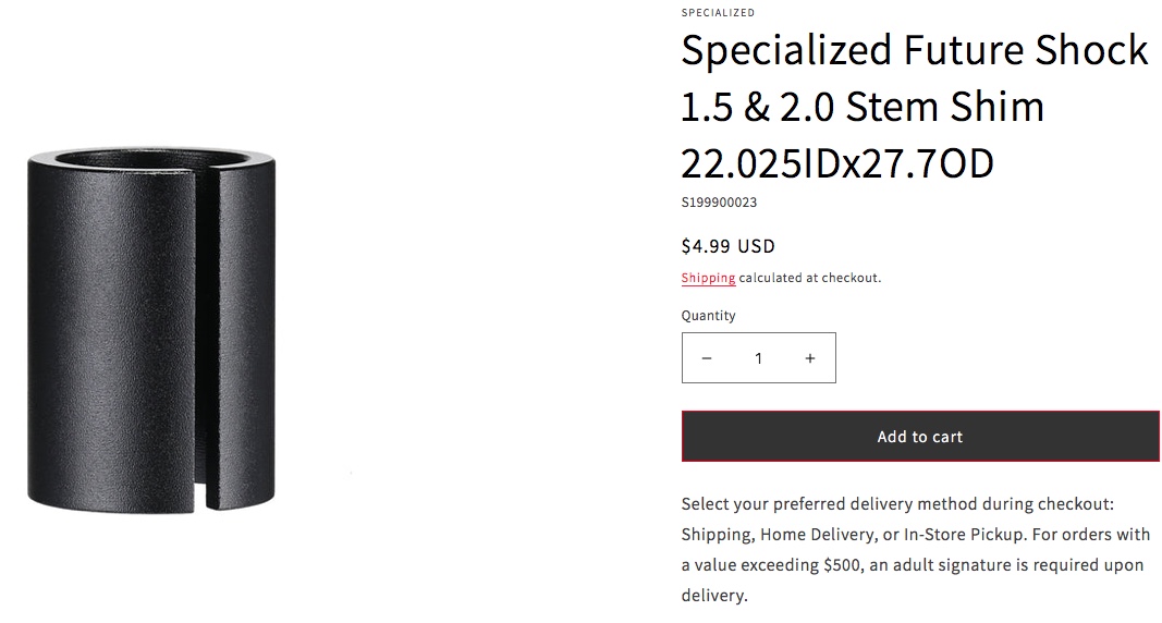

FutureShock requires Specialized stems made for the FutureShock. I do not think you can install any shorter stem on Vado SL 5.0 . . .
You can also use a shim adaptor to mount easy-to-find standard stems in various lengths/rises for 1 1/8" steerer tubes:

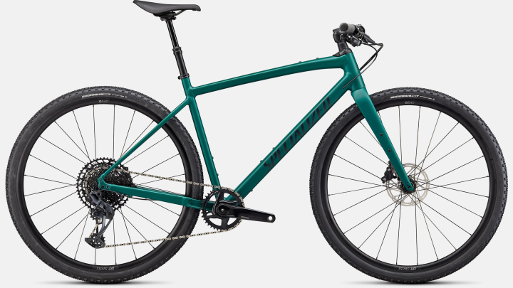

Did you notice Specialized missed a "flat handlebars gravel e-bike" from its offer? I mean an e-bike similar to the Diverge EVO, an analog flat handlebars gravel bike.

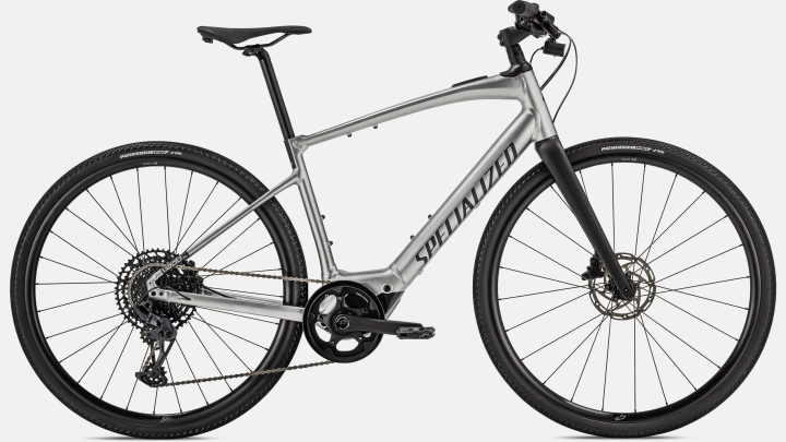

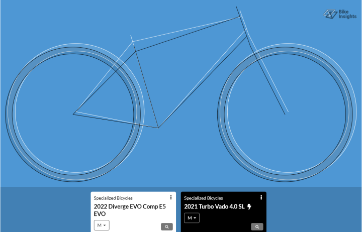

Well... I'd say the Vado SL 5.0 unequipped would check almost all the boxes for the e-bike type.
Yes, the geometry is not exactly the same but...
Analysis: https://bikeinsights.com/compare?geometries=61ad29ce67906f001c4ee263,5ef53633e56c790017f2aea5
What do you think?

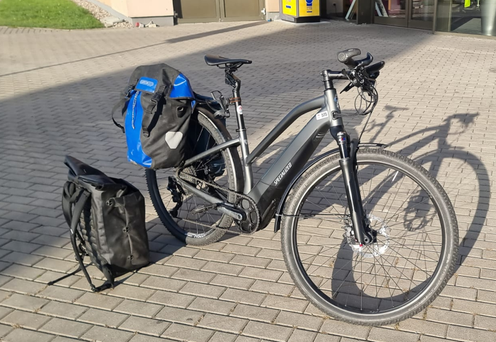

I had not realized that a 'dropper' post differs from a suspension post. I need to better understand this difference and will look into it. Thank you!
I will also look (again) at that Ortlieb Quick Rack, however, it seemed to me a less than elegant solution for a rear rack. I am a bit picky about 'things' and didn't love the connection(s) and construction of that rack. I don't want to have a rear rack that rattles and drives me crazy all the time.
I've not seen the Ortlieb in person, just noticed it as an interesting option. Too bad that it doesn't seem to be as good as it might appear.
