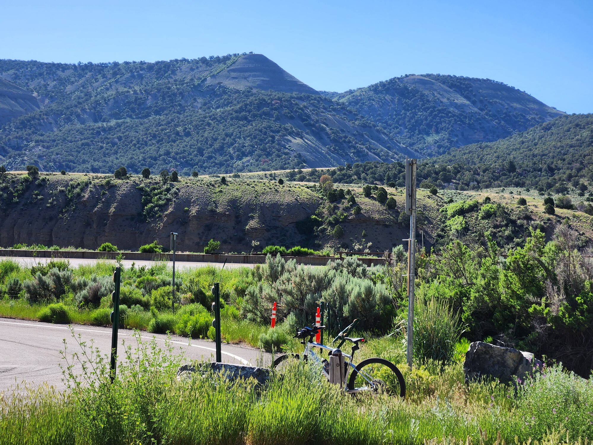

More plush ride than the Pathfinder sport. Felt nice. More hold on the gravel. Didn't notice any more rolling resistance. No issues.

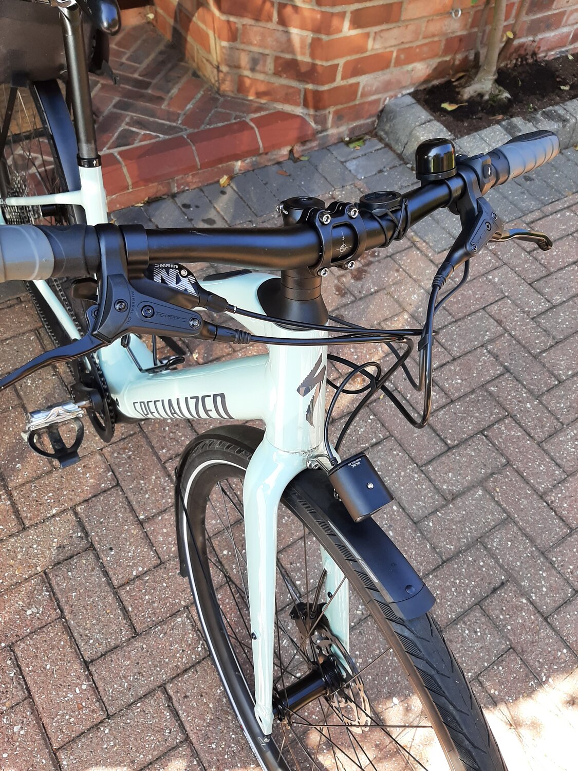

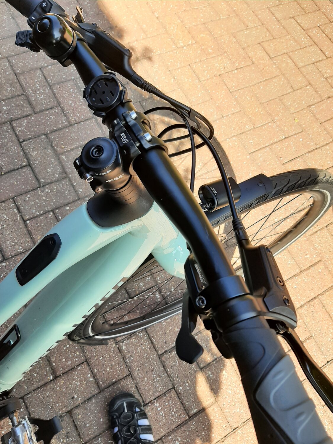

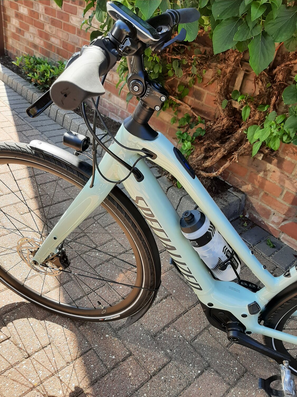

Finally got my wife‘s Turbo Vado SL4.0 set up comfortable for her to ride. With her back problems the reach was to great and handlebars to wide. LBS reduced width of handlebars from 27inches to 24, and added riser stem but that didn’t do it, so we removed riser stem and replaced it with a 35mm, short stem - success! She’s now really happy on the bike. Light now installed lower down on metal bracket. There was no need to change any wires or brake/gear cables.

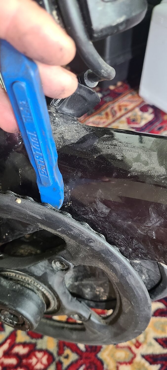

Can you explain a bit more about how you got the chain ring to flex? Did you use more than one lever, and what brand/type of lever was it? Having spent 20 minutes getting a stuck chain ring out this would be useful information.

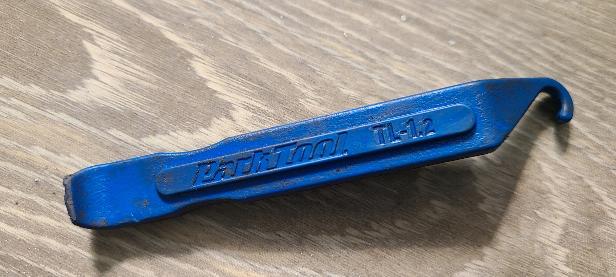

Hey MJ
It's just a typical tire removal tool. I think any brand with a bit of an angle would work but in this case it's a Park lever. And - obviously my chain is back on so it's a bit difficult to show you exactly how I got the chain out but just put the lever between frame and ring and apply pressure and it will move mm or two. And that's about all you need to pull chain out. Sorry about the dirt - bike is typically clean but no time lately.
