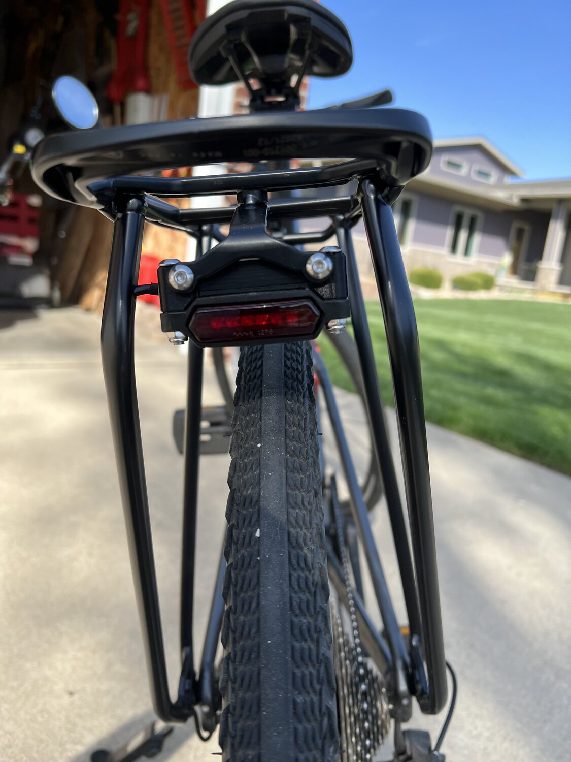

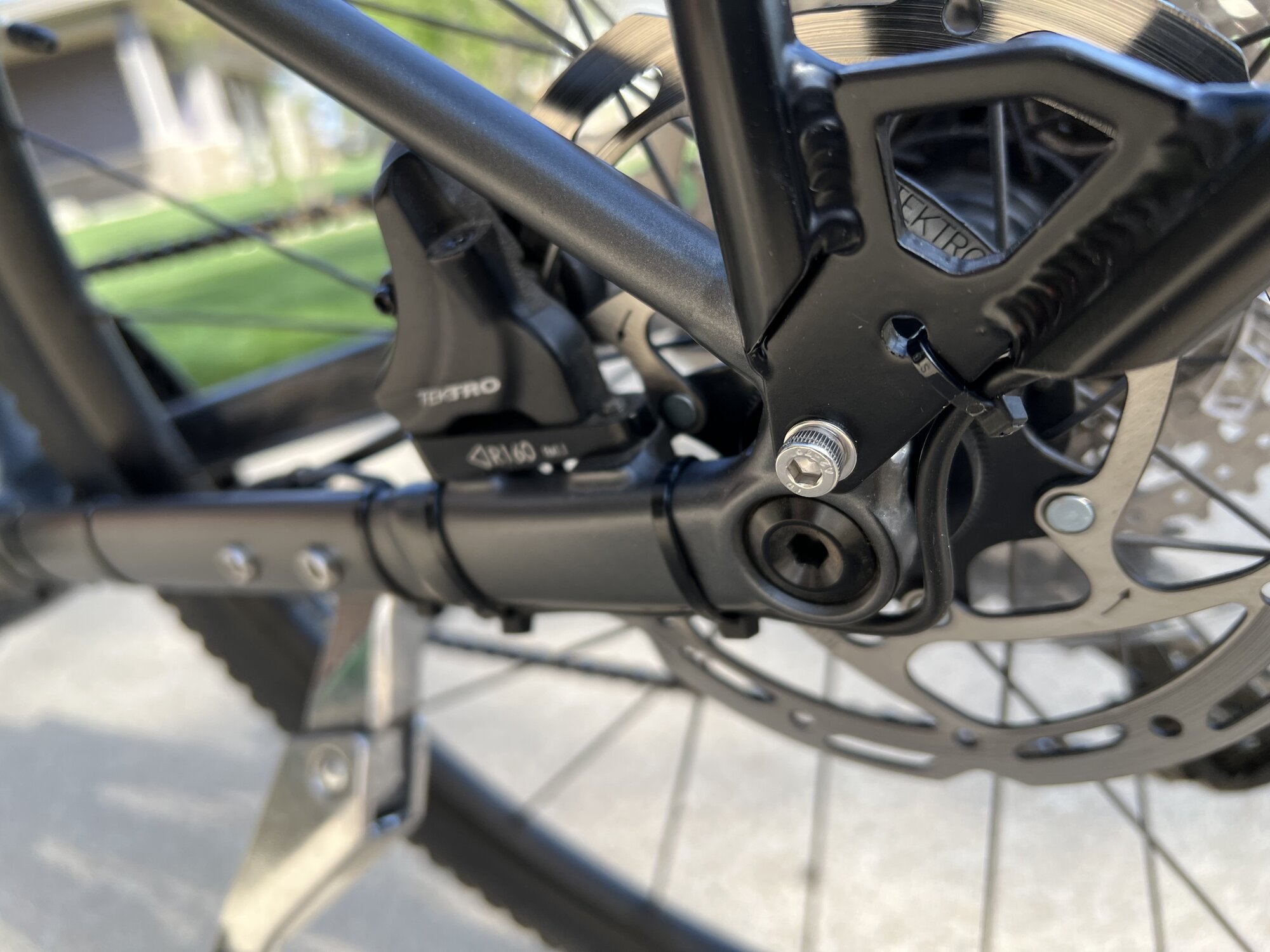

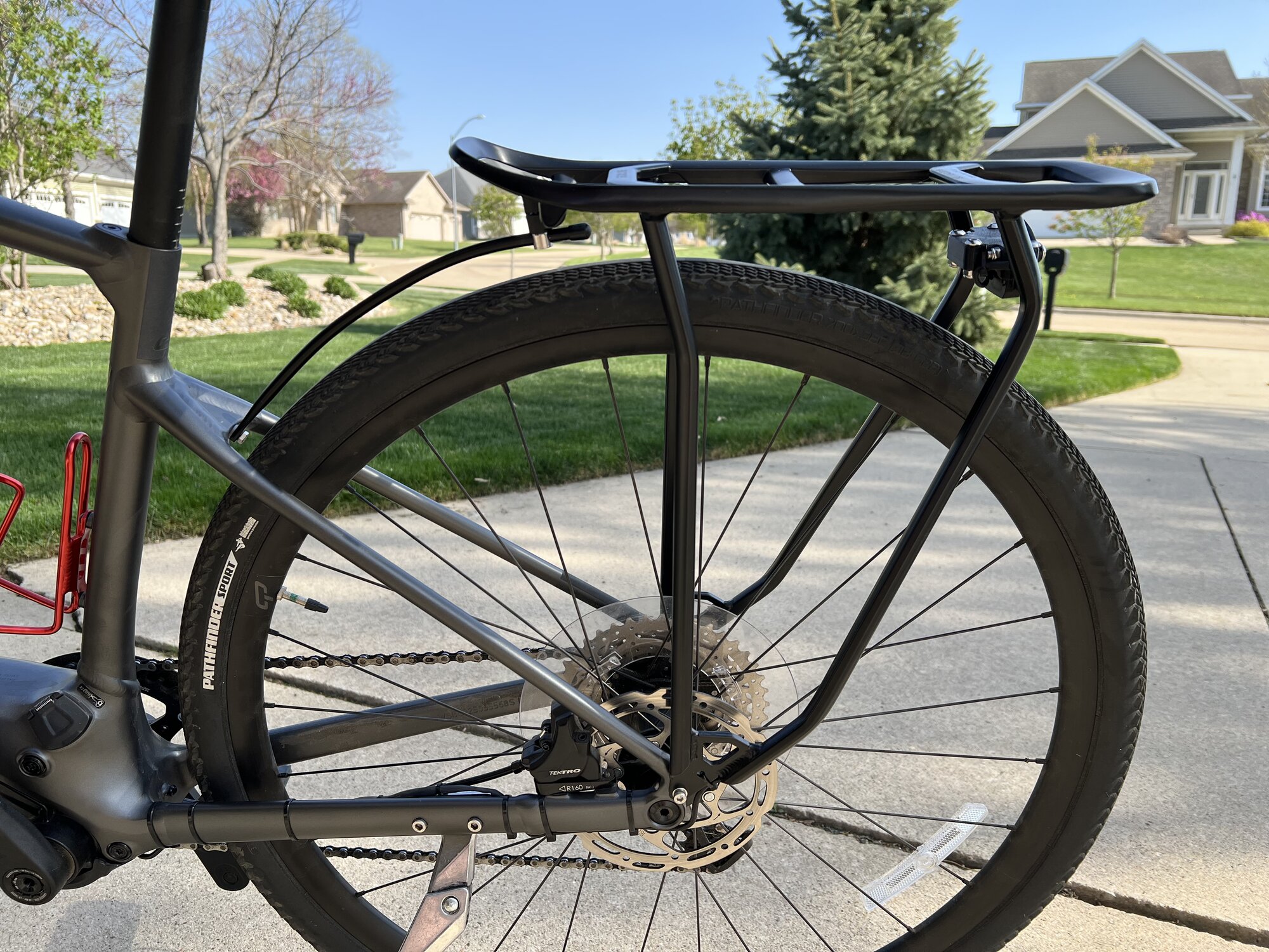

I now have my rear rack and relocated light project complete. I selected the RackTime Standit 2.0 rear rack. I bent the front attaching rod to generally match the tire outside radius and fastened it to the rear fender attachment threaded hole.
i moved the rear light from the seat to the bracket on the rear rack. It was fairly easy. The steps are:
Remove seat post from frame
Disconnect the two light wire connectors and then remove the light from the bottom of the seat.
Remove the lower motor plastic cover and from there pull the light wire from the frame seat post opening down and out the bottom of the frame.
I filed a small half circle opening in the plastic cover on the left rear side for a place to allow the wire to exit.
I designed and 3d printed an adapter that holds the light and attaches to the rear rack light bracket.
The Standit rack came with a hole in the left rear tube to allow the light wire to be routed down to the area near the rear axle.
I placed a fairly long piece of shrink tubing over the wire, reconnected the light wires to the relocated wire, pulled the shrink tubing over the connection portion and heated it to lock it in place.
I pushed the excess wire back inside the bike frame and zip tie the wire in place along the frame.
I really like this setup better than the light on the seat.

I now have my rear rack and relocated light project complete. I selected the RackTime Standit 2.0 rear rack. I bent the front attaching rod to generally match the tire outside radius and fastened it to the rear fender attachment threaded hole.View attachment 153222
I designed and 3d printed an adapter that holds the light and attaches to the rear rack light bracket.View attachment 153223The Standit rack came with a hole in the left rear tube to allow the light wire to be routed down to the area near the rear axle.
RackTime has a few rear bag choices for the 2.0 rack. My wife picked the Yoshi 2.0 bag. I attached a 2.0 bracket to my very old rear bag.
great job looks good

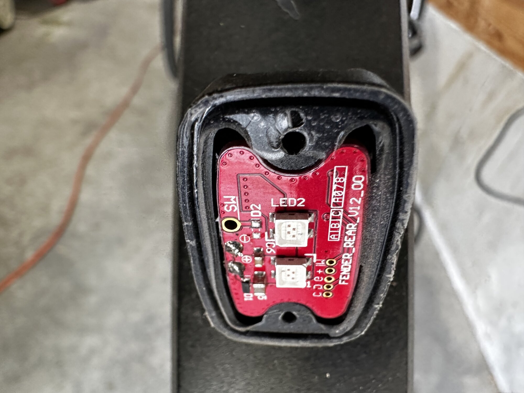

For those with a Vado SL EQ with a rear fender light-Occasionally check to make sure the red lens cover is securely fastened. After a bumpy ride, my rear fender light looked like this. The light was still functional though. I checked with the LBS and they said the only solution was to replace the entire light at a cost of about $30.
I contacted the OEM (Lezyne) via their website and asked if I could buy a replacement lens cover. Lezyne said that the lens cover could not be purchased because of waterproof issues but they would sent me a complete replacement light for free. The OEM version of the light does not have the Specialized power connectors for the cable however. Rather than splice in the new light, I was able to remove the cover using laptop pry tools. The cover was secured to the base with what seemed like a rubber cement. I pressed the new cover onto the old light base firmly and ran a narrow strip of red electrical tape around the perimeter of the lens and base to hold it in place. I'm red in the rear again thanks to Lezyne's customer support team. I also have a spare light and base if the old one fails.

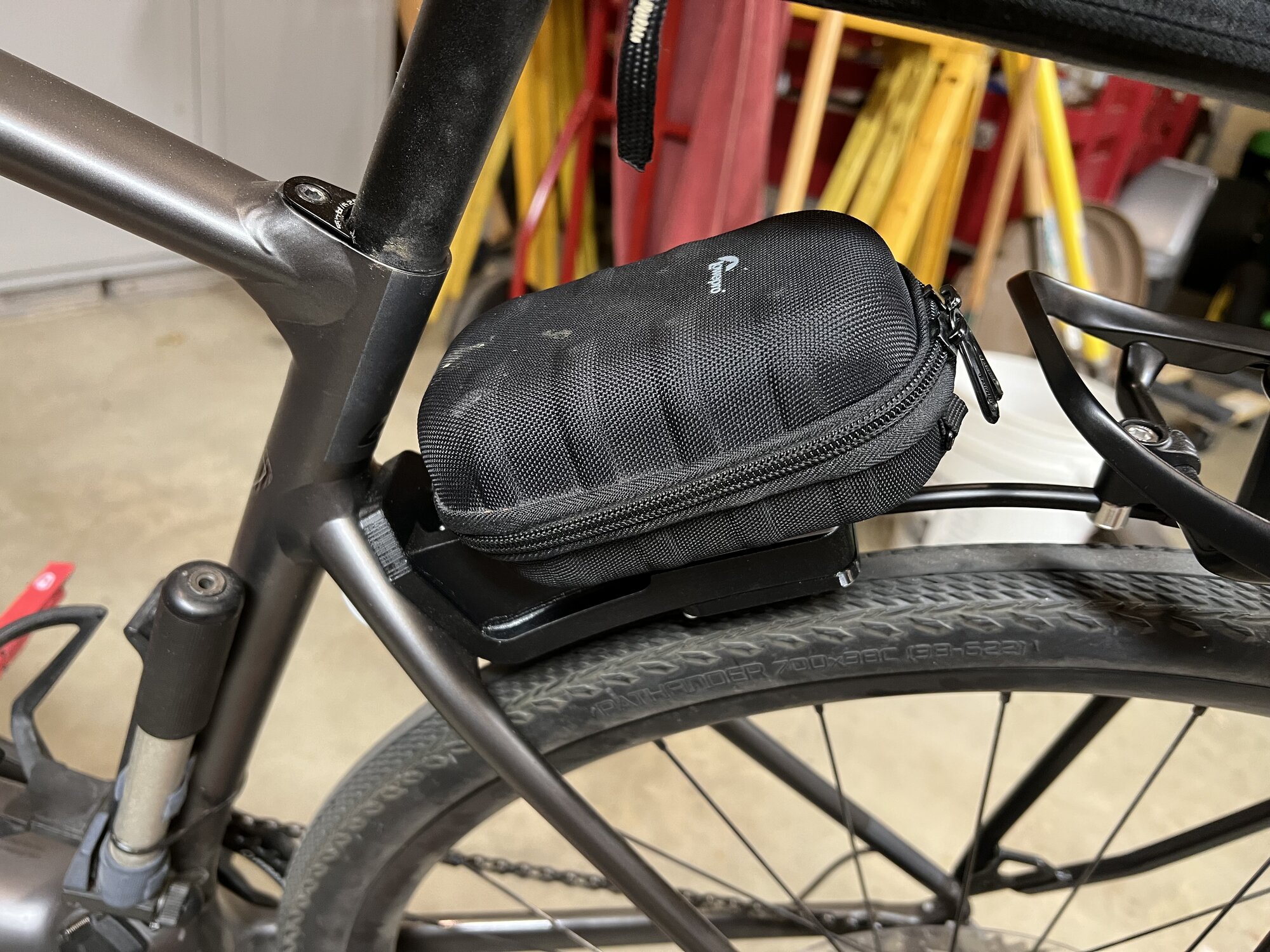

The next step in setting our bikes up as we want is to get my 20+ year old bike tool case installed. It’s a Lowepro small camera case that’s just the right size to hold my Alien multi-tool, tire removal tools, patch kit, etc. I designed and 3D printed a bracket that attaches to the frame and is supported by the rear rack attachment rod.
Is it very dry where you ride? Because that would just get caked with mud where I am!
my rear light fell off not long after i got the bike. it was an expensive repair due to the labor cost of re-routing the wire though the down tube where the battery is. i have reinforced the plastic red cover with clear tape... if i lose it again, i will buy the replacement light and do a super glue fix.. the red lens cover should not come off!!

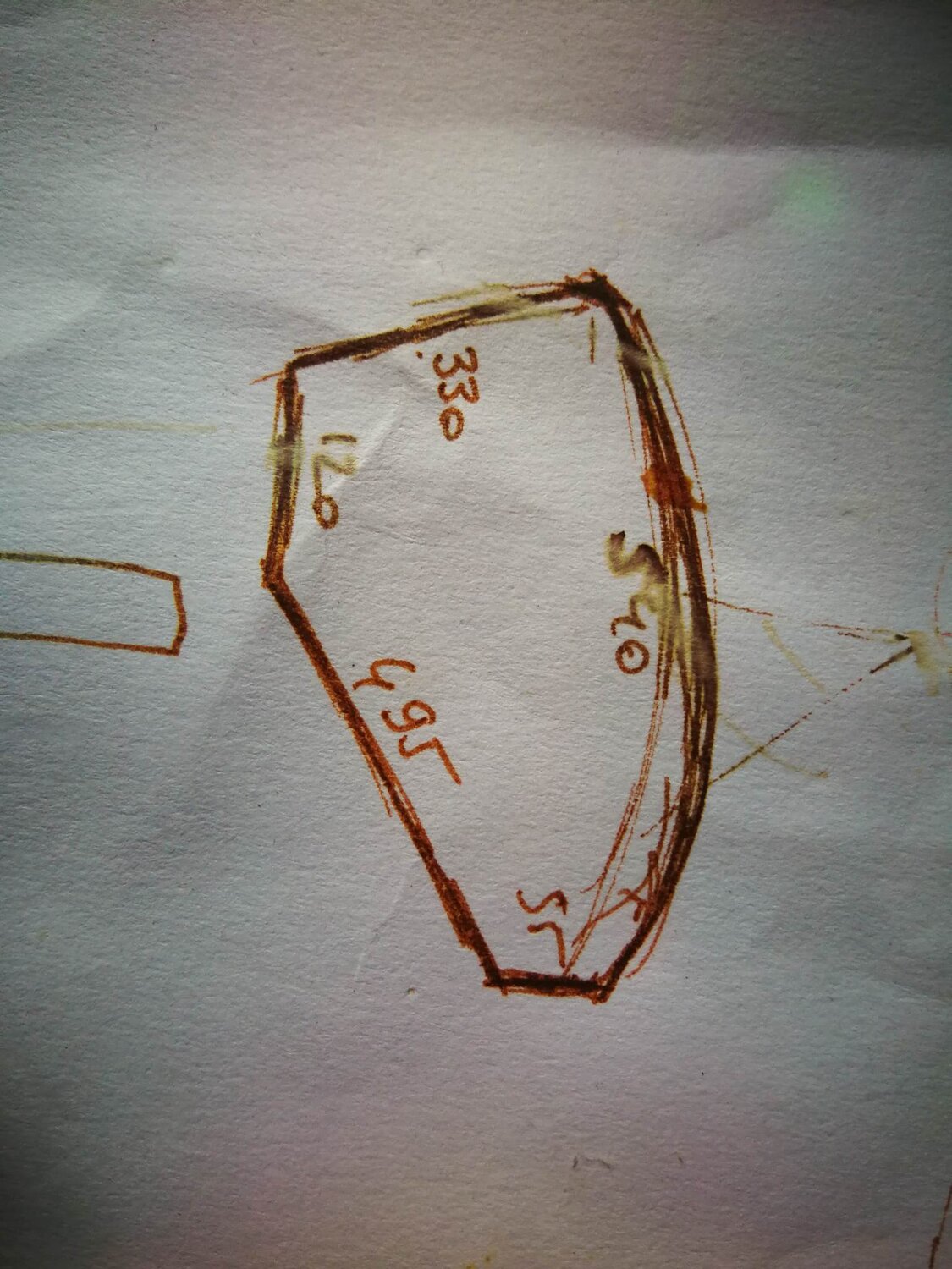

Because I usually can't trust myself, I'd like to make sure I got this right. I'm planning on getting a full frame bag for bikepacking and was kinda interested in the apidura one. With the shown figures in here (https://www.apidura.com/shop/expedition-full-frame-pack/) it seems the 12L one would be the best fit. But I wondered if anyone was familiar with those bags and if there was any chance that the 14L could work in some way. Two more liters for just 30 more grams sounds awesome. Thanks in advance for your insight!
Hiya, if you have a Vado SL it’ll depend on the frame size as there’s not a lot of space in the triangle. Especially on smaller sizes. Pretty cramped even in my medium. Plus remember the down tube is very wide with battery inside and the straps might not be long enough to go round. I use a small cut off design of frame bag - it runs under the top tube but still leaves bottle cages there. I doubled up the Velcro straps to go around the down tube. Hope this is helpful.
I do have an SL one, L sized. I find the triangle of the frame quite decent. Yeah, the downtube will require some tweaks for sure.
Could you please share pictures of your setup?
Here are the measures I took with some cardboard. I know the 14L version of the apidura frame bag exceeds them, hence why I wanted to know if anyone was familiar with those and could tell me if it's reasonable or not to get the larger version. I'm sure I can fit it in, but I'm concerned that the eventual folds may damage the bag on the long run. I'm tempted to think that it's still a decent way to grab a couple liters of capacity (even though it's via width) for very little extra weight. But it'll surely look ugly (vs a slick right fitting 12L version) and may affect performances (little extra drag?)

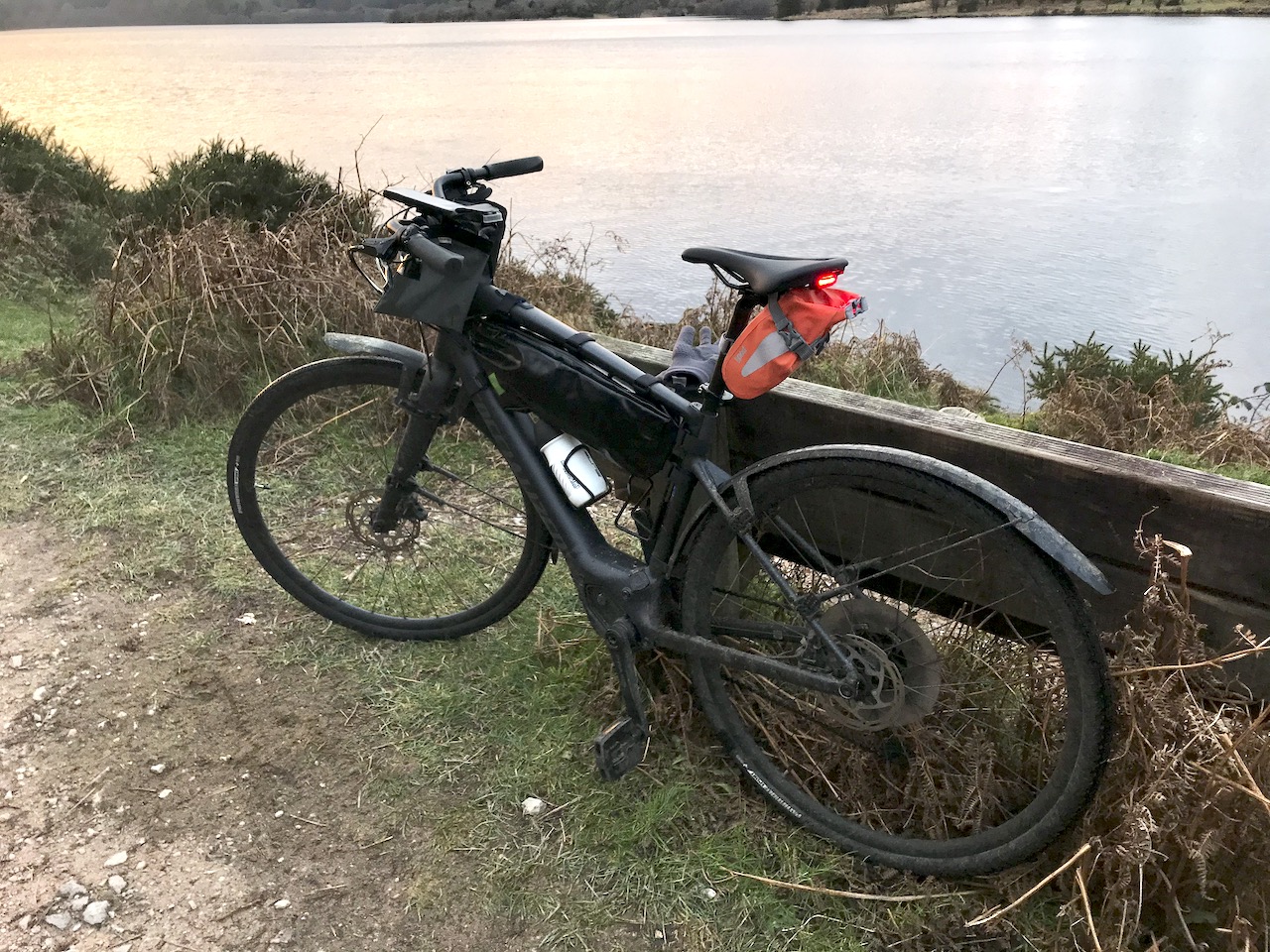

Here's my one, it's a podsacs made by Planet X & here's a link to the online shop so you can see dimensions etc. I deliberately got the half size so I could still have bottles or range extender. But even so it still feels cramped as the top tube curves towards the head tube. But you'll have more space in the front triangle in size L for sure.
