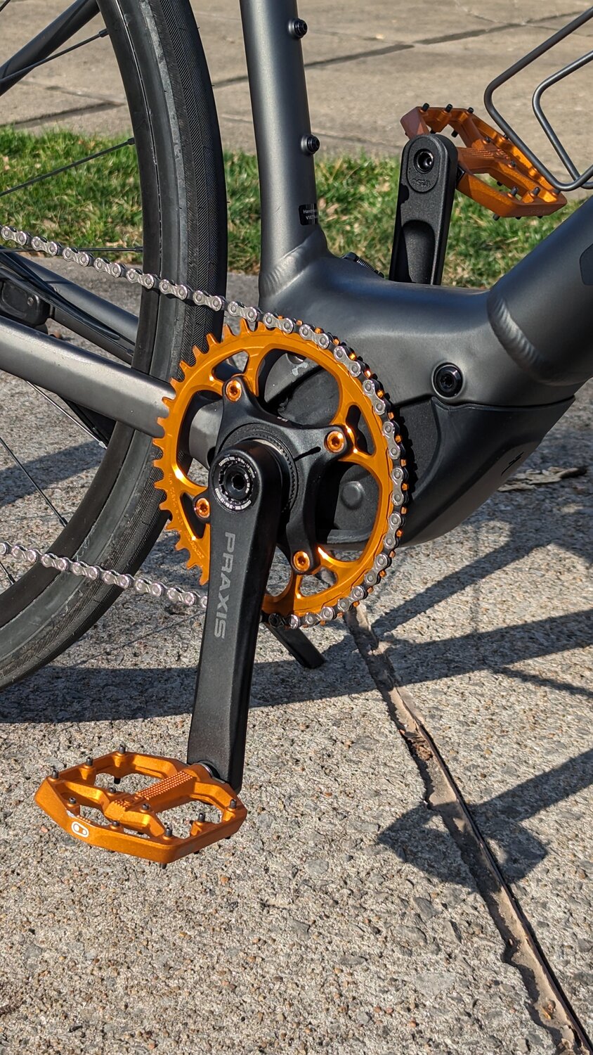

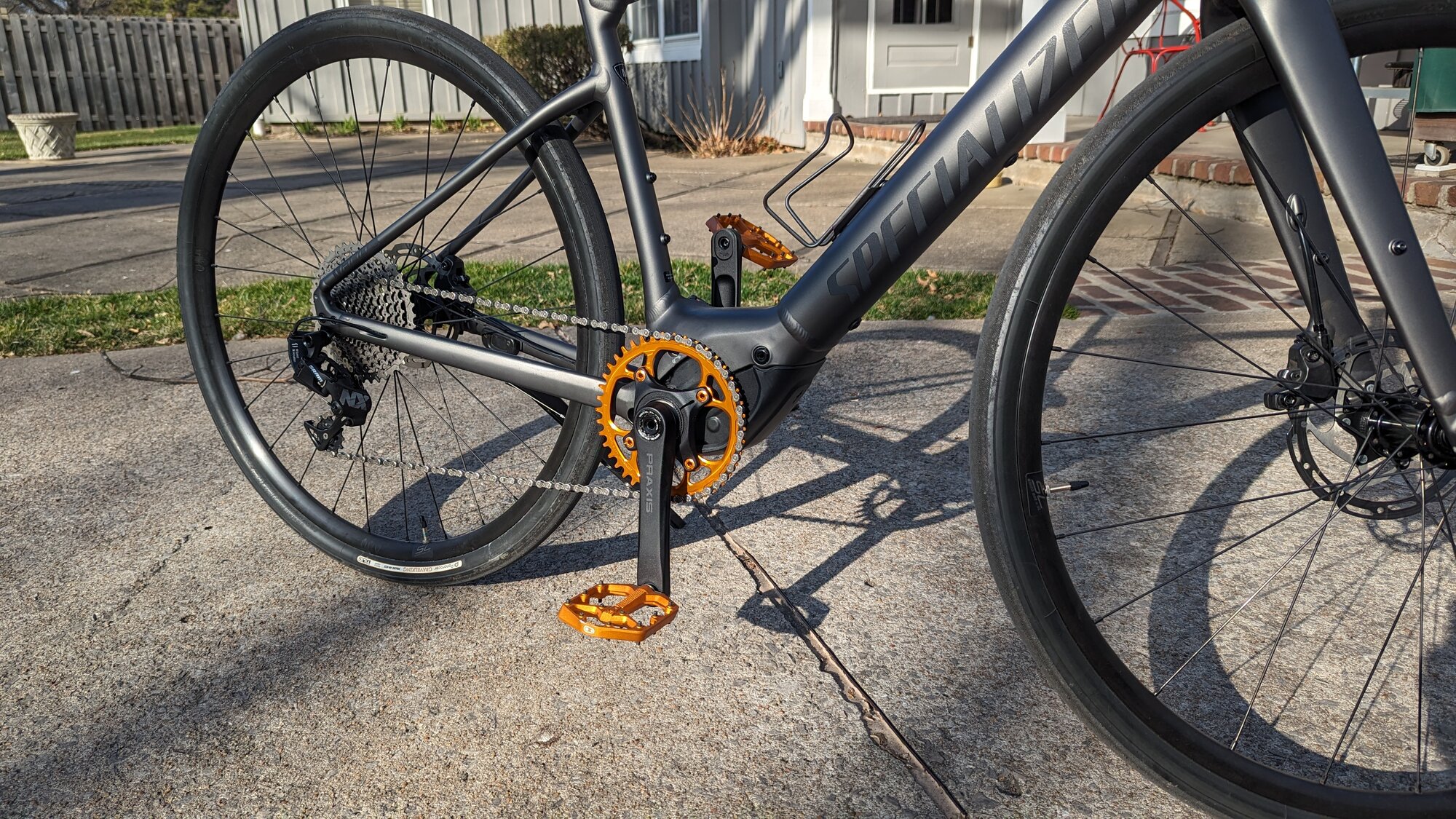

I received the Garbaruk 104 BCD 42T chain-ring today. I ordered it directly from Garbaruk/Poland on 02/20/24 and received it today via DHL on 03/01/2024 in the Midwest USA (10 total days from order to receipt!!).
I installed immediately but I don't have time for a ride today. The ring went on without any issues whatsoever quick/easy and it looks great. The teeth and total build/machining quality are superb and make the OEM Praxis chainring seem almost toy-like. I gave it a quick spin around the block and no issues.
I have heard/read some mixed reactions as to whether this will remedy my chain drop(s)....but I cannot imagine that I will continue to have the chain drop problem with this chainring. The teeth are substantially longer and actually stick out atop the chain and it seems VERY snug. The narrow/wide teeth really seem 'grabby' compared to that 'wave technology' shape on the OEM Praxis. I'll update as time progresses.
Since I was ordering a new ring anyway....and since Garbaruk offers colors.....I just couldn't resist the orange to match the Stamp pedals. Normally I would go with black....but I like this orange accent on this otherwise completely tame matte grey frame.

Graphite or black with orange accents — hard to beat!
Orange is my favorite color, but its reputation has become tarnished in recent years. Thanks for helping us make orange great again!

I rode approximately 40 miles this weekend and did not have any chain drops. Could be placebo effect, however, I feel more confident under load and during shifts while under motor power with this Garbaruk chain ring. I did pass through the route where I CONSISTENTLY (but not always) drop the chain and had no issues.
Again...looking at the chain fitment on the Garbaruk ring....the teeth extend beyond the chain seemingly making it FAR more difficult to lose the chain. Additionally....the chain seems more tightly attached to the ring teeth when compared to the OEM Praxis.
So far so good.
I did realize: Should the Garbaruk drop the chain and should that chain lodge between the motor and the inside of the chain ring as has been occurring with the Praxis....it would require a slightly more difficult surgery to re-attach the chain. The OEM Praxis required only a 5mm allen key to remove the chainring enabling the chain to be reattached. The Praxis uses the chain ring guard and bolts (without nuts) which attach to the Praxis chainring which features threaded holes. The Garbaruk holes are not threaded....so the 5mm bolt attaches to a 7mm nut (more standard chain ring hardware). In other words....should I have the same problem with the Garbaruk....it would be a major P in the A to reattach while out on a ride.
