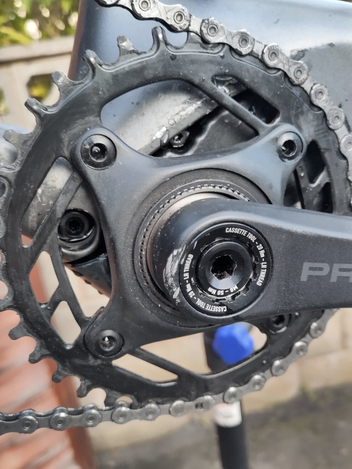

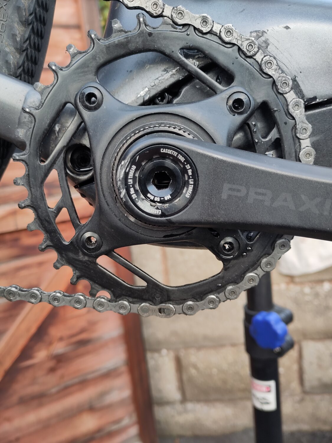

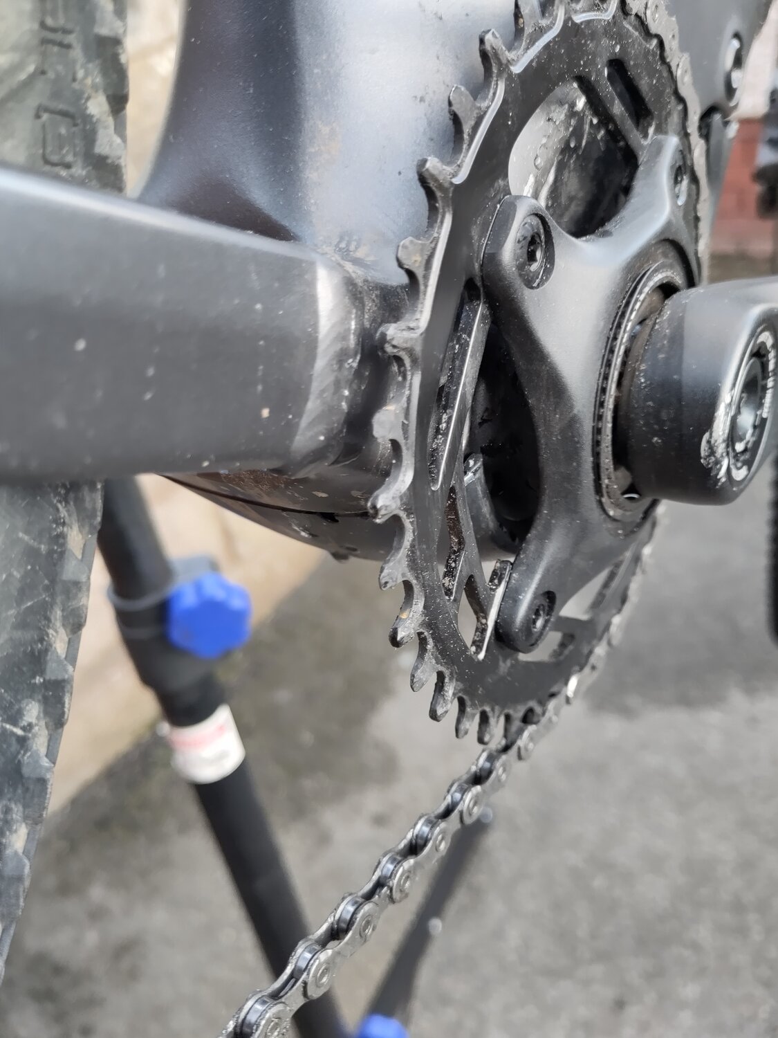

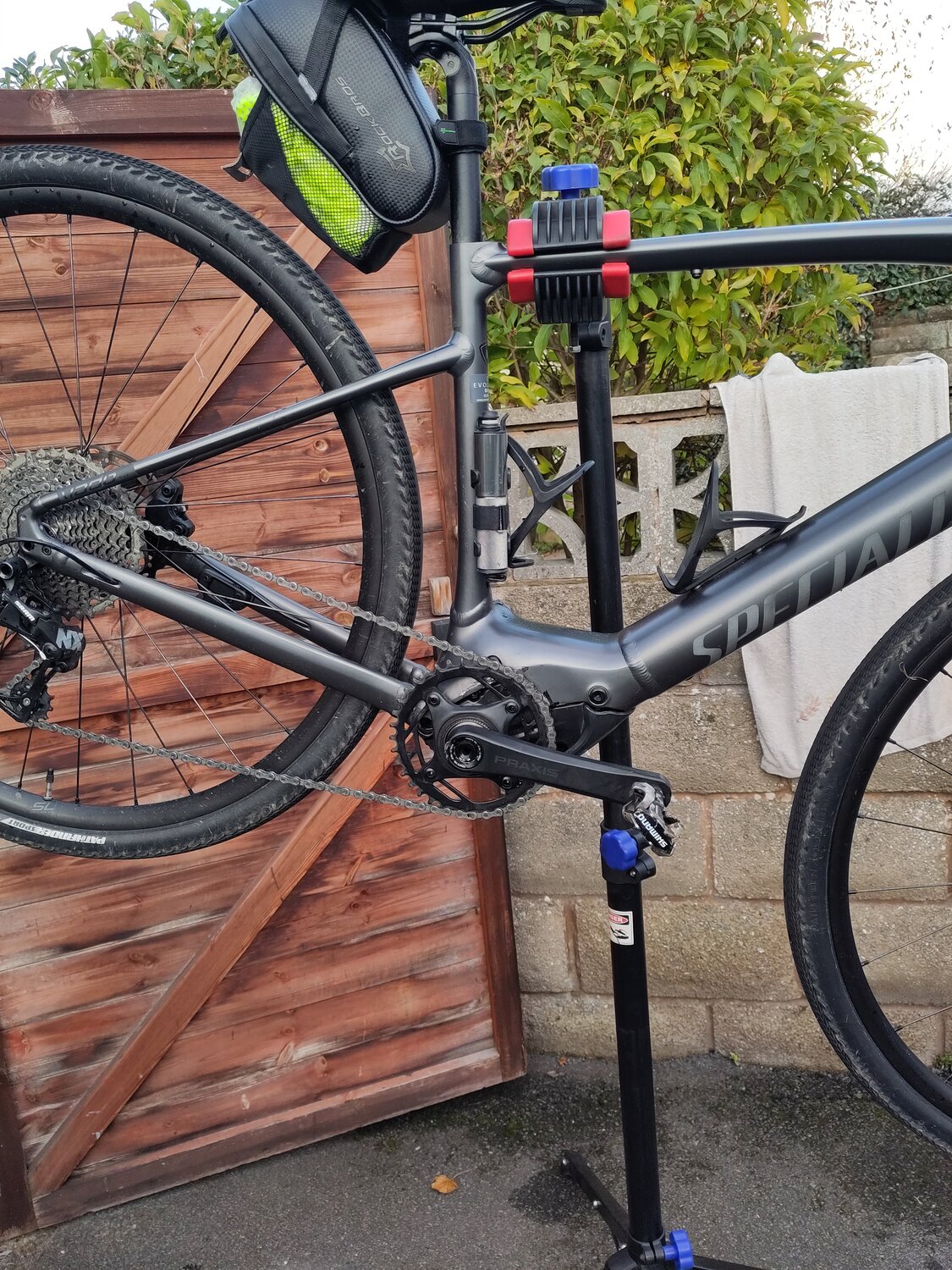

Pete...will you snap a photo of your chainring and crank for me?
Hope these are okay. This is a Trek wide/narrow 38t

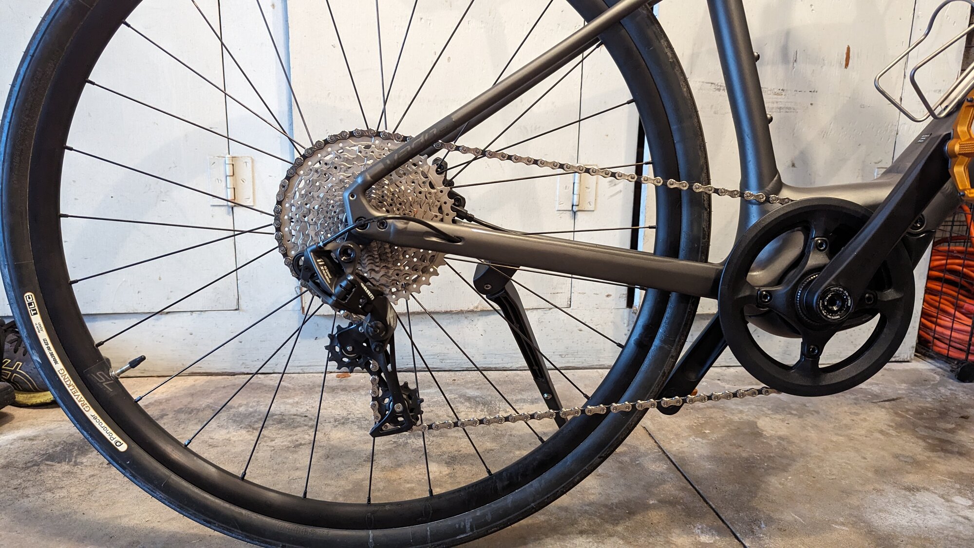

@mfgrep: Did I ever ask you for the number of links in your chain? Or, what is the derailleur cage o'clock position when the chain is on the largest cassette sprocket?
Just wondering...
Hey @Stefan Mikes . My chain has 60 links. I took a photo of the derailleur cage position when the chain is on the largest sprocket.
It is 120 links then :) Your derailleur cage is too upright. I have a feeling your chain might have been too long. I think your chain should be 118 links long. The proper derailleur position in the lowest gear is 5 o'clock.
Not that your chain is dramatically too long but I think the chain tension could be made higher in your case, and too loose a chain is one of the contributing factors leading to the chain drop from the chainring. (Yes, I do understand it is the stock chain).
Just a remark :)
