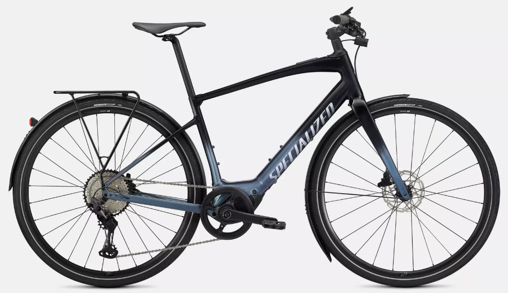

If I were buying a Vado SL at the right time, I would go for the 5.0 in this colour...
The picture does not show the beauty of that bluish 2021 model...

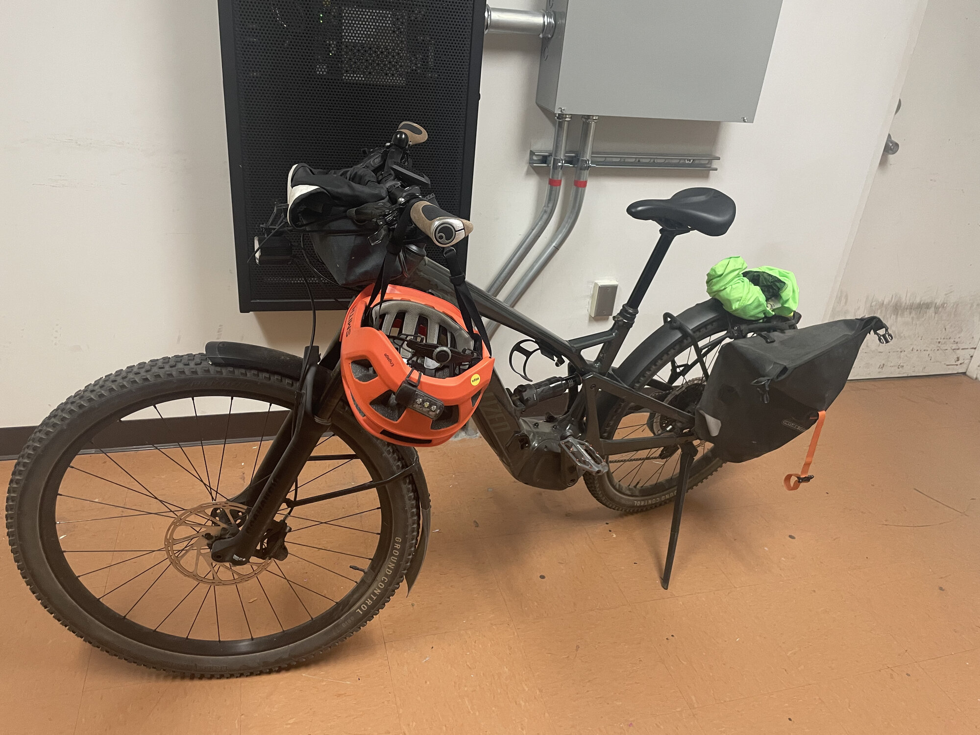

As for comfort, I cut 1" off each side of bars and added Ergon grips. I usually run about 35 psi in tires, and adjust suspension to soft for off road and hard for commute. The only downside for me is some of the parts are cheap, like the bell and light mount, both of which broke. I'm kind of glad the light mount broke, so now I can run my bar bag, but the light zip tied to cables is pretty cheesy. You'll want to put some loctite on the kickstand too. Aside from that, I'm doing about 300 miles a month and the bike has been solid, so far just a chain and a back tire have been changed out. Good luck!
