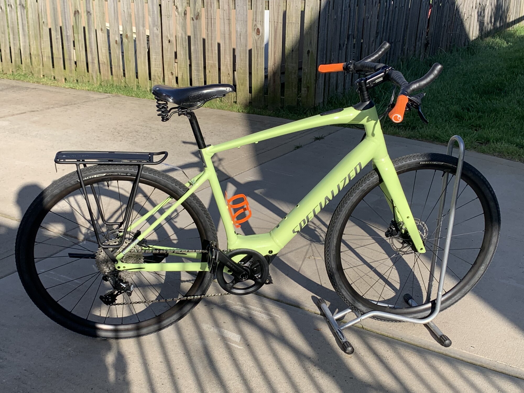

Recently acquired a Creo SL Comp Carbon and its a blast! I also got a 650b x 47 gravel Wheelset for off-road use. Any recommendations for frame protective film that will fit the bike, especially for the downtube?

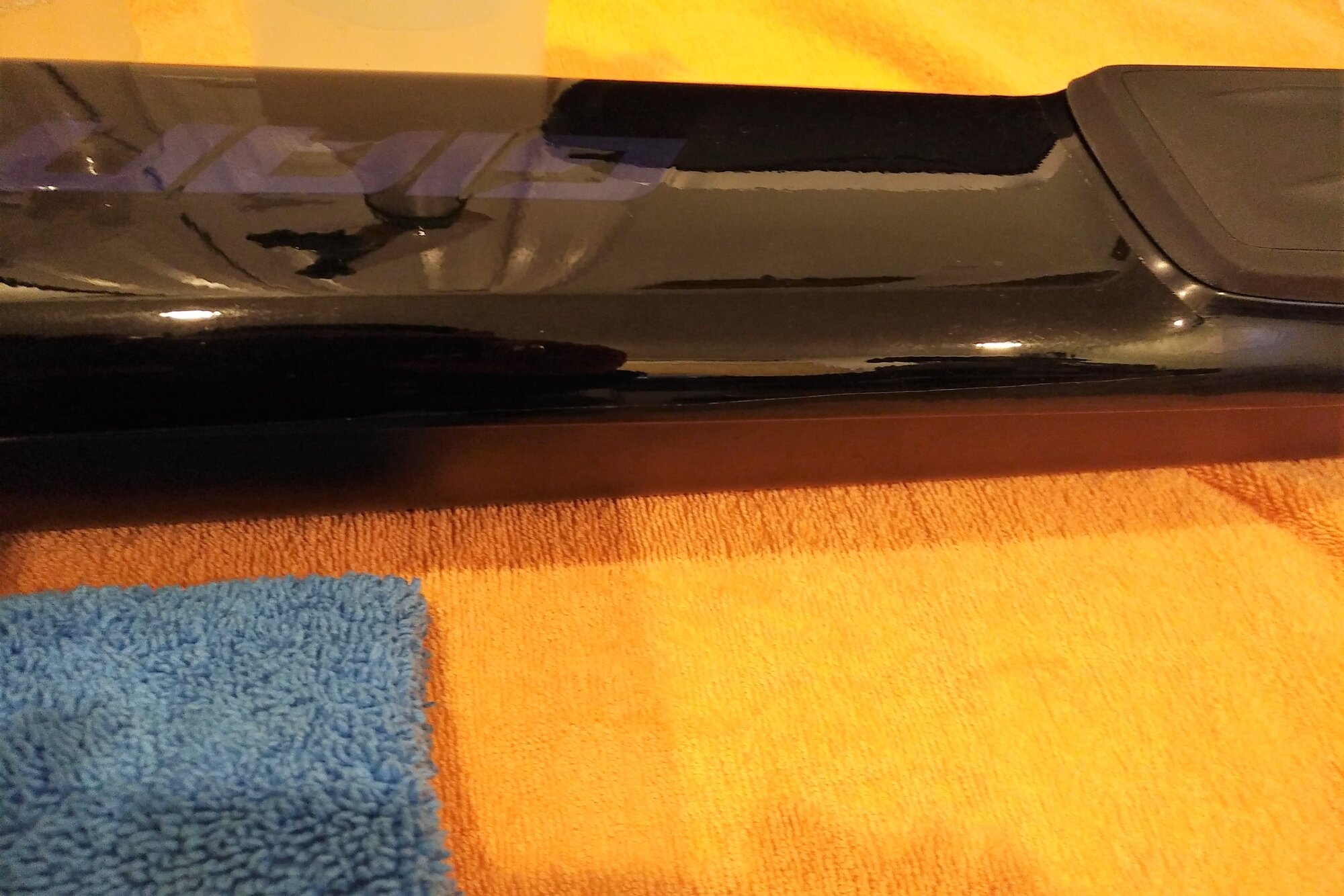

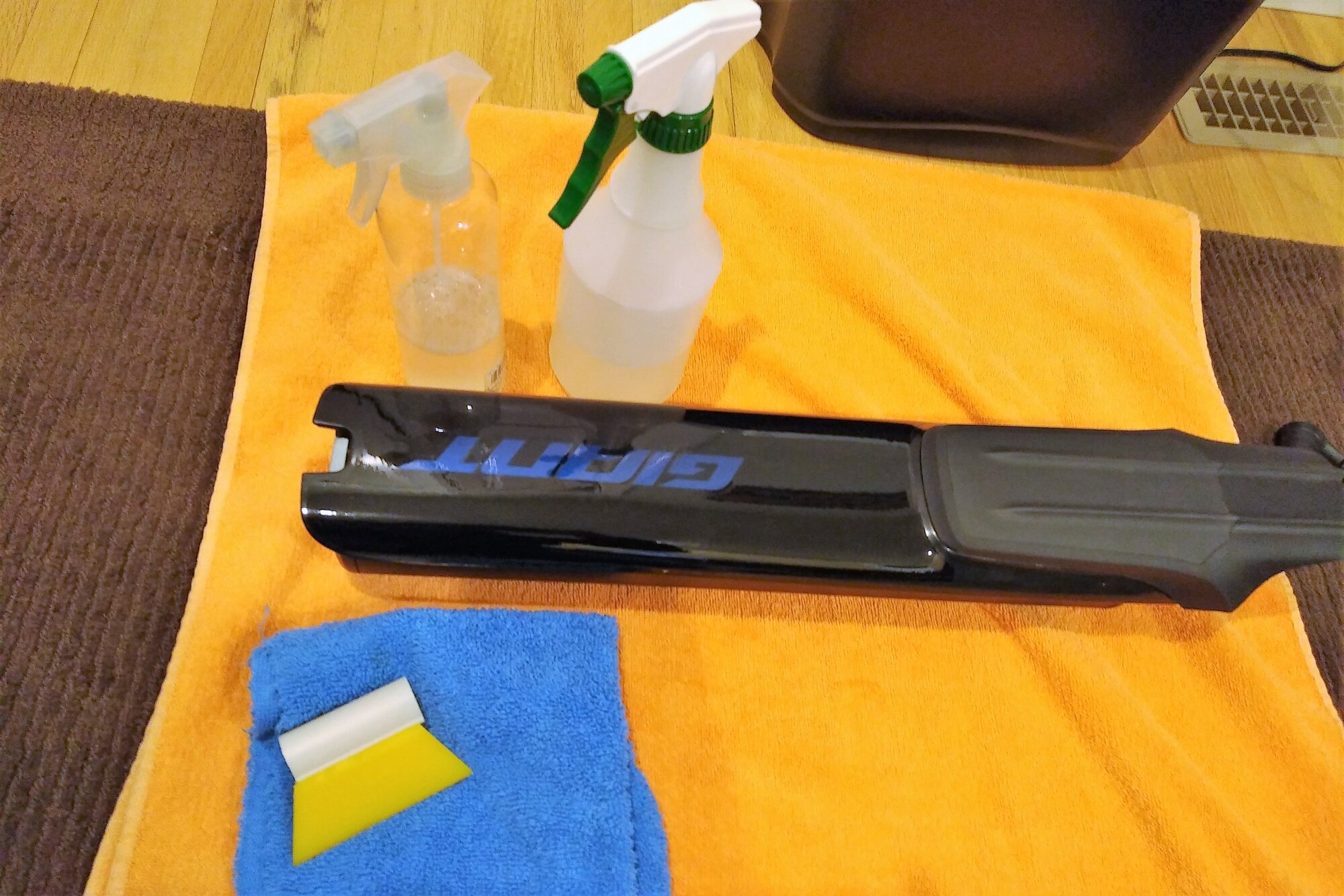

I did almost my entire Creo in this stuff. It does take a bit of practice and patience. Narrow strips with the ends cut into curves work better and easier than wide strips. The wider the strips the more likely you will run into compound curves of the tubes which causes wrinkles in the tape. If you apply correctly you still may get some small air bubbles under the tape. Most of those can be removed by popping with a pin. For instance on my top tube there is a wider strip covering the top and a narrower strip covering each side and slightly underneath. The tape:
