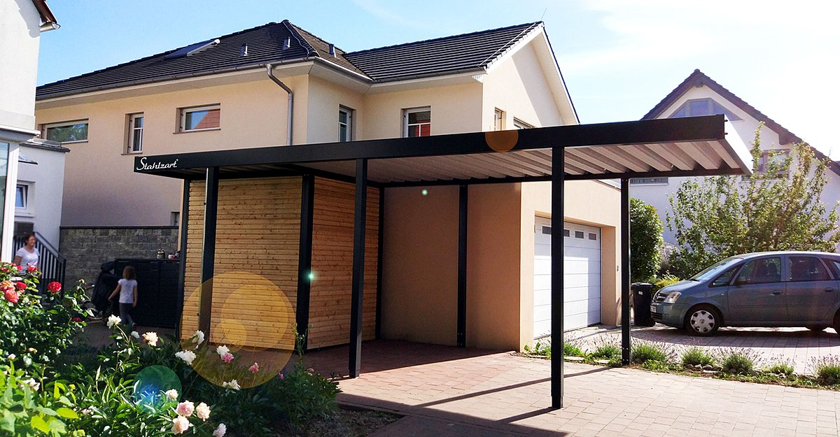

Big carport mount with 24 panels. Small carport with 9 panels.

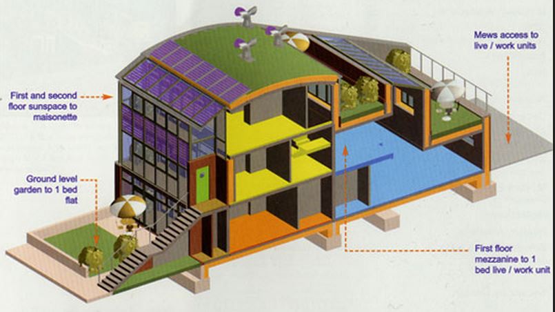

I toured an eco village type of suburb ( Bedzed) in the UK. It was built 20 years ago before solar panels became cheap enough to be worthwhile and depended on passive design with gardens and sunspaces built in. Seemed to work pretty well. Link to picture.bedzed-cutaway solar home.jpg
Back then they claimed the average BedZed resident has an ecological footprint of roughly one quarter of the average American suburban resident while maintaining a modern UK lifestyle. They had petrol cars but didn't drive much, and had gas boilers but didn't run them very often. 100 percent occupancy with premium resale values as well.

I toured an eco village type of suburb in the UK. It was built 20 years ago before solar panels became cheap enough to worthwhile and depended on passive design with gardens and sunspaces built in. Seemed to work pretty well. Link to picture.View attachment 133191
