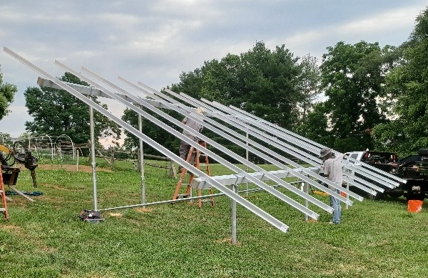

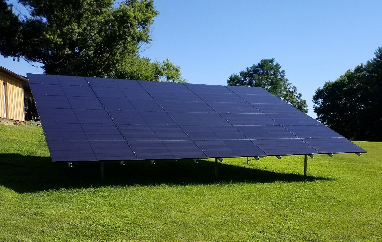

So very proud of our new 14.8kW solar array. We went live on August 12th with the Net Zero program with our utility. I've been having fun watching our energy usage be "fueled" full time from the panels (sunshine permitting) and building our solar credits when we produce more than we can use daily. Still tied to the Grid at the moment, but our 5 year plan is to put in enough power wall batteries (I'll need 3, I'm assuming) to run the house and barn and carriage house, plus the electric car, the electric truck (due the first half of next year), and electric mowers, at 100%.
We also took advantage of our county's new solar exemption for property taxes, which will reduce our taxes further. Plus I understand the 30% tax credit is retroactive to any systems put up in 2022.
Yesterday I biked down the road a few miles to another farm that also has a ground array. Chatted with the owner and she said her plans are also to include power walls to finally go off grid. Her array was the size of mine but for a house half the size. She said they just recently purchased the property from a family with 3 kids, so that family's annual electric bill was far bigger than what she and her husband use. The other family's annual usage was used to determine how big the solar needs would be, which worked out to this lady's advantage because it will cover the power needs of an electric vehicle which they hope to get by next year. They have the same utility company as mine, and are also sending their power to the Grid through the Net Zero program. She said her monthly electric bill is $7 (for the connectivity fee). Cannot wait to see my $7 utility bill for August, rather than the standard $200+ bill.

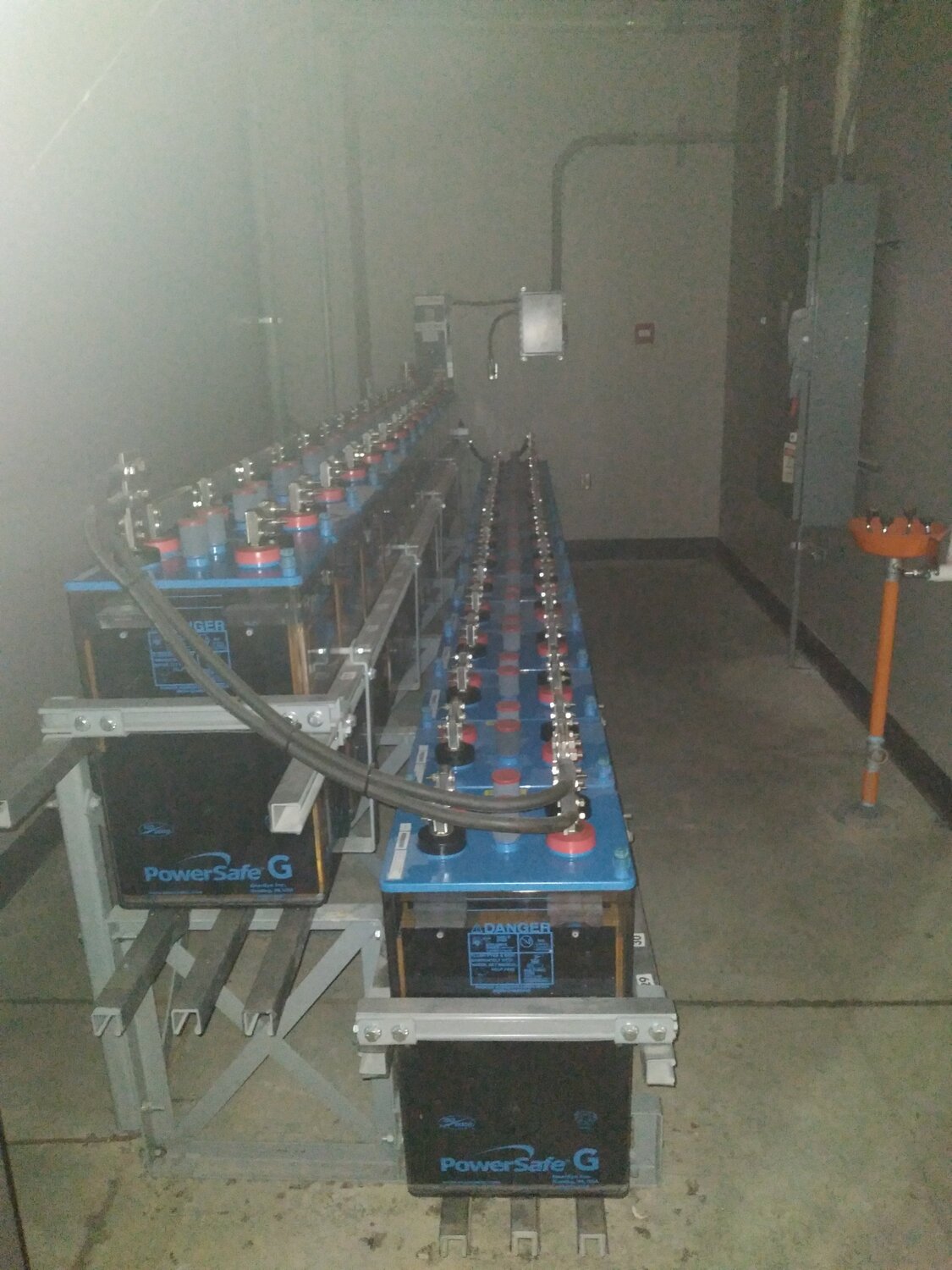

I have done the math on my household and I believe with a little discipline we could get by on a 7-8 KW array, what I would use for storage would be the "Iron Edison" battery setup,heck you could actually get by with lead acid if the bank was big enough, the real trick on LA is to never discharge to heavily.The Nickle Iron batteries will stand a fair amount of abuse, the electrolyte(KOH) is not hard to replace.
Off grid 20 years and have used most types of batteries out there. I would not go with flooded cell as they require way more maintenance. Good AGM sealed like the Vmax tanks will last 10 years and were designed for military in the Iraq war. I have 3 still in use at 9 years with very little drop in capacity.
I also like LIfepo4 and have two 200Ah and a 100AH on my recharging systems. You get twice the capacity and lifespan at half the weight and maintenance free.
Well you can get an automatic"watering system" for the flooded cells( seems that FeNi cells will tolerate inattention better than the Pb cells,I noticed "Carbon Foam' batteries were quickly dropped from the "Iron Edison site, seems they have a following as well, when its all said and done on the grid, flow batteries and the "molten metal' types seem to have true heirloom quality.
The "Trojan" batteries seem to be pretty good but require a lot of attention,I am on the fence about the Li-ion cells they seem to have a great potential for catastrophic failure OTH with a service contract and extended warranty they could be no brainers.
