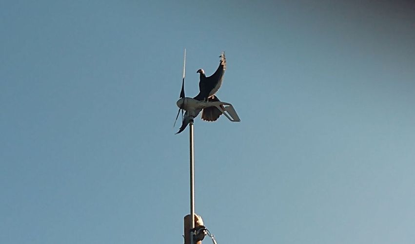

People have asked me about wind turbines a lot and I have a 400 watt wind turbine but we rarely get enough sustained wind here for the turbine to provide reliable energy.
People generally over estimate how much wind they get and you need at least 5mp or more of wind to even get it turning and more for larger turbines.
In winter the turbine produces more and helps keep the batteries topped off but in summer my turbine sits idle most of the time and has become an attraction for the buzzards they transplanted here.
I recommend solar before wind power and there are wind maps online that will tell you your average wind for your area.

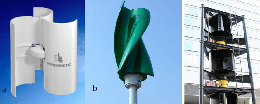

VAWT or vertical axis turbines require even higher wind speeds but they don't have the stall effect and are less likely to be damaged in high winds.
Yes and it is same measurement regardless of source.
No clue what you just said. SORRY.
Lol, Ok a Savonius wind turbine is a vertical axis turbine like shown below.
They do not need a tail and can handle sudden changes in wind direction without damaging the turbine.
I actually designed one that uses a shield to block the wind from one side of the blades and has a tail and applied for a patent.
The more typical turbines you see are horizontal axis or HAWT turbines and those are the commercial turbines used in wind farms and off shore but there are improvements to a VAWT now that could make them competitive.
