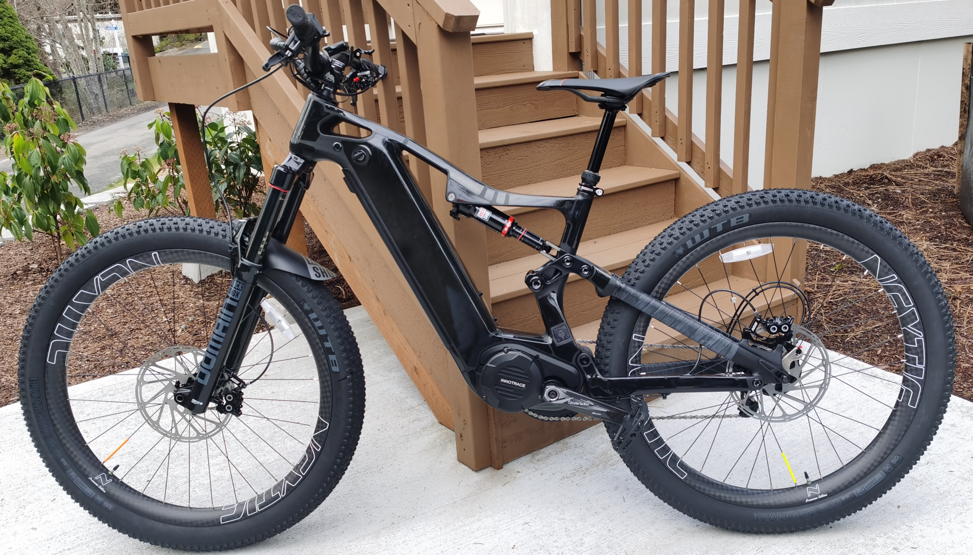

I have a motor with Innotrace X1 controller and I would not call it smooth, especially after Yamaha PW-X. The Innotrace X1 motor I have is quite jerky and laggy. The throttle is extremely sensitive and jerky. I have a feeling Innotrace just sent me a regular Bafang m620 motor with Innotrace logo on it. The reason I feel it this way is not only because of it feels jerky but also because of Innotrace did not attach the 60A plug I ordered with the motor and then they responded that they forgot to solder the plug after I informed them about my finding. Now I feel like they "forgot" not only to attach the 60A plug but also the X1 controller itself and just sent me a Bafang m620 motor with stock controller. I would like to have a programming cable from them to see the tune and maybe to adjust it but Innotrace does not respond anymore. Their business feels quite shady. I could open the motor case to check if there is an Innotrace X1 controller inside but there is a warranty sticker on the motor case and I do not want to loose my warranty.
This is my first e-bike with Bafang M620 motor with Innotrace X1 controller and I never had experience with Bafang m620 motor with stock controller so I have nothing to compare it with but I can tell for sure it is not even close to Yamaha PW-X in terms of smoothness and lags. I also do not like that the motor does not provide support before it starts sensing speed so it is very hard to start moving from stand still, especially uphill (Yamaha PW-X provides support instantly once it feels pressure on the crank arms torque sensor regardless of sensing zero speed and this is great). Would be nice if Innotrace X1 works the same way, maybe provides at least gentle support at the beginning if it senses zero speed).
Nice looking bike……I can bet your bottom dollar the Yamaha motor would not have the power of the X1 ultra motor, Ive tried a few, including both the stock ultra and the X1 ultra, it’s day and night the difference, the X1 I find is very smooth and powerful, I don’t use the throttle, I wish you well.
