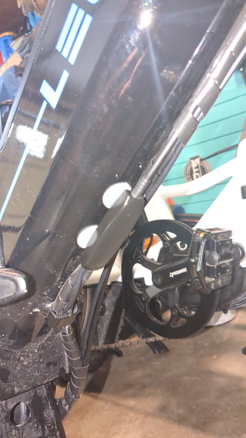

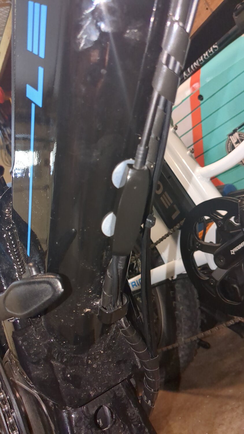

I am trying to find a way to disable my shift sensor on my XPremium. I have been shifting gears on bicycles for over 50 years! I found the sensor and followed the wire which disappears int the frame below the motor. I opened up the compartment where the controller lives hoping to find the wire plugged into the controller. No such luck. No sensor wire to be found. Appears it goes to the motor and not the controller. Anybody done this. The motor cutout delay is too long especially when going uphill.

This is a mid drive bike and it is a shift sensor. It cuts power to the motor while shifting. It has brake cutoffs also. The shift sensor is mounted on the frame tube and the shifter cable runs through it and there is a wire going from there to the motor

I suppose you could call it a low end bike but it is Lectrics most expensive model. It has brake/motor cutoffs but it also has a shift sensor that cuts the motor power for a short blink. You can trace the cable from the shifter down through the sensor in my pics. It has nothing to do with the brakes whatsoever. I dont use the brake for shifting, do you? Not sure where you got that sentence you put in there but it detects movement in the shifter not the brakes. You might want to check their site again. I actually pulled the cover off the sensor and the actual shifter cable runs through it. My brakes have no cable as my "low end' mid drive has hydraulic brakes. Wish you actually had something helpful and correct for me.

got it right from their website. can you manually remove the sensor from the cable? you may have the take the cable out and then side it off the housing? sorry but lectric is a cheap bike no matter what. the housing will have to be replaced sometime in the future so the sensor may come off. if it is a shimano shifter then it cant be built in.
I just looked at Lectrics website and it does indeed say that the shift sensor detects movement in the brakes. Another of Lectrics many misprints. I have found plenty in my bikes manual. It IS a shift sensor as it says. Explain how one would be connected to brakes. Here is the info from the manual:

I can dismantle it but don't want to. Was hoping to unplug it but there is no connection in the controller location. Goes up into the mid drive motor which I don't want to go in there.

Welcome @BMXPremium. You have my empathy. I am an electric bike mechanic. You want options and answers. I am listening. One option is to cut the wire. Peal it back. There will be three wires inside such as red, black, and blue. Bend those wires back and seal them with shrink tube so they do not touch and moisture cannot get in. The shift sensor uses the same circuits as the lever cutouts. In my opinion, if you trace the brake lever cutouts you will find the splitter connection to the shift sensor and can disconnect it there.

Thanks there seems to be no wire to the sensor, just the shift cable. There is a sheathed wire leaving the sensor going down to the motor. Inside the sensor which i opened is the bare shift cable that goes over a small cam with a small circuit board behind it. No wires going to or heading from the brake levers. I'm sure that may all be interconnected somewhere like in the mid drive housing but not in the frame where the controller is. I was hoping to try something temporary like unplugging in case I wanted to go back but I'm not really seeing an option. Thanks

One way to do it would be to release the cable from the derailleur, pull the cable up past the sensor and take out the shift sensor altogether and set it aside with a zip tie? Feed the cable back through, there is probably plenty of slack to allow for taking out the sensor.

The controller is in the lower end of the fold of the folding frame. Only battery and motor connections on the controller. 2 batteries. If i took out the sensor there would be about two inches or so of bare cable with no cable housing.
Cable housing is easy to replace with new longer housing. Or, you could just cheat. I do all the time. And highly recommend it. Just replace it with an Inline Shift Cable Adjuster. Done & Donner!
