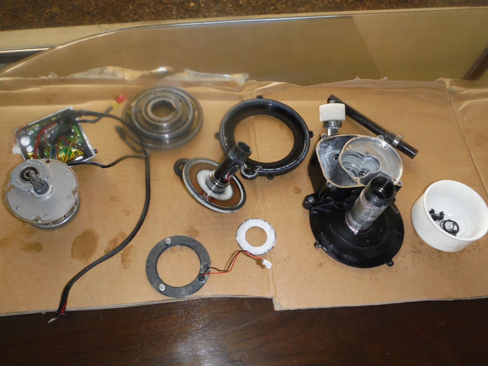

BMX, I would suggest taking a closer look at what you have.
First, I am not aware of any “mainstream“ mid-drive that has an external controller. Bosch, Shimano, Brose, and I’m pretty sure Bafang as well, have their motor controllers located within the motor housing. Do you know the manufacturer of the motor?
Next, of said mid-drives, none of them that I’m aware of have sensors that are hardwired directly to the motor. They typically have connectors or pigtails with connectors so the sensors can be more easily installed during manufacturing as well as be easily replaced if they fail. With that said, you may need to remove the motor to locate and gain access to the shift sensor connector.

Maybe what I'm assuming is the controller that i found is actually the battery equalizer for the two batteries. I'm not really having an issue, just wanted to try disabling the shift sensor as an experiment if you will. If I open the motor housing i void the warranty. I was just hoping for an easy unplug externally but it looks like no luck. Thanks for your time
The controller is in the lower end of the fold of the folding frame. Only battery and motor connections on the controller. 2 batteries. If i took out the sensor there would be about two inches or so of bare cable with no cable housing.
Think about that for a second? The cable housings will butt together when the sensor is taken away....
I’m not saying open the motor. There should be a connector for the sensor somewhere outside of the motor. You may need to remove the motor to locate and disconnect it. Again, I would be very surprised if the sensor was hardwired directly into the motor without an external connector.
To reiterate: Follow a brake lever cutout wire. It will lead to the Y of the shift sensor connection.
There really are NO Wires coming into the sensor from above, only the shift cable, coming out of the lower end of the sensor is the other end of the cable and a sheathed wire that goes directly down below the mid drive and up into a hole into the mid drive unit. I just went out and unwrapped the wires coming down from the brake levers and found where the Y connection brought the brake cutoff wires together but there is no connection going to the shift sensor at all. That wire after the Y also goes down under and into the mid drive unit. If there is a connection it would have to be up inside and I see no way to access that without some disassembly. Thanks for your help
