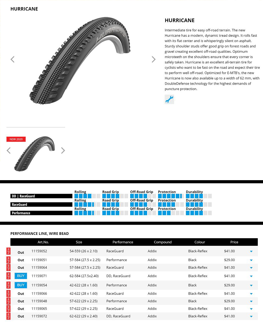

I recently installed Schwalbe's latest hybrid tire, the Hurricane on my Riese & Muller Homage, replacing the Rock Razors that came on the bike and the Super Moto X that I replaced those with. I installed the 27.5 x 2.4 Double Defense Raceguard with reflective sidewall stripes. I inflated the tires to 35 psi in the front and 40 psi in the rear.
The Hurricanes at quite smooth in the middle with tiny knobs like a gravel tire on either side and substantial lugs at the shoulders. They score strongly across the board in rolling resistance, road grip, off road group, protection and durability.
