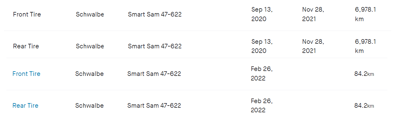

Small stats for a single pair of Smart Sams I have been using:
No single flat. No signs of wear.
