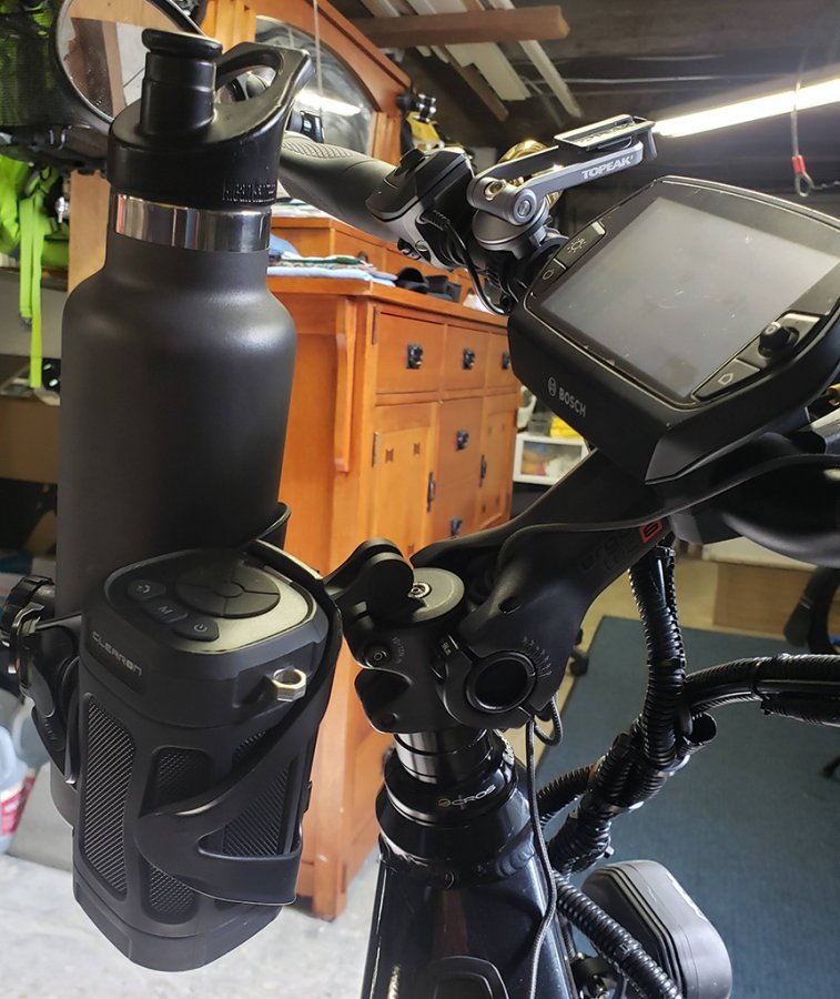

The Nyon retrofit is easier with an Intuvia as they both use the same handlebar mount. The Kiox has a special stem that I think is likely too wide to accommodate the Intuvia mount. To retrofit where there is already a Kiox installed, would require a new stem and an intuvia mount wired down thru the tube in into the motor. I replaced the stem on my Homage with an Ergotec Swell Ahead adjustable stem. It is made by the same company that makes the stem that comes standard on the Homage and is a step up in strength rating. Being able to adjust the stem angle is very useful. It is certainly something that an be done but frankly Riese & Muller might balk at stem replacement and it could cause warranty issues. They really fussy that way. @David Berry has a Homage with Rolhoff e14 and a Kiox. He has been a rather outspoken critic of the Kiox on this forum. He could probably be helpful on this.
I found the stem which came with the bike, open chest style, very uncomfortae so I replaced it within the first few days of purchasing the bike.
