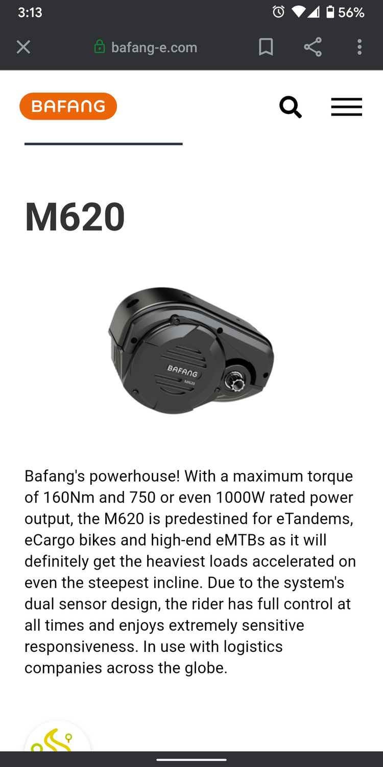

The Bafang is not being "detuned" to 750watts. Bafang offers a 750watt version of the Ultra motor. The tuning of PAS is what is completely custom to the Elite bikes. Sondors worked directly with Bafang on programming for a more refined ride.

Per Bafang the M620 is available to purchase with a 25amp OR a 30amp controller. Therefore having an Ultra with a 25amp controller is not a detune. It's just not the more powerful option. Putting a 20amp controller in would be detuning it.

I have only known the bafang m620 as 1000 watt nominal, with 30 amp controller. that's how it's always been advertised any and everywhere I have seen it advertised for sale.
I get that it comes in different wattage configurations but its main base , Bafang Ultra 620 is a 1000 watt/nominal as a base model from Bafang. so any less than that to me is a detune ,that's my opinion.
and I am wrong at times, but bafang 620 Ultra base model is a 1000 Watts nominal .
as advertised from the factory.
Yes you can reconfigure in many different ways.
