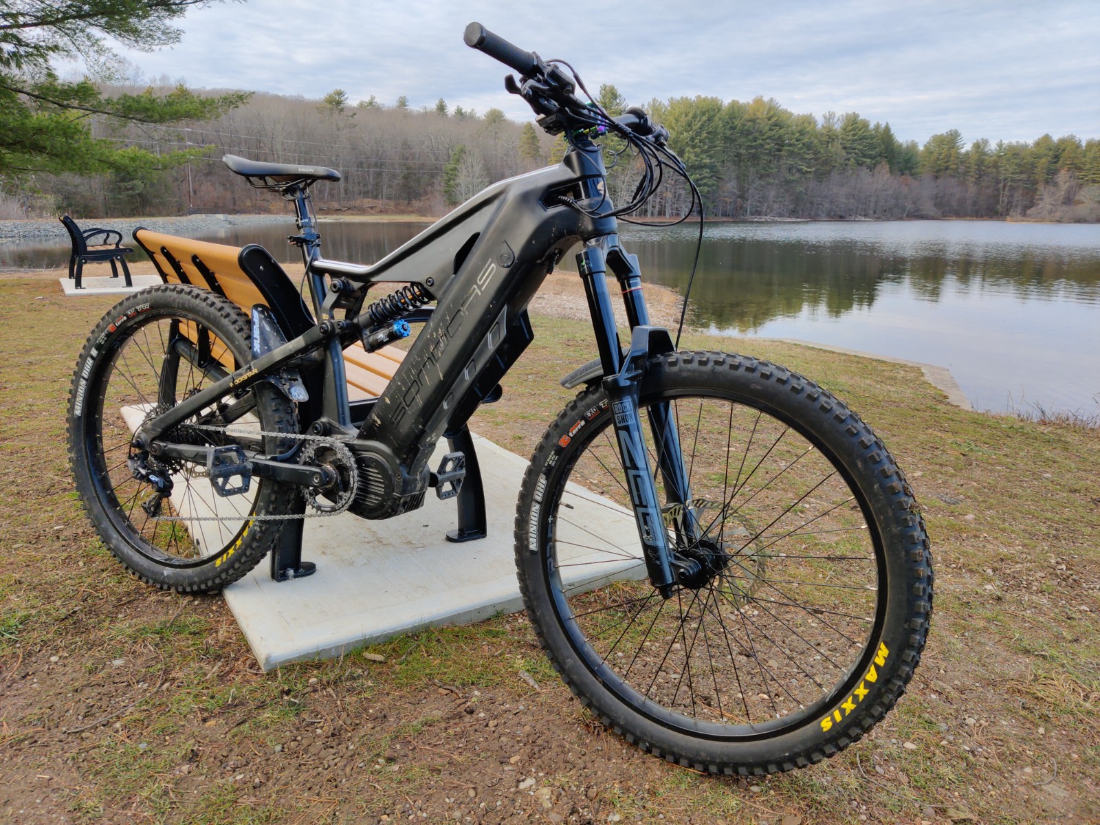

RoskShox ZEB 29" 170mm forks w/fender, Fox DHX RC4 coil shock 400lb coil, Christini chain ring adapter with 36T chain ring, KMC e11 chain, Sram gx 11 speed derailleur, Miranda 155mm crank arms, Ergon seat, crank brothers stamp1 pedals, 203mm front rotor, 35mm oil slick stem, Maxxis Minnion DHF and DHR 27.5x2.8, motor has been serviced and all suspension bearing have been replaced.

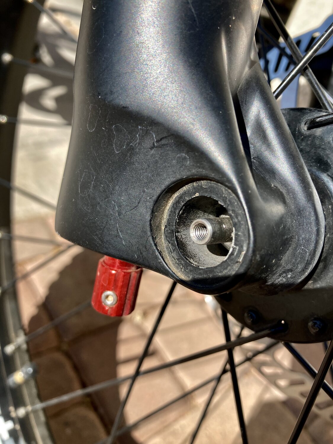

Hi, I had the same issue with my front fork. I've pretty much been able to determine that the fork conforms to "Boost" dimensions which are 15 x 110. However, the stock front axle is 165 mm long and every boost front axle that I've seen is only 158 mm. Not sure about the Thread but suspect it's 1.5.
I was forced to order a stock front axle from Sondors. Still waiting. I'd like to replace that with a "Stealth" axle. I'm not fond of the Quick Release.

Onto the front axle.
my lever pivot broke today and searching the web for a 15mm x 162mm axle turns up nothing.

Rockstar Axle Update. The Wolf Boost Axle, while shorter than the stock axle, is working temporarily - at least until Sondors sends me the replacement axle. It only threads about ⅔ of the way into the locking bolt on the left side, but when tightened, holds everything in place. I will likely do what was suggested by a fellow on the Sondors Rockstar Owners Facebook Group, which is to purchase a longer 15mm axle, cut it to 164mm, and use a thread-cutting die to extend the threads to the 21mm as they are on my original axle. Otherwise I DID find a 15X100x163 axle on modernbike.com, but it's $114 and Out Of Stock.
RoskShox ZEB 29" 170mm forks w/fender, Fox DHX RC4 coil shock 400lb coil, Christini chain ring adapter with 36T chain ring, KMC e11 chain, Sram gx 11 speed derailleur, Miranda 155mm crank arms, Ergon seat, crank brothers stamp1 pedals, 203mm front rotor, 35mm oil slick stem, Maxxis Minnion DHF and DHR 27.5x2.8, motor has been serviced and all suspension bearing have been replaced.View attachment 144265View attachment 144266View attachment 144267

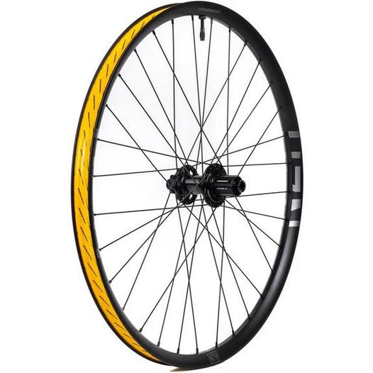

For Sale brand new in box. Nukeproof Horizon V2 Rear Wheel 102t 27.5" / 150/157mm x 12mm HG. Perfect for Rockstar. $300.00 plus shipping.
