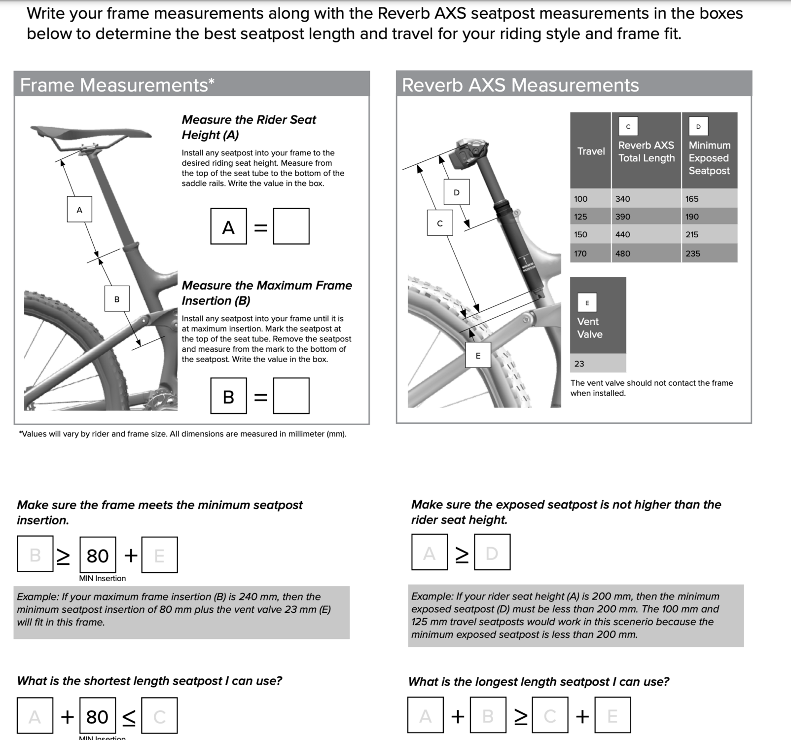

I'm thinking about spending the money to get the fancy wireless Rockshox Reverb AXS dropper post. I'm not understanding Rockshox's sizing instructions, though.
In particular, the "Minimum Exposed Seatpost" measurement. That's really the "Maximum Exposed Seatpost" measurement needed, right? That is, one can drop the seat so that the "D" measurement is just about zero, and can extend it all the way up to the "A" value in those charts. And if one doesn't insert the post all the way into the frame (at least 80mm needs to be inserted), then that Maximum gets larger, but the true lowest drop position also gets larger.
Am I wrong here? What's confusing me is the "Make sure the exposed seatpost is not higher than the rider seat height." They claim the longer seatposts won't work, but surely that's set by the "What is the longest seatpost I can use" section.
I'm really confused. I don't know why they just don't give us the length of the Body (which would be C-D+the height of the top ferrule) and then we could figure out the rest from the travel. The top ferrule is just under 65mm (D-Travel) for all versions, call it 55mm with 10mm from the top of the post to the middle of the seat rail clamp.
Help!

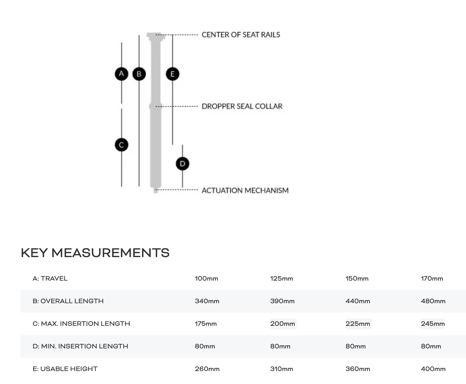

OK, I found this chart at JensonUSA:
And "C" answers my question.
I've concluded that the "Make sure the exposed seatpost is not higher than the rider seat height" criteria only matters if you want the maximum seat height to not be higher than your normal riding position. However, doing this often means giving up some travel. I'd rather let the seat go higher if I wanted - basically I'll put my butt where I want the seat height to be, and if needed, can tweak from there. Which I think means I go with the largest travel such that "C" still fits in my frame, which is the 170 travel - so that's what I ordered.
