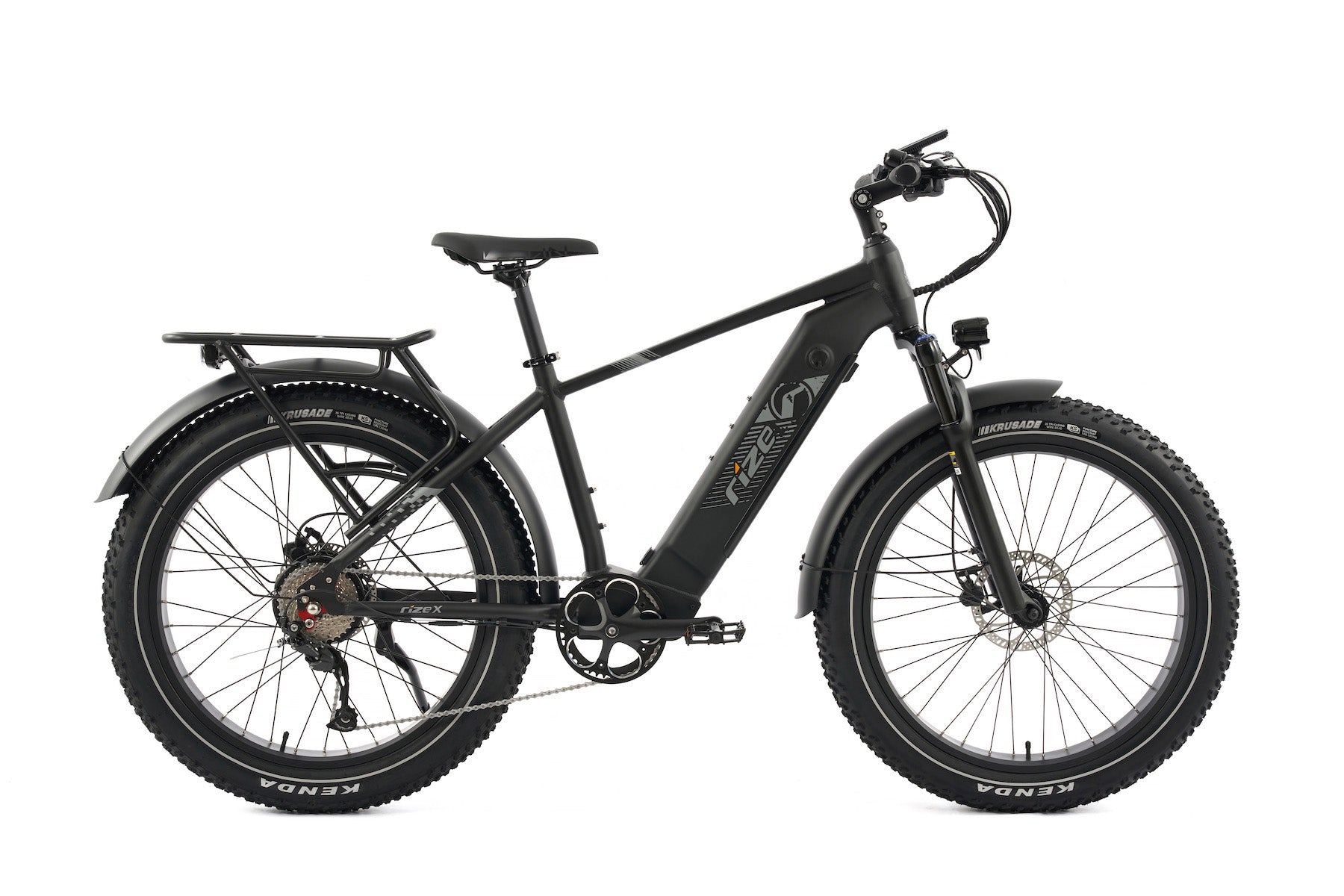

Hi All,
I a would like to purchase an ebike that can handle my weight (265 lbs) and my budget (around 2000 cdn). I would like something that I could use on the trails and on road... I have shortlisted them to the following 3.
Volt yukon 750 ltd
Radrover 5
Rize x
Does anyone have any experience with these or would recommend one over the other? Your help would be much appreciated!
