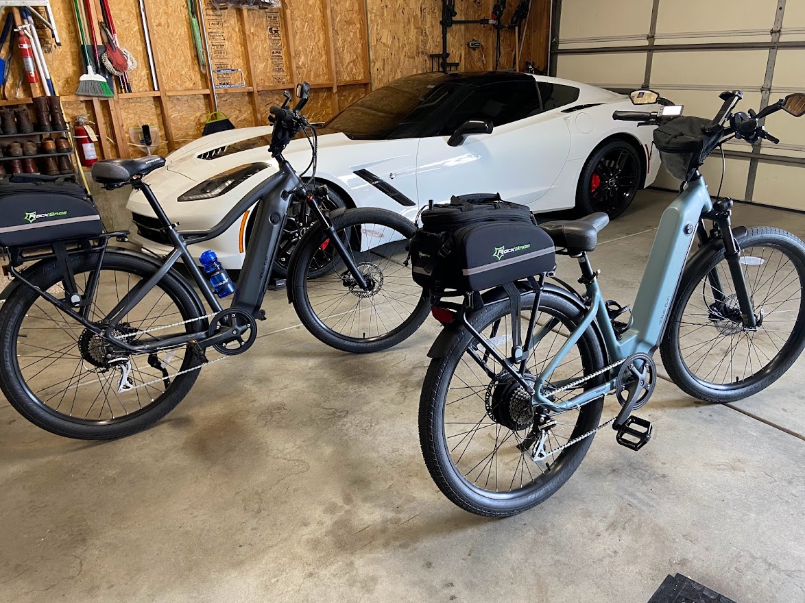

I'm about 6'2" with a 34" inseam and my XR fits great! My seat is set on the "6" mark and the handlebars are up and forward a little for my 36" sleeve length. This is a great riding position for me, I am sitting nearly upright!!
I feel more crampted on my wife's ST because her seat seams a little closer to the handlebars. I need to have the seat up quite high to accomodate my leg length but then I feel like I'm well over the handlebars, it's just not as comfortable for my size as the XR is.
They are both awesome bikes so far, week 2 and today it is snowing...uhhh!
