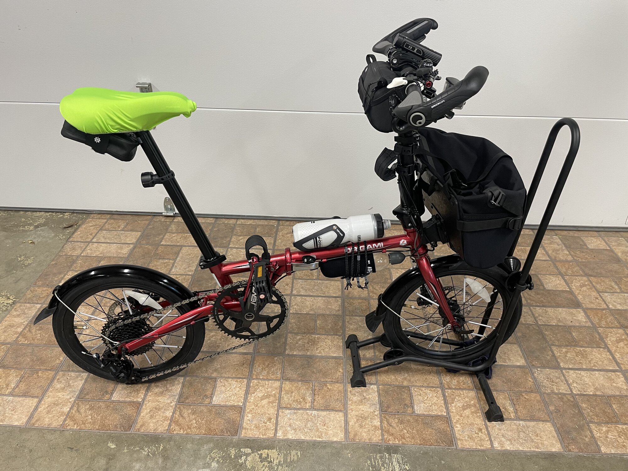

Btw i love your folding bike, that's the one i'm planing to get for next Qiroll Pro project. I'm aim for Fnhon Gust brand model like yours, looks identical. Is that a 16" wheel?

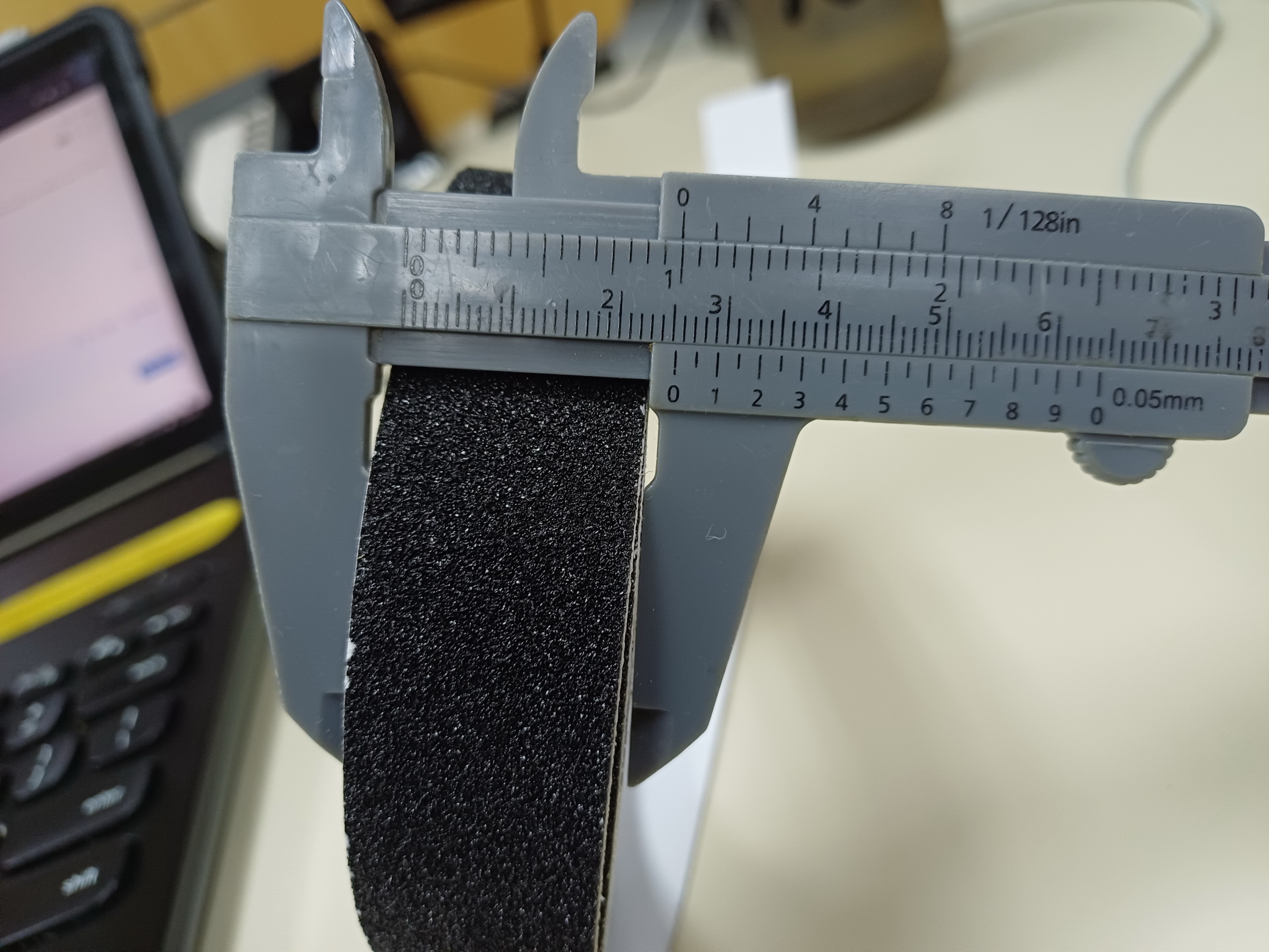

My grip tape width is 25mm, fits exactly on Qiroll Pro roller groove.
Thanks for the measurement info!

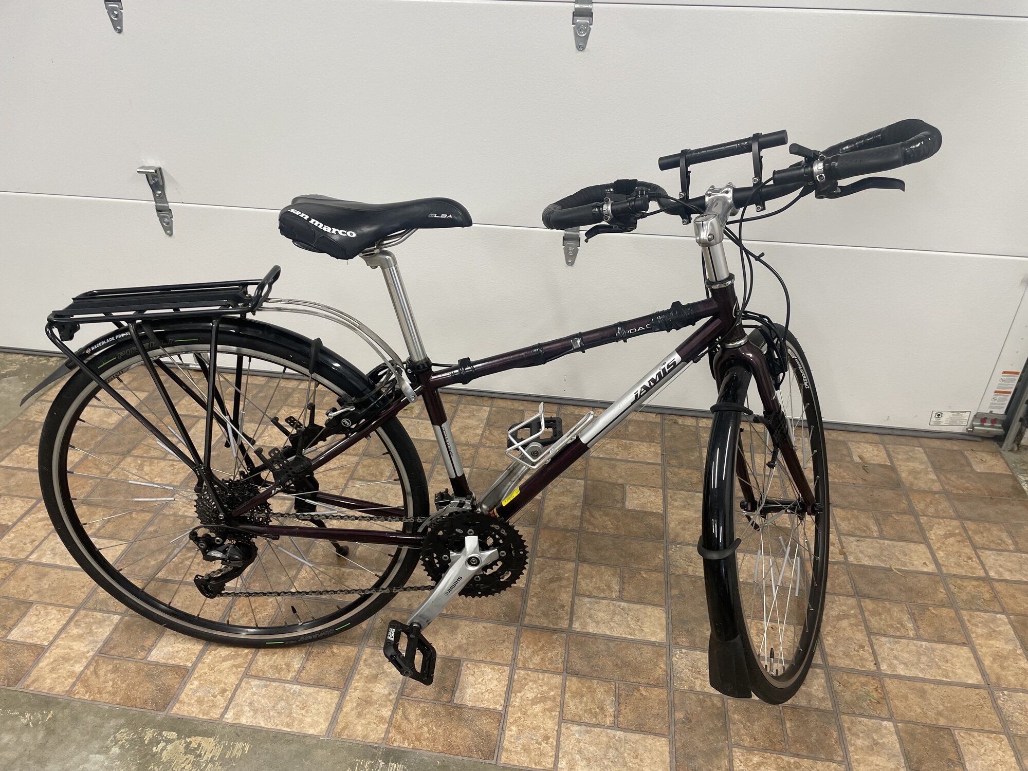

Yes, 16" wheel. This is the bicycle. I modified the drive train with 52T NW Chainring, Microshift Advent SuperShort RD with clutch, 11-38 cassette, and Microsoft thumber shifters (in friction mode.) My 700c hybrid has 30T NW chainring and the same Microshift components. They have nearly identical gear-ratios for a common riding feel, and I can stock up on the same cassettes for both.
