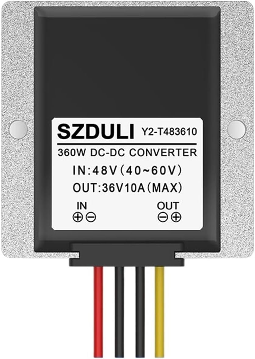

Can a voltage regulator be used to connect the Pro to standard 36V batteries?
Like these ones.
Like these ones.
I wouldn't recommend voltage regulator unless you know the peak amp (A) current consumption required between the battery and drive unit. Else i would love to use back my 52V 17Ah bafang battery pack on my Qiroll unit. You'll need to contact with Qiroll support, they have engineers on how to make thing works with battery compatibility.
I've already discussed with Jason, a 36v battery either won't work or could cause harm.
Seems these are proprietary voltages and communication with the unit. I'm used to this as all the new major brand mid drives seem to require their own batteries
Like these ones.
I'm not saying it'd work, but maybe a step down to actual 36v could possibly work with the 33v Pro. You'd have to check but I think a prior post several pages back indicated that 38v didn't work but maybe 36v is close enough? Personally I don't think that I'd risk it but I did use a similar 36/48v to 24v step down Buck converter on my Mute version and it worked without an issue. The converter didn't get hot with miles of continuous use and it seemed peppier than the Qiroll battery which starts at 25v then drops with use while the Buck converter maintained 24v output continuously as close to the battery's low voltage cut out as I ran it.
