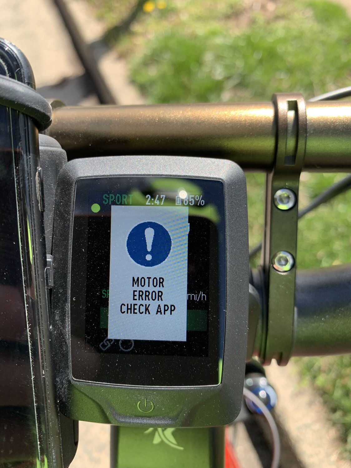

So, more 'motor' errors today.
Did a 12.73 mi. ride with 342 ft. elevation, all done in ECO, came back with 81% remaining.
Not too sure (yet) if this IGH model will give me what my Vado 5.0 used to.
(I was used to 25-35 miles with 25-40% remaining)

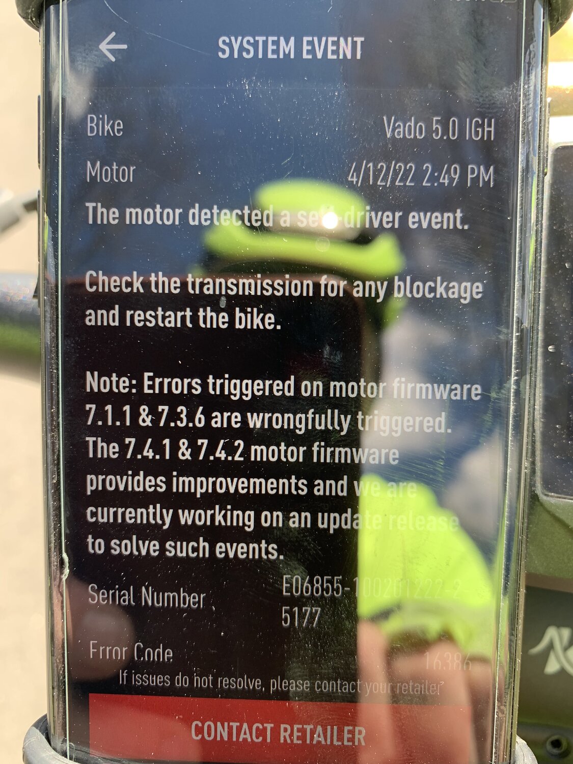

Regardless of that disappointment, more disappointing is the dreaded motor error again.
(The one which the dealer told me that it WILL continue to keep happening and that I must turn the bike off and then back on to continue to ride).
The one that states, NOTE: Errors triggered on motor firmware 7.1.1 & 7.3.6 are wrongfully triggered. The 7.4.1 & 7.4.2 motor firmware provides improvements and we are currently working on an update release to solve such events. Error code 16386. If issues do not resolve, please contact your retailer.
The retailer, last week, did the update(s).
My concern, moving forward, how long for a resolution, what next, and should I be proactive and do what? "Rider I-Don't-Care" does not reply to inquiries, calls, or e-mails, the dealer tells me to turn it off and turn it on and that's it.
