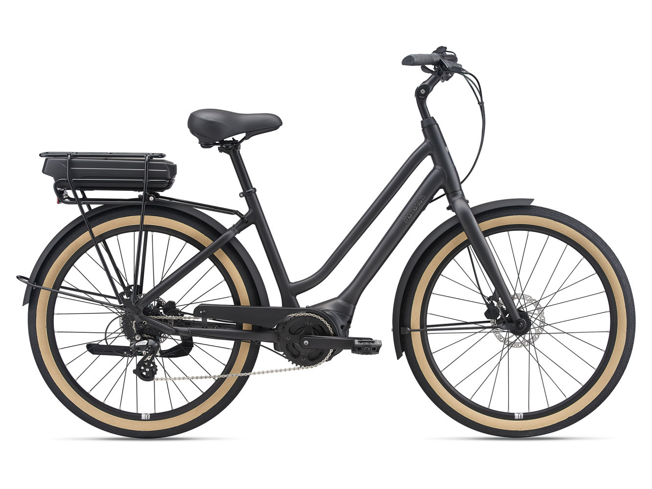

I need to replace the tires on my La Free (26X2.35 CST Metropolitan Palmbay)... Apparently letting the bike sit on them in the garage for months at a time is not a good thing 😱.
Anyway, it's a forest out there in the tire world and I've lost sight of the trees! Should I replace with same? Choose another brand? Continue tubed, or go tubeless? Can I use a slightly"thinner" (like 2.3 or 2.1) option?
Suggestions welcome!

I looked up your bike. Maybe I saw a different version, but it said they are 700c rims. If that is the case then you have many more options. I like WTB gravel tires because they can do just about everything. The compound is hard in the centerline and soft and knobby at the edges.
Mine is a 2019, but I don't think it's changed (except that picture is the belt drive version - I have the chain.
I ride mostly on paved surfaces (bike paths, rural roads) with occasional dirt and gravel. Nothing hard core or MTB.

Gordon, just before we left for the spring I started noticing a rhythmic "bumping" sensation, mostly in the back tire, but also a little in the front. We checked the rim, the bead, the pressure - everything we could think of. Took it to the LBS yesterday, who checked the same, plus the wheel truing. He said he thought the rubber in the tire had gotten distorted somehow (when you spin the wheel, you can see the tread "jiggling". He offered to take the tire and tube completely off and reinstall, but said there was only a 20-30% chance that would take care of it, so I opted not to. He said they're safe to ride, for now, but I should consider replacing the tires.
Does that sound right, it is there something we all may have missed?

Any ideas about latitude from the 2.35 aspect? Could I go to 2.3 or even 2.1, or do I need to stay exact?
Having a slight conflict of goals with my personal "mechanic", who always goes for the cheapest thing that will work, VS a balance of price and quality 😂😁😂.
Yes, plenty of latitude going smaller. The issues may start appearing when going larger. Going from 2.35 to 2.4 shouldn't be an issue, but sizes bigger than that should be approached with caution.

If you change the tyre width, the display readouts will slightly change. More important is that the tyre fits inside of your fenders. Too wide the tyre and it might not fit.
I bought a 2.4 "Vitto"( similar name) it was huge on the standard rim.
I wouldn't go any bigger than the 2.35, but there are several options that are just a bit thinner - just getting my ducks in order before order 😉.
