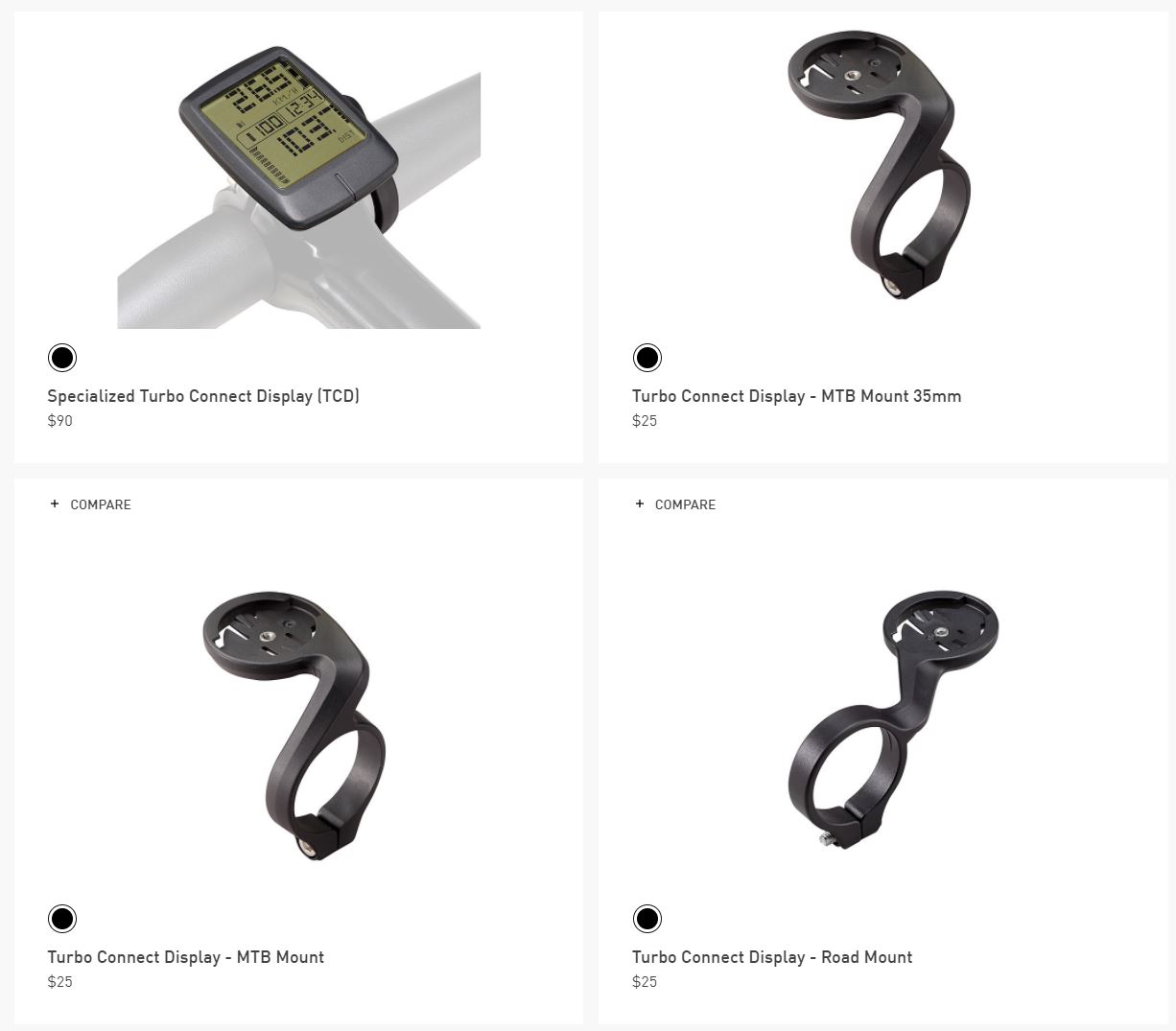

does the TCD not function without the remote? obviously specialized sells the mount for the TCD in several sizes for the different bikes. the creo road remotes definitely have a different connector than the TCD. @Stefan Mikes what does the connection from the remote to the TCD look like? it looks hardwired. could you just use the buttons on the TCD itself instead?

@mschwett: Please do not confuse the TCU (the main SL controller located on the top tube) with the TCD which is a wireless display and is absolutely optional (I have replaced the TCD with a Wahoo ELEMNT).
You can operate the TCU by buttons on the top tube. The big question is what would happen if the "remote" has been disconnected from the TCU. If Vado SL continues working, it is the straight way to just convert a Vado SL into an "almost" Creo SL E5. At high cost, still far cheaper than buying a Creo.

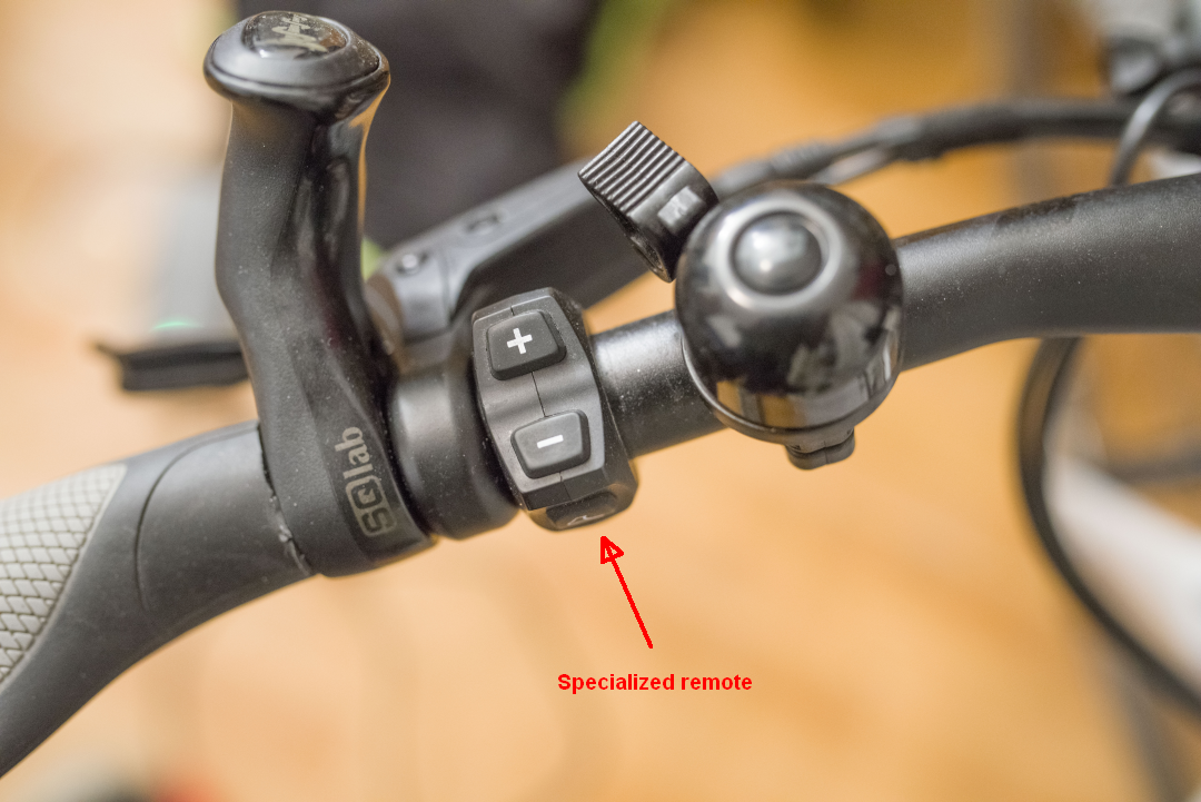

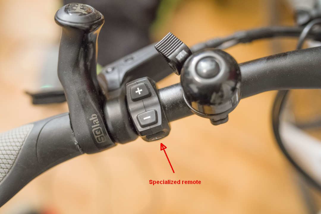

Specialized handlebar remote, or the part that makes turning a Vado SL into Creo SL so hard. It is a hard ring of the internal diameter of 22.2 mm.

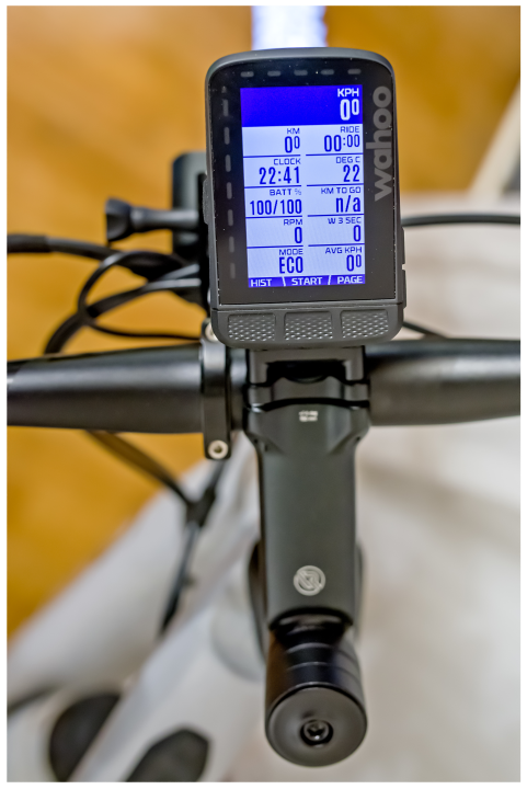

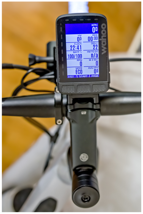

The stem of Vado SL replaced with Redshift StockStop one, and with Redshift Computer Mount (Wahoo) to totally replace the TCD with the ELEMNT Roam.

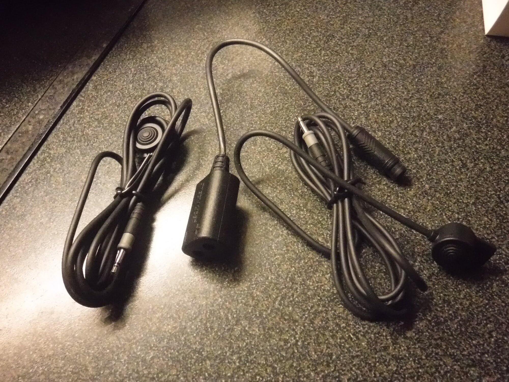

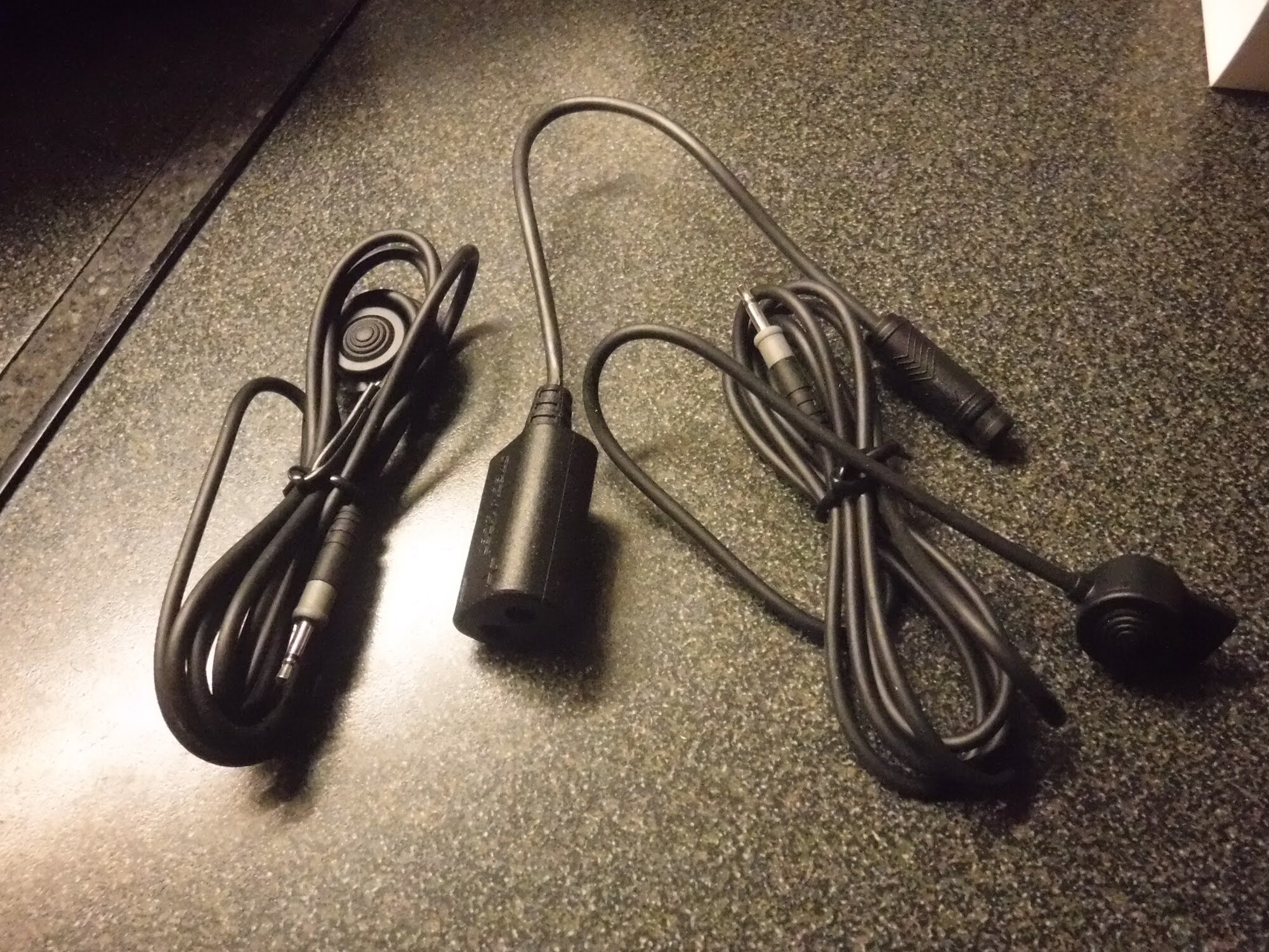

what do those two buttons do? the pictures i saw showed them wired to something which looks like the TCD, but from what you’re saying they actually connect to the TCU, just like the blip remote buttons on a creo.
This is the WIRED Creo power "remote" kit. It apparently plugs into the TCU (top tube display and controller). One button Power UP and one button DOWN.
i have one of those sitting in my desk too, daring me to install it! but more wires 😒

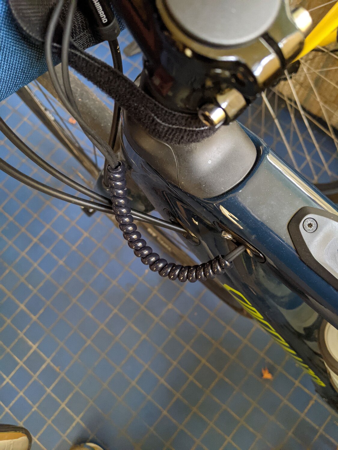

The shop installed mine and they left the two thin wires where they enter the top tube port loose. Now that did offend my sensibilities. Actually, I was more worried about those thin wires snagging one something. I used one of those kid jelly, coil spring bracelets as a wire wrap. I just snipped it, turning it from a closed circle to a linear coil and wrapped it around from near the handlebar to that port. I should probably do the same for those other cables. Does your Creo have internal cables for brakes/shift or the electronic shifters?
The Vado SL would be operated by the TCU if the remote is disconnected. The Vado SL would not have a way to shift to the walk mode or the one button full assist mode. The Vado SL remote can also be plugged in to the Creo but the walk mode button does not work. It's probably not enabled in the firmware.
The Creo remote buttons plug into a switch box and then to the wiring harness connector. They do it this way so they don't have to run a wire between the two handlebar buttons. It looks odd but it is a better design.
The Vado SL remote control just plugs into the wiring harness connector.
Just to summarize the functions of the Specialized handlebar remote for different e-bikes:
  • For Vado/Como pre-Mastermind: +/- for Assist Mode selection, top button for TCD page flipping, bottom button for lights on/off OR the high beam headlight, + button for Walk Mode
  • For Vado SL: +/- for Assist Mode selection, top button for Turbo mode engagement, bottom button for Walk Mode
  • For Mastermind e-bikes the top and bottom buttons have become F1 and F2 ones. The number of combinations of different buttons has become terrific: For instance, short press on F2 enables MicroTuning, that is, possibility to set the Assistance % as you ride (with + and - buttons).
