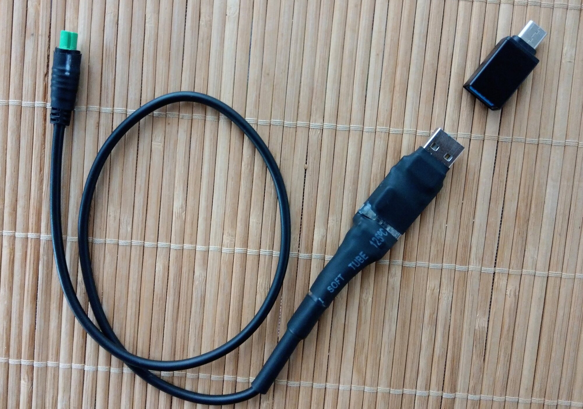

I received my cable today.
Not going hook it up today.

Follow the instructions. It’s clearly outlined.

Then there's also the Android app SPEED that allows you to make changes during a ride and if so desired, use your phone as a display. Excellent tool once you feel comfortable making changes to tweak things as you go. You'll need an OTG ADAPTER for your phone to use it with the cable you just received.
Lastly I found it helpful to trim the rubber off the end of the programming cable. It doesn't need to be water proof and trimming it makes it much easier to line up when plugging in.. and reduces strain on the wiring harness when you unplug it.
