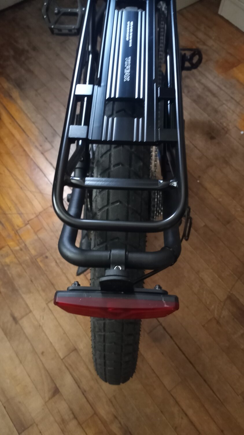

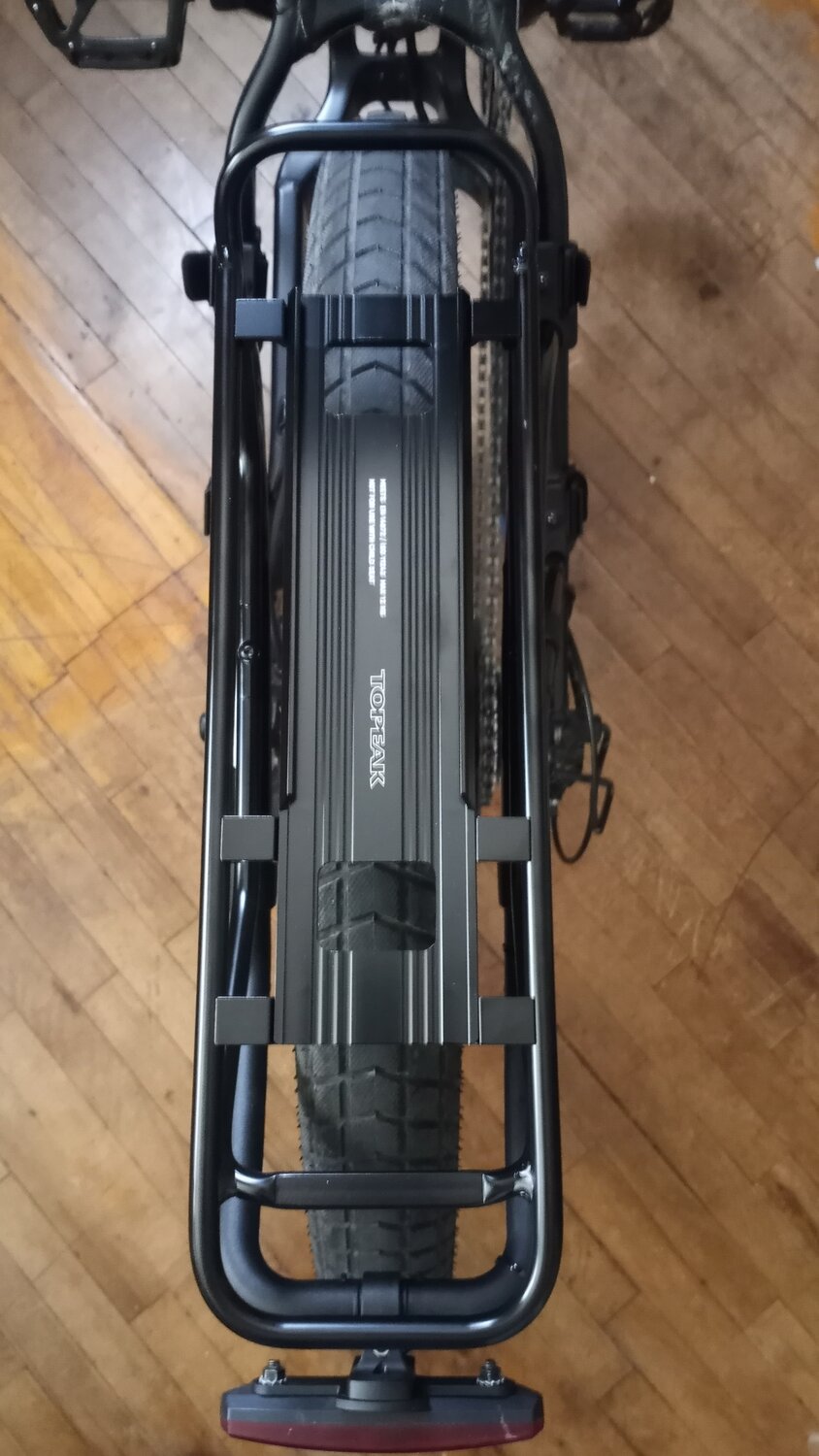

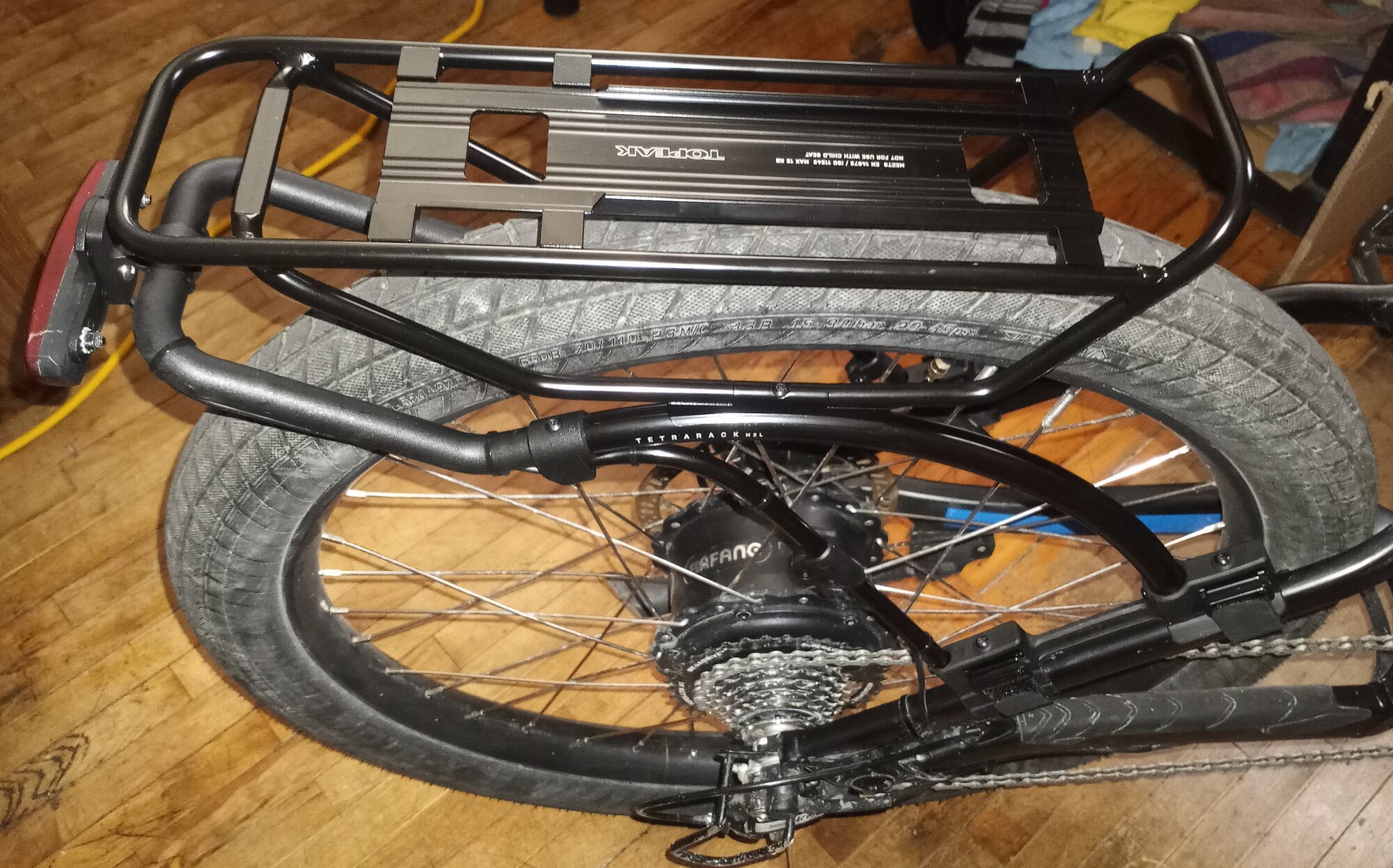

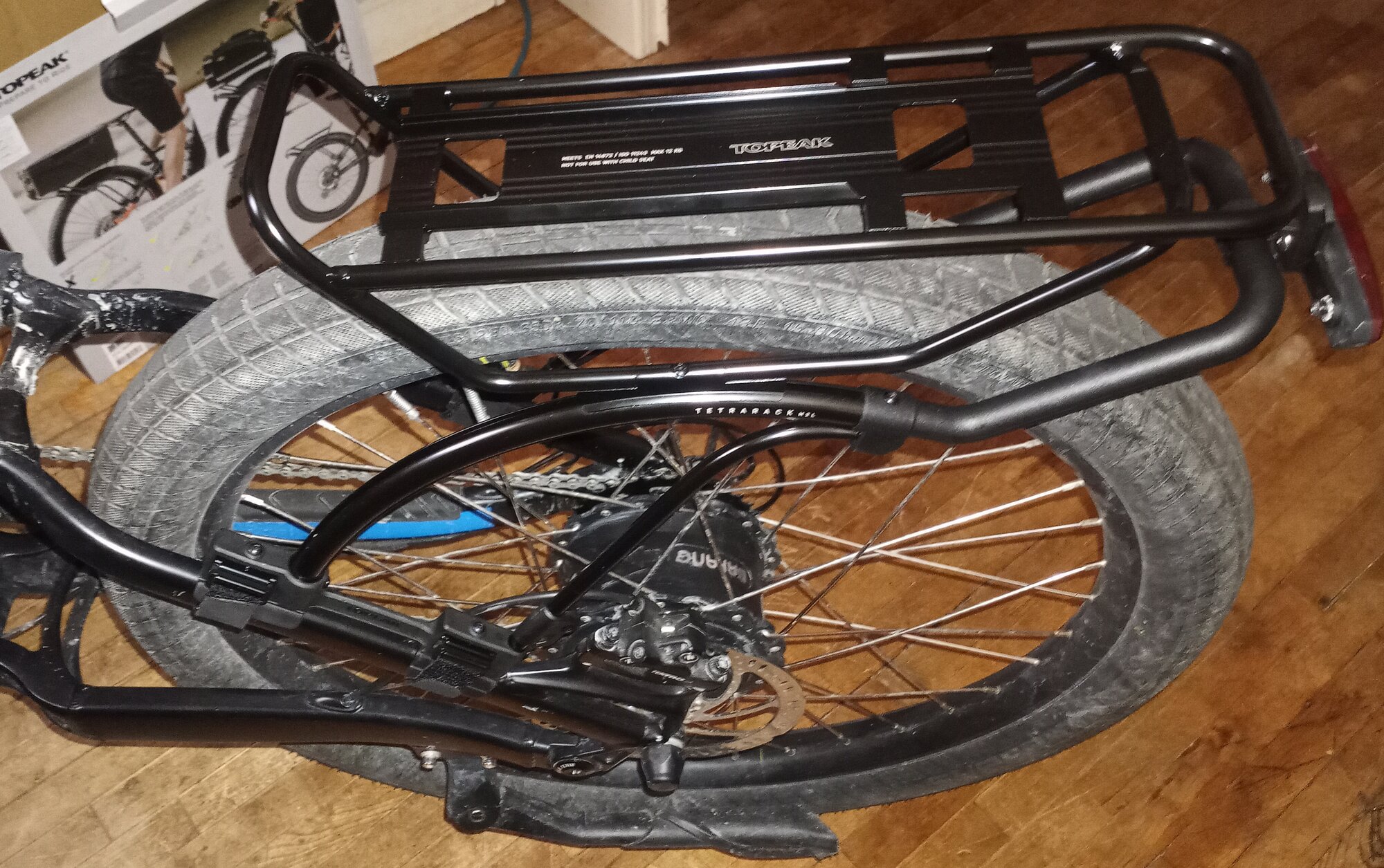

I thought that I'd at least try to attach it to see what happens.
IT FIT !!
I managed to just pull it apart while attaching the seat stay brackets, and everything fit nicely!!
It's even kinda pretensioned to help keep it stable, and the legs are spread out to ~200 mm so it's more stable that way too. 😂

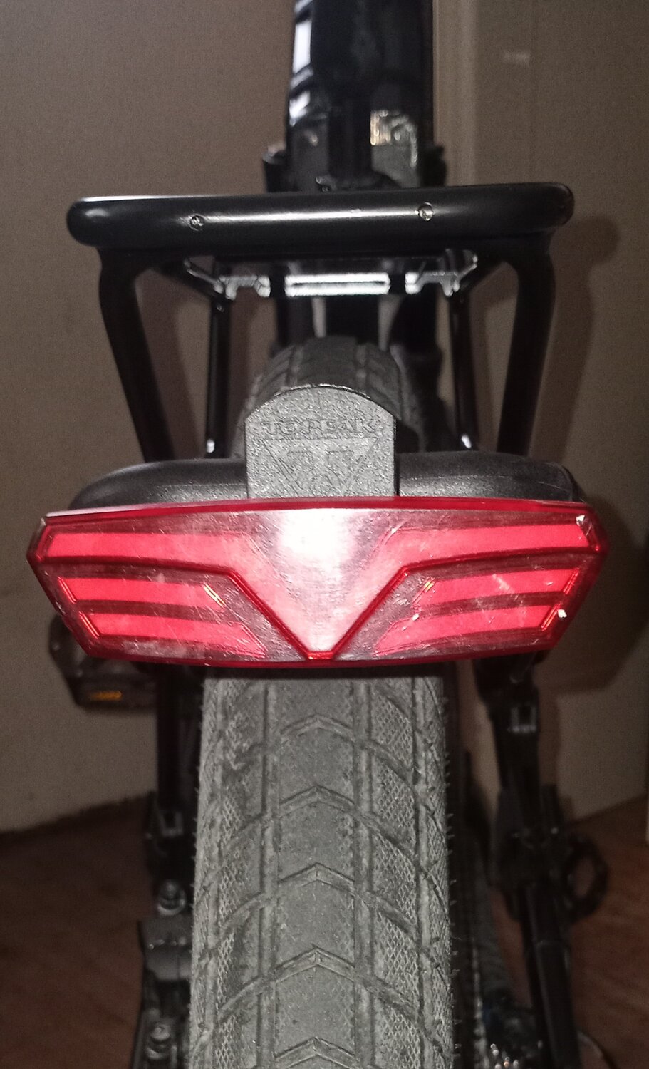

I managed to pull a few inches of extra brake light cable to attach the brake light.
I haven't tried it yet but I'm pretty sure it'll be fine.
It's only rated for 26 pounds, but I don't need it to carry anything near that weight with my second battery now mounted to my top tube.
