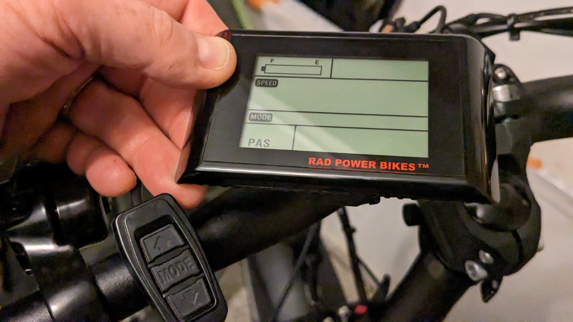

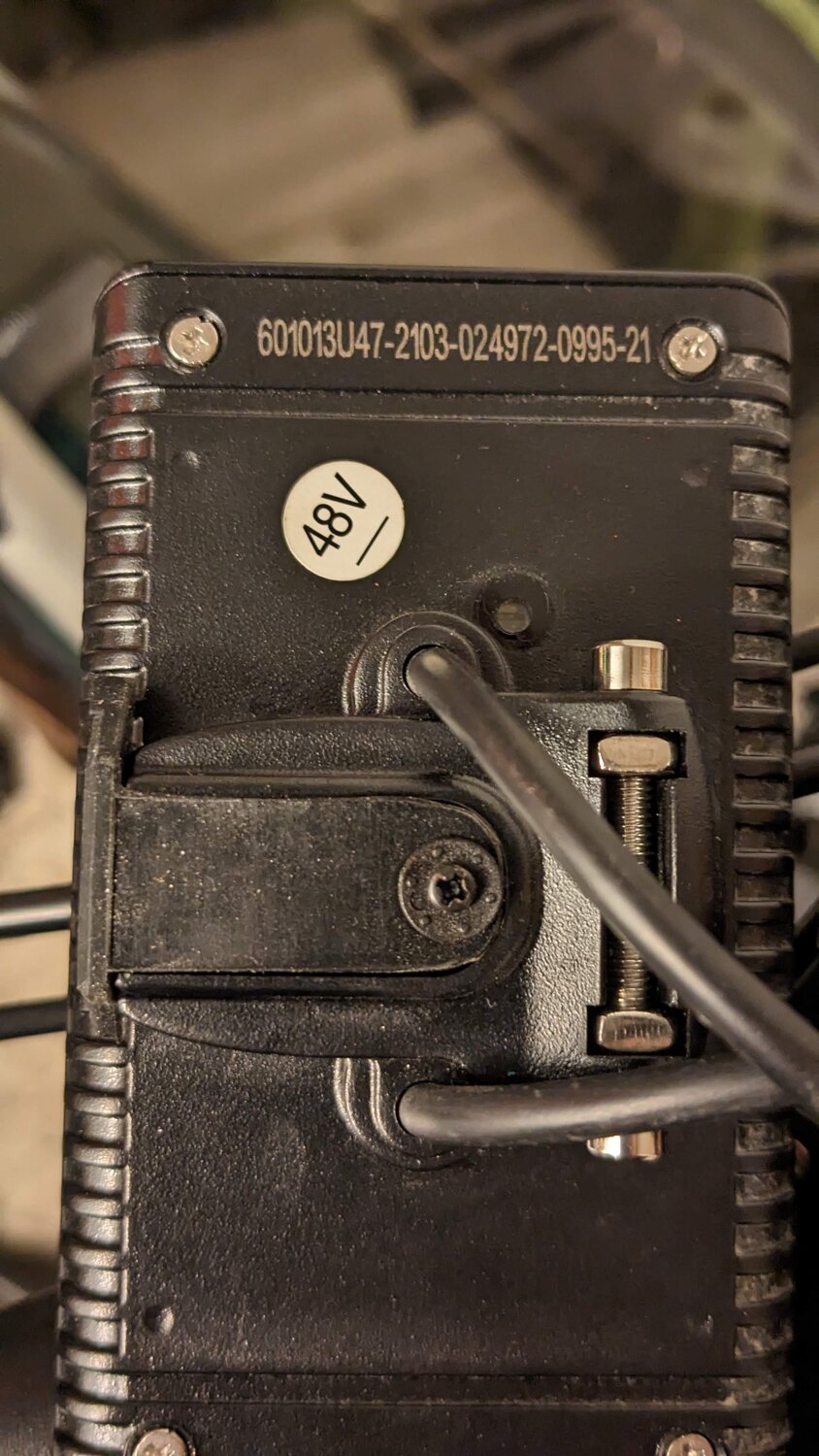

@kongrui1984 - any chance you're still here? i am attaching photo of my serial number on back of display for Rad Mini v4... Rad is asking $100 so wondering if i can go with any s900 i find (~$45 amazon right now) or if there's something special about Rad's? also wondering if there's any color options like the nice low profile Bafang "500c" I see out there.
