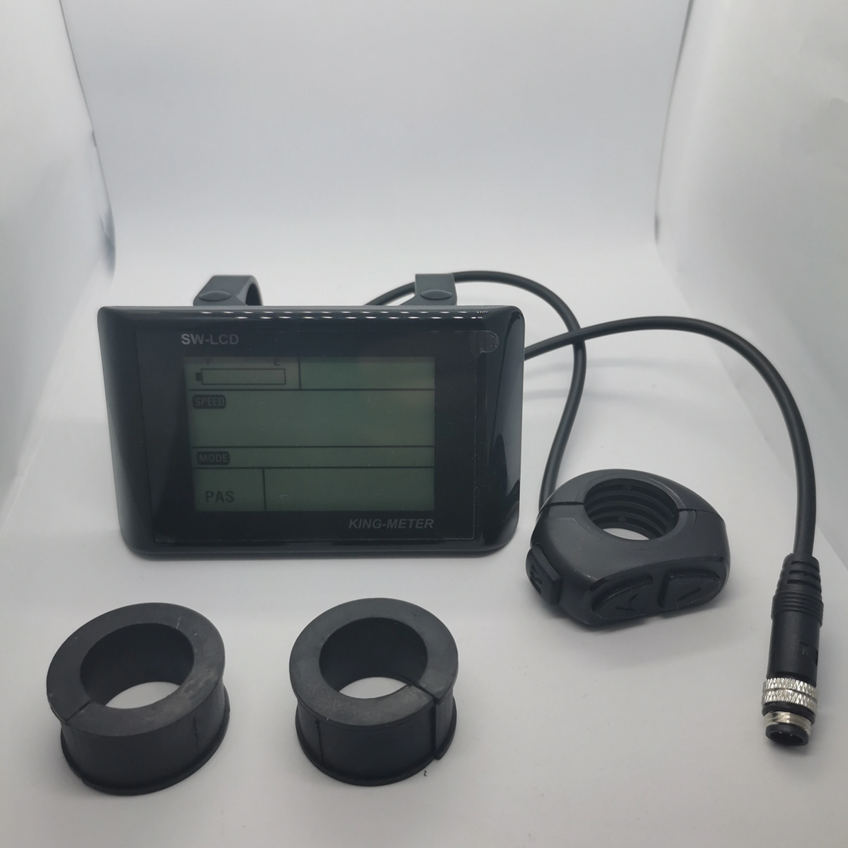

thanks yeah i awalys read threads top to bottom before i post questions as well as search for other threads and i was just looking for that extra solid confirmation and maybe find out some new info about color options since he works there... in multiple exchanges of this thread kongrui1984 confirmed the King Meter's are going to be compatible with RAD but what i'm finding on Amazon is not exactly the King Meter replacement with the metal screw on connector vs just the snap on that is typical for everything else ... and the exact King Meter SW-LCD out on AliExpress is $100 anyway and there are no other King Meter color models posted on Ali so it basically boils down to just going with what Rad recommends anyway. I'm in no real hurry since i just knocked the silly display firmly on bottom edge a couple times on the handle bar after taking it off to replace and it started working again LOL... i guess the old adage is true, one should always try hitting it with a hammer before giving up... i'm assuming it'll go out at some point and i'll order the RAD part.

@joel52402 - thanks for the tip... it's a bit more spendy than i was hoping but within reach and color is nice bump up... i'll definitely keep it in mind if mine fails... still a bit amazed that just knocking the existing display a bit brought it back to life and has been bouncing along fine since, still assuming that means something marginal will eventually fail... eggrider seems to be about the same price range... nice to know there are options.
