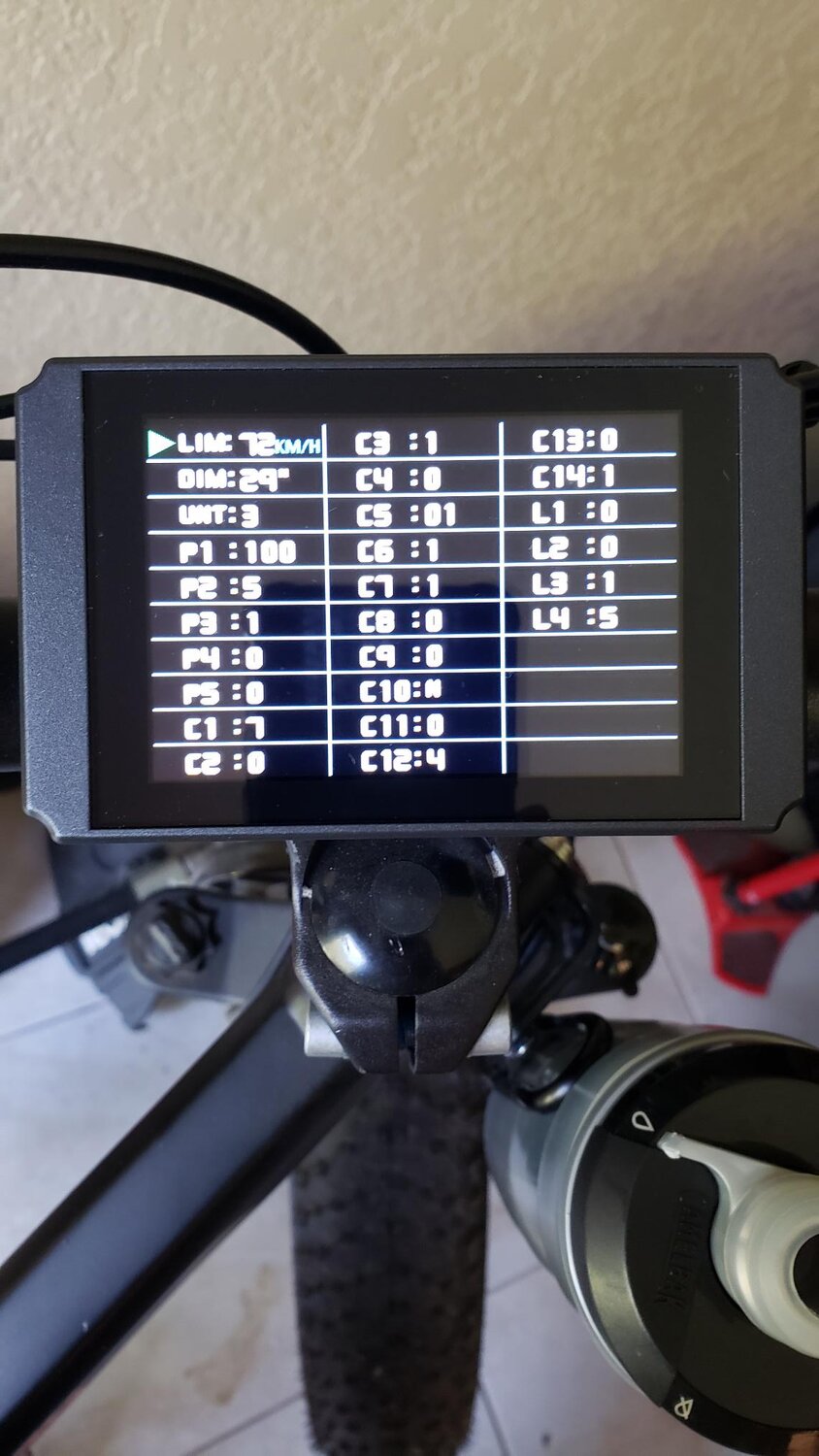

I installed the Upgrade kit last night on my 2019 Rad Rover and everything went well. I'm having a issue where its putting out to much wattage even on PAS 1. Its going over 100 watts even on PAS 1 and can't seem to get lower wattage even adjusting C5 to 1 and C14 to 1. On PAS 2 its going up to 300 watts which seems to high and my cruising speed is 17 mph and I'm barley pedaling. PA3 is just crazy fast and is almost like PAS 5 and goes 25 mph and I'm barely peddling. I had to change C1 to 7 because when starting to pedal it would take to long before the PAS would kick in. I've changed C1 to 1 just to make sure that's not what's causing the high wattage but that has no effect on why PAS 1 is using over 100 watts. I'm also on flat ground with no hills here in Florida. I was hoping I could dial in the wattage under 100 on PAS 1. I'm not sure what else I can try at this point.

In the manual I'm looking at, C5=01 and C5=02 are "undefined". C5=03 would be as low as you can go, and that value should cut available power in half. I doubt you'll need to go that low. I think I'm running C5=05 or C5=06 on my 1000w rig, and a little more more power (C5=10!) for the 500w rigs I run.
In any case, it takes some tinkering with C5 and C14 to get it right where you want it. Something just under 100w in PAS 1 is a good target for good low speed control. Worth the trouble to get it just right for sure.
PAS sensitivity (C1) is a matter of 'druthers. I like it set pretty sensitive for good low speed control in tight quarters, as in trail work.
Have fun, and don't be shy if you need a hand. There's a couple of us that have spent some time with these KT's. -Al

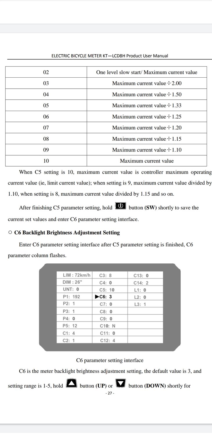

Thank you for the Info. I really appreciate the help! I Just found this from the PDF I downloaded from this forum. I attached the page. If I had C5 set to 1 I was getting maximum current. Thats why PAS 1 was going over 100 watts. I'll give it a shot tomorrow and and Adjust the C5=3 and go from there to see if it cuts the wattage down some.
I Just wanted to post a update. I changed C5 to =3 and it cut my watts almost in half in PAS 1. Its closer to Rads stock Controller wattage. PAS 1 is around 75 Max watts now and PAS 2 around 175 wattage max. I'm pretty satisfied with the settings on 3 but may go up to 4 or 5 after more testing. :)
There you go! You're off and running. Good job....
