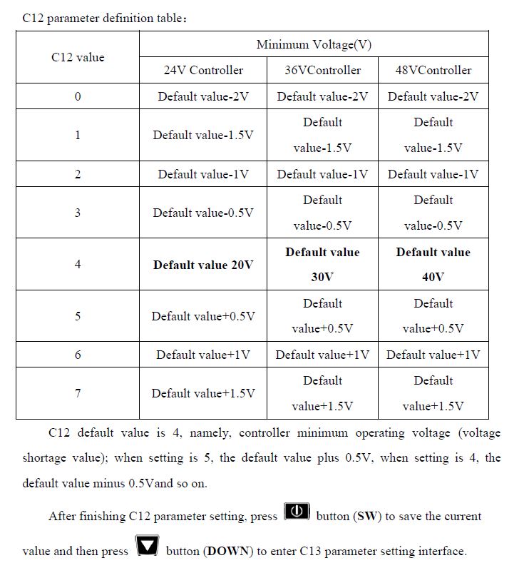

If you use PAS 5 or throttle with a Bolton kit the load will cause the voltage to drop immediately by about 5 volts. If you have only 46 volts remaining and cutoff voltage is set by default to 42v it will trip .
You can lower it to 38 volts, but expect some criticism here.
I use 38 v but don,t use throttle or PAS 5 below 44 volts. Emergency application only.
Might sound like a dumb question but what is the risk/criticism of lowering to 38v and using pas5? New at this.
Bolton recommends a cutoff voltage of 40.0 volts, which is what I use. I discharged the battery below that point once to see what would happen. After about 5 minutes of seeing 39.something apparent voltage the Bolton controller shut off the motor, but not the lights or the display. Pedalling without power for a few minutes, then power cycling the controller restored motor function for the remaining half-mile back home.

C12, 52 volt is not listed in the table but assume it works the same way.
Would it be appropriate for me to set C12 to (7) +1.5 when using a 52 volt battery so it does not draw down to 40? I answered that myself! Battery management system takes care of draw-down and shut me down before I expected. I got quite a workout.
