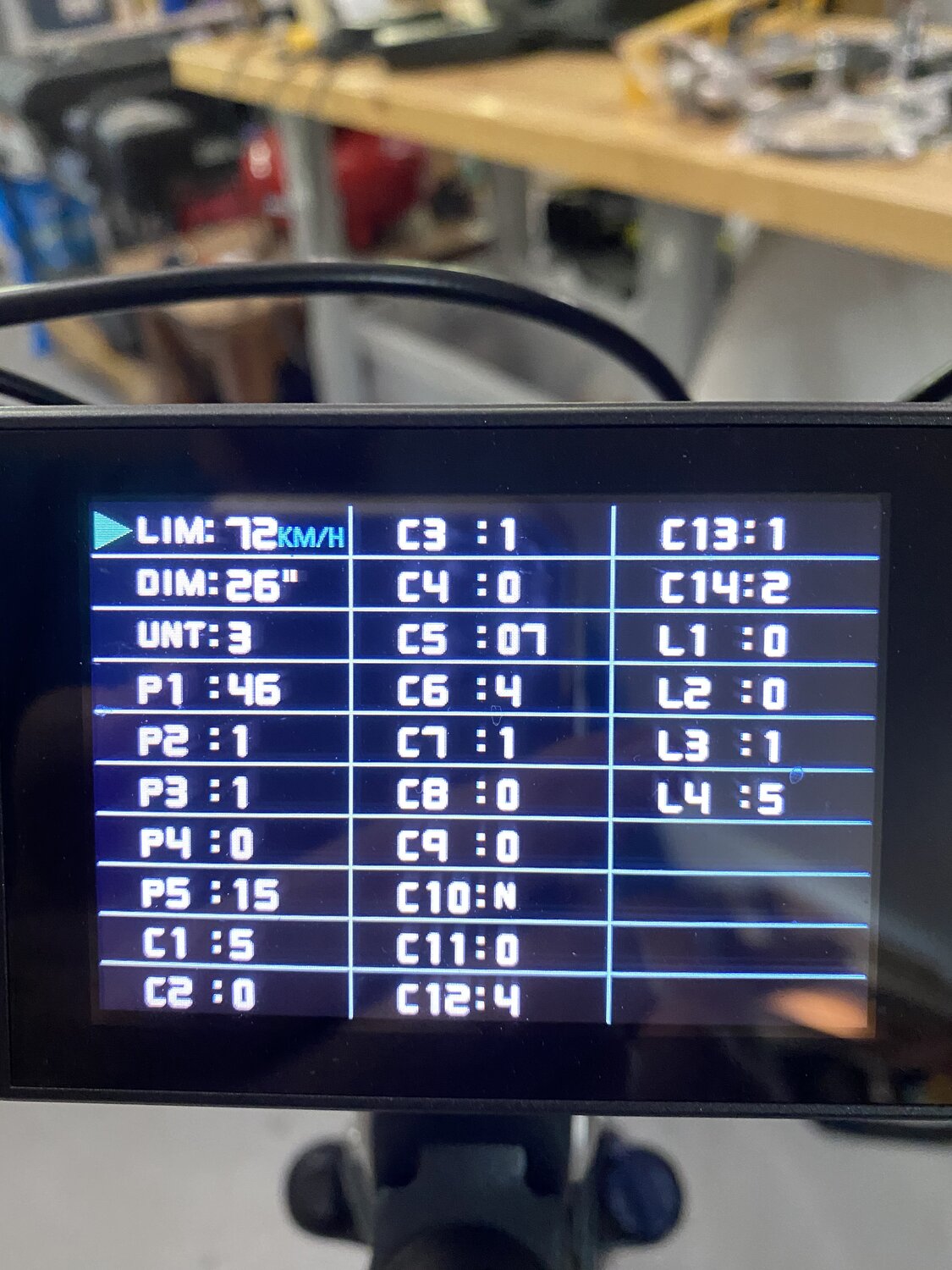

What year is your bike? Rad increased the PAS magnets up to 12 I think for 2019 models because mine has 12. The firmware reacts better with more magnets assuming the settings are right.
Settings for 2019 Radcity
My bike is an early model, I think 2016, but I have tried both a 6 magnet and a 12 magnet. Since this is a thread for the upgrade kit, I am assuming you installed the kit in your bike. If so, it is acting like it should and something is wrong with mine
