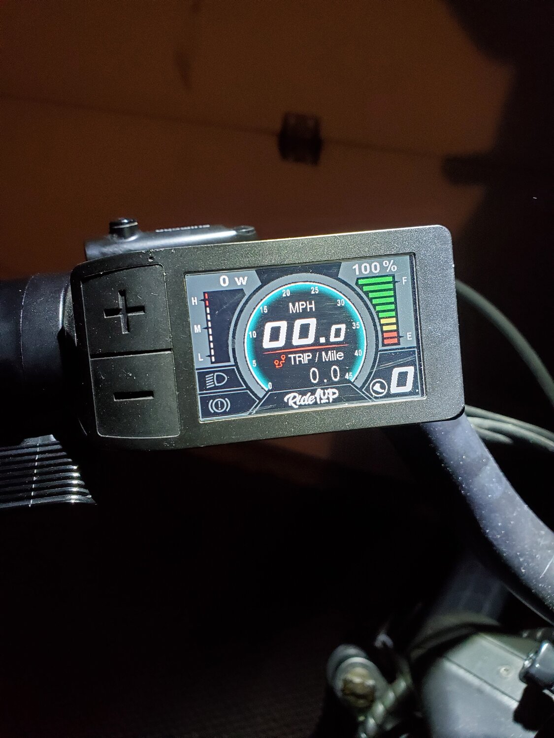

Hi, all. I just recently upgraded my controller and display to this. On my 700XR, the existing controller and display function fine, I was just looking for a bit more power for the hills near me and to have a more reactive throttle when taking off from a stop. I've heard a lot about how flexible KT controllers are and they are very nice. I didn't want anything crazy, dangerous, or (street) illegal, so I went with this kit. This controller fits just fine in the same area, below the battery, where the existing controller was. The display is very nice and I have lots of options. After using this setup now, for about a week, I can tell that the throttle is more responsive than the old system I had. For now, I've set my C5 setting to 8, which gives me the same max amps (22) as the previous controller. Closer to 1000 watts. I know that many that upgrade their controller would max it out, but I don't want to harm my motor. I did see that video of the guy that upgraded his with a 40a controller and that tells me that i can probably open the controller up to use the 25 max amps from this CSC kit and my motor would still be ok.
If anyone is looking for a replacement for their 700 series, this is a great option. The reason I went with this kit was, the controller isn't (physically) much bigger than the stock one, so it fits neatly. Didn't have to externally mount it. It's only $80 USD. A nice perk was this LCD8H came with a usb port. I can run some lights or whatever usb thingy I'd like. The install was pretty easy, I just had to replace the 6pin connector for the hall sensors and flip/transpose the throttle negative and signal wires. Much to my shock, the phase wires and hall sensor wires all matched up by color. I've read that, usually, these need do be tested by trial and error to get the right combo for the motor to work properly.

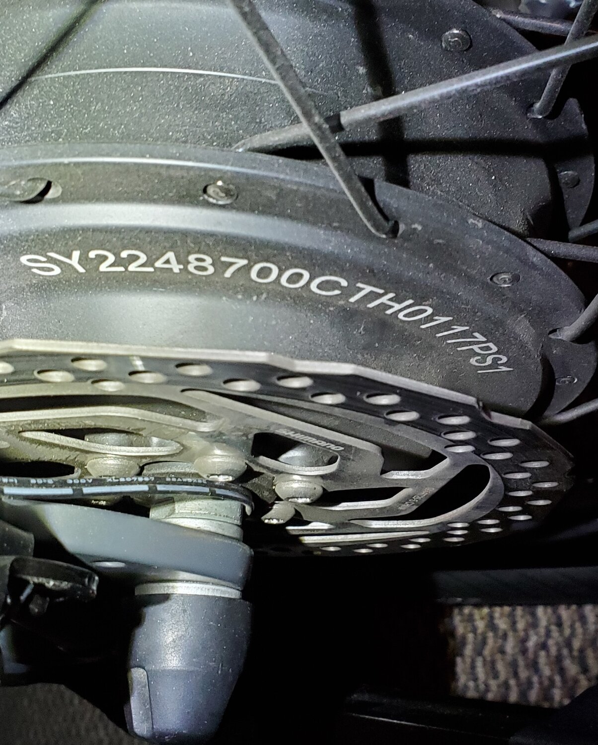

As long as they have the same motor, it should work. My motor shows “SY2248700CUL3030PS1” printed on the side. It’s a Shengyi. Yours may be similar.

My motor shows SY2248700CTH0117PS1. Not sure whether to give the different controller a try since I have one of the earliest versions.

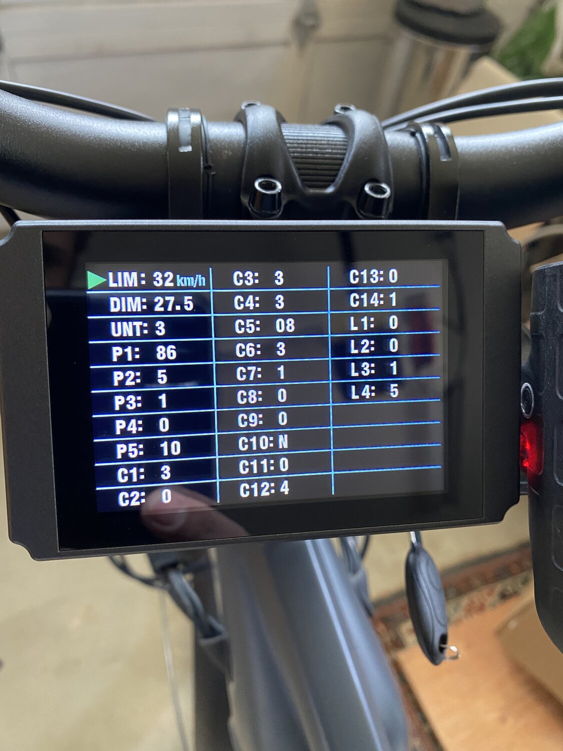

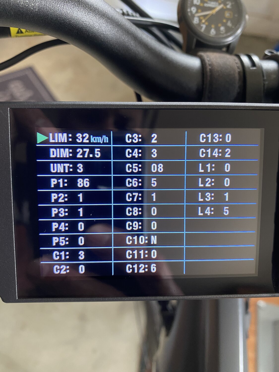

Still riding on this same kit. These are my most current settings.
Finally, I think I’ve got it set up good.
