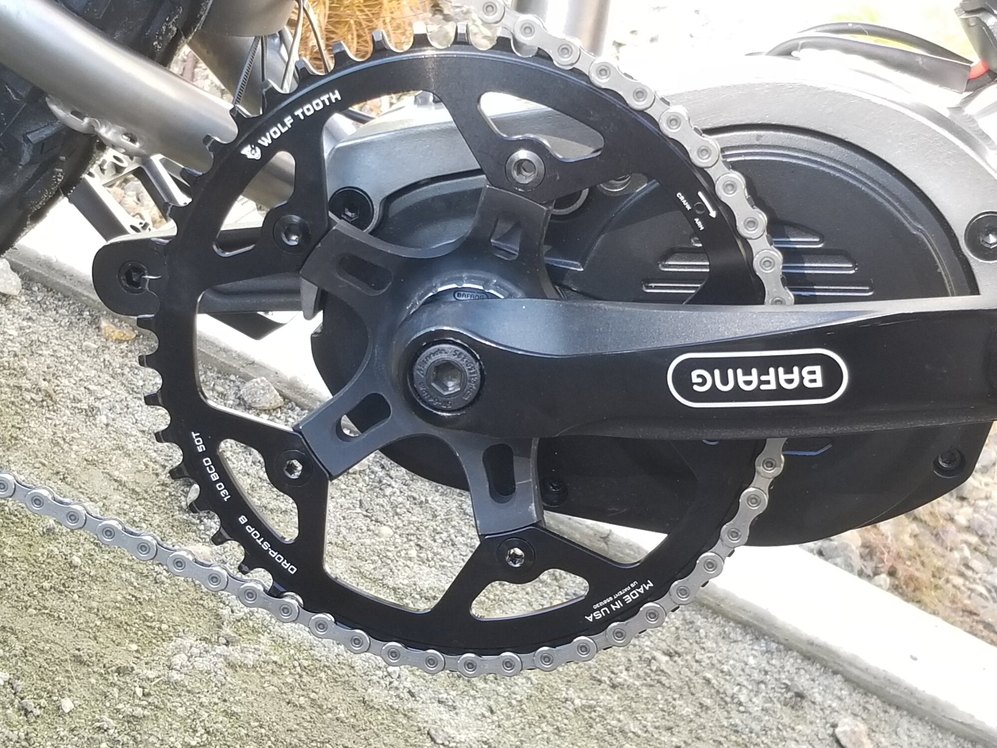

I hear ya and just installed a 50T 130BCD WolfTooth on Gumbo Dacious - closing on 100miles riding - before this storm (It snowed in San Diego Campo area right on the US/ Mexico border. Ugh).
For the Lm'td I found these Decas Ring Gears are inexpensive ($15) and last well.
It should list the sizing on your present ring. If not: Here's a link on how to measure the ring.
I so concur. It's an economical, simple improvement. I'd dare say for any terrain the Lm'td is meant to run.
A 48T, while it won't make the bike faster, improves the Lm'td where you have to pedal less and the gearing is less tilted towards vertical terrain.

Yes, a 48t will be slightly taller. I advise against offsetting, changing the chain-line. Everything I read says it causes excessive wear and (often/ sooner or later) causes shifting problems. I've seen the effect in other applications.
A steel chain with a new (crooked) angle of contact at the interface of the gears; chewing up the alloy ring/ increasing chain wear on steel cogs - will seek to fit by abrading into that groove.
If the chain wears, next up is the derailleur. All these parts are relatively inexpensive, but IMO: still an expensive compromise to use a larger ring that won't make the machine any faster (ie: Bang for the buck).

I couldn't discern if a 48T would fit the Lm'td until I tried it.
Contrary to online instructions, I didn't have to increase the chain length with the Lm'td (44T to 48T, or with Gumbo (46T to 50T).
My only problem was finding a bash plate/ chain-ring guard for the 48T. You won't have that.
Here's the 50T on Gumbo
It made a 9% Difference.
Next up (1000miles down the road), installing a two-link longer chain and a 52T Ring.

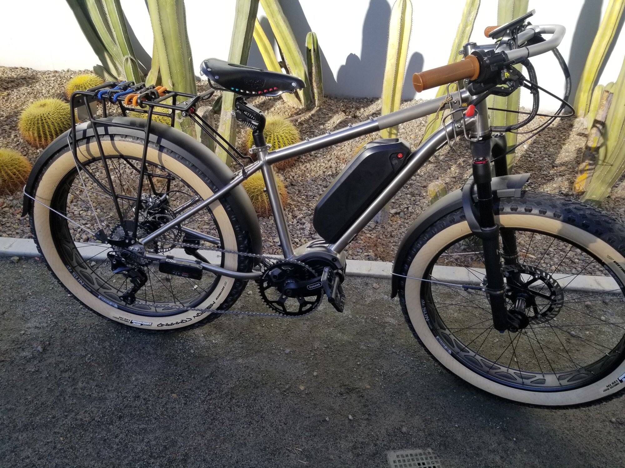

I’m still sold on this simple cadence rear hub bomber of an ebike. Takes more than a “thermal incident” to dampen my enthusiasm. Now that I’ve dialed in my PAS, it’s a fast flat-landers dream bike.
I’m glad you advised against a chain line offset, as I had considered it. Interestingly, the R1U chainring FAQ suggests requesting a 45T ring when ordering the LMT’D. I’m not sure why; 1 tooth seems insignificant on a sprocket that big.
I also want to thank you for reminding me; the bike is fine just the way it is. In fact, I think I should be finding ways to use the low gears instead of trying to make the front ring 4 friggin teeth bigger. Maybe I’ll take up trials riding. Onward and upward…
Certainly Yank.
The new, titanium bike has amazing potential. I'm waiting on the programming cable from Germany to beef up 'Economy Level 1' slightly and make it perfect. Eco L2 (>160nm), I hit for long hills. Sports Mode's L1 - L3 ( +200nm), I've no idea what to use for. Maybe doing wheelies - for a block ? Both Cadence and Torque Sensor are programmable, so it's all on me, creating (and verifying) the profiles. Tinker, tinker.
