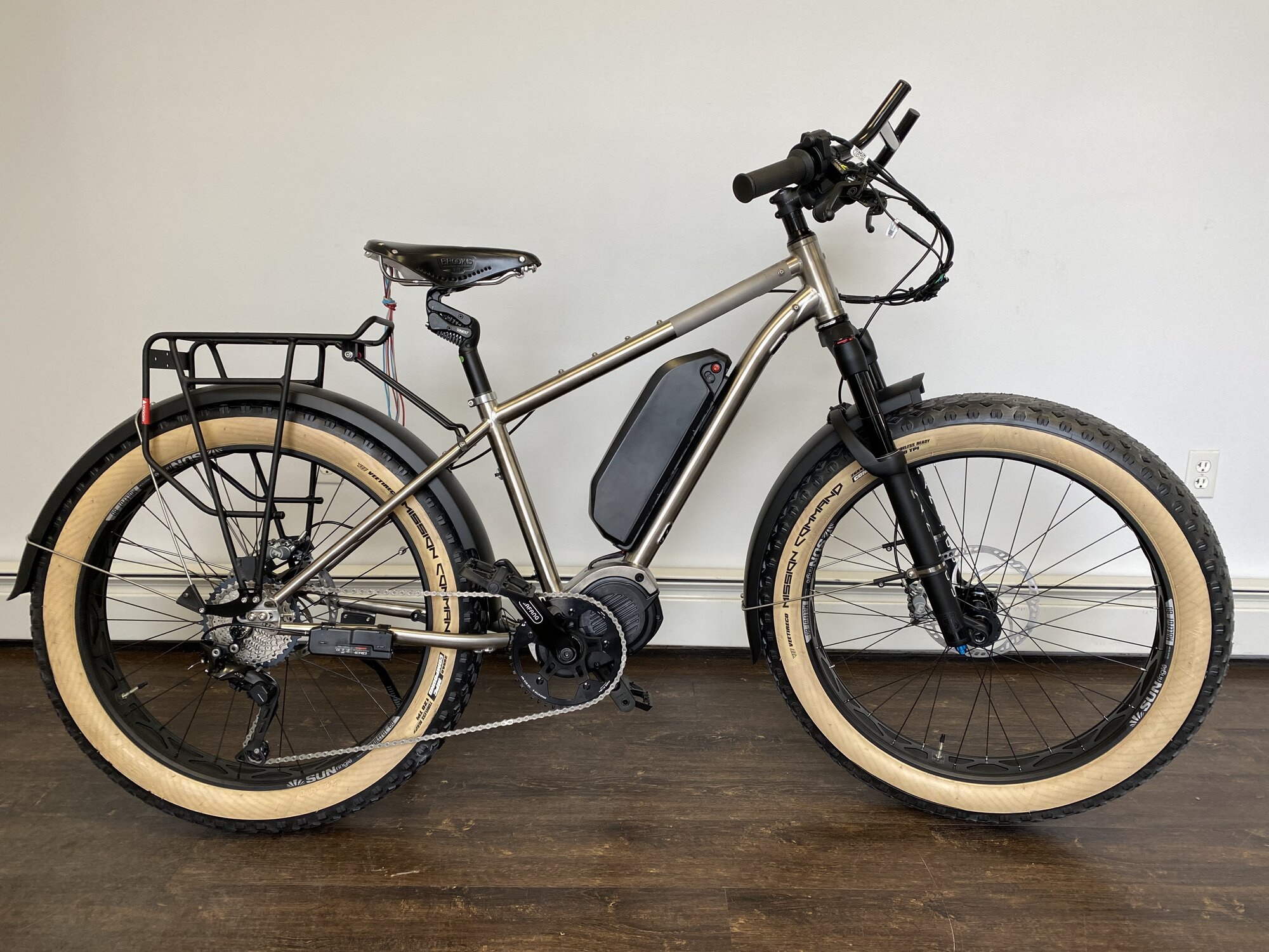

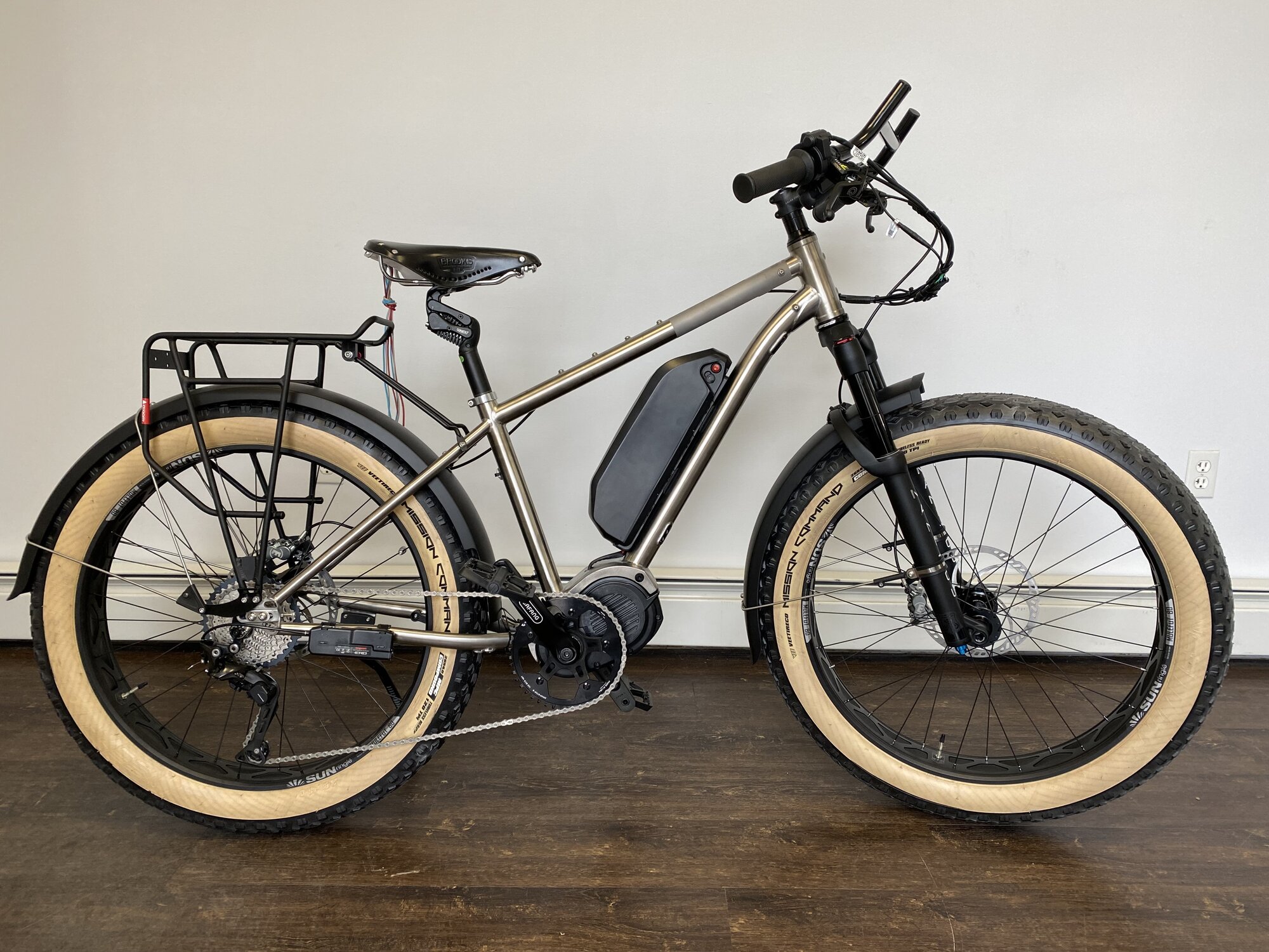

Here's my custom, WattWagon titanium CrossTour fattie.

The new bike looks great, kinda retro and I imagine a big step-up from the LMT'D.
This has certainly been a learning experience, mainly 'cause the LMTD frame has so much wiring crammed inside. Fairly simple when most of the wires are color-coded, just physically frustrating when my fingers don't fit inside the workspace. I know you know all about it. The new stator motor's not here yet so I'm not counting my chickens, but so far so good.

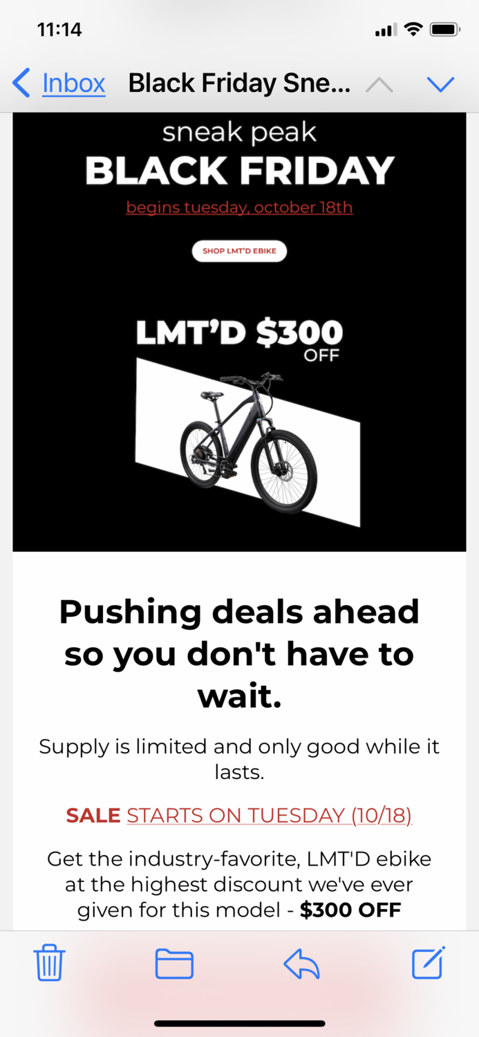

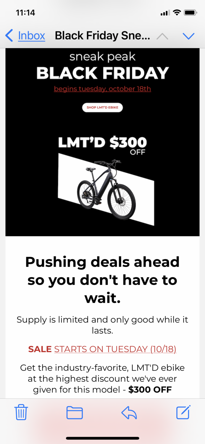

And I see they are dropping the LTD's price for Black Friday starting October 18th. Great deal.

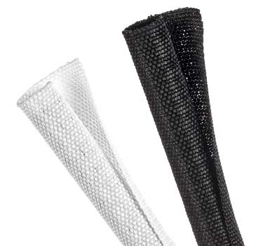

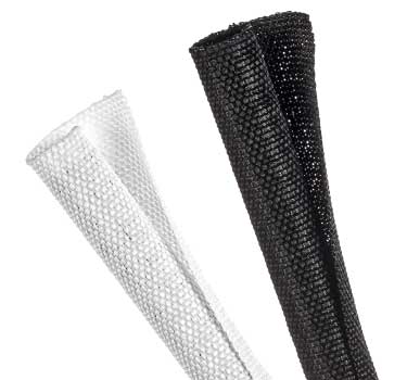

Another must have item we all need is good lookin', non-labor intensive Harness Sheathing.
I'm using this:
F6 Woven Self Closing Wrap.
My new bike's a titanium frame mid-drive. You can see a video here: WattWagons Information
A small shop, from builders creating custom bikes. Worldwide trade madness is killing them and I've no idea how the finagled a frame for me, just that it's a real solid. I'd ordered a Kindernay IGH and Gates Belt drive but that's not, and this cassette was available.
here's the specs.
Motor: Bafang M620 52V X1 2300W - I run 750watts for the street.
Battery: Jumbo Shark 52V 16ah
Throttle: Domino Twist Grip 0-5K Ohm Throttle, Standard Firmware Profile

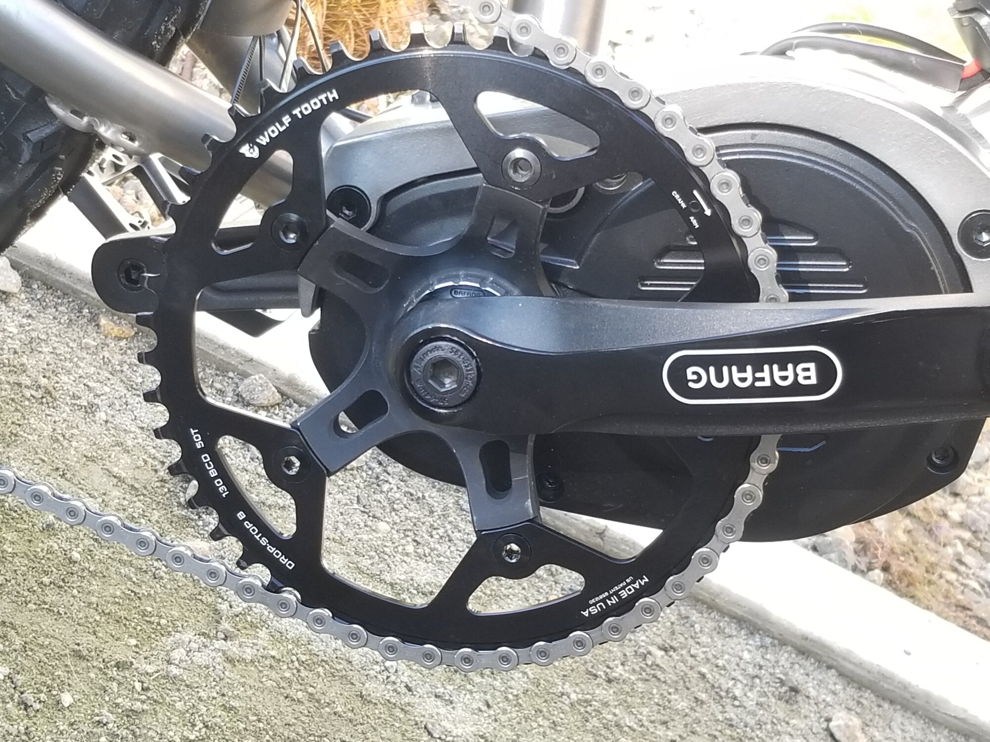

Drivetrain: Shimano XT 11-speed, 46T Front Chainring, 11-40 Rear Cassette
Shifter: Wireless, Archer D1x
Rims: SunRingle Mulefut 80 26” w/ Vee Mission Command 26x4.0" Tires
Front Suspension: Manitou Mastodon Pro
Brakes: Magua MT7e . Rotors: Magura MDR P 220mm (F), 203mm (R)
Handlebar: Jones Butted H-Bars
Stem: Custom Titanium 80mm
Grips: Domino Gum rubber
Kinekt 31.6 Suspension Post. Brooks B17 Saddle. Crank Bros Stamp 1's. Axiom Rear Rack. SKS Fat Fenders
I've slimmed the build down. Omitted lighting. Installed alloy bars. It's lighter than they talk about, notably lighter without the 10lb battery than my Lm'td. I'd say 58 - 62lbs w/ battery.
I'm expecting having real fun!
It's 'space-age retro' theme. lol
Ride on !!!
I'm using this: View attachment 137959 F6 Woven Self Closing Wrap.
here's the specs.
Ride on !!!

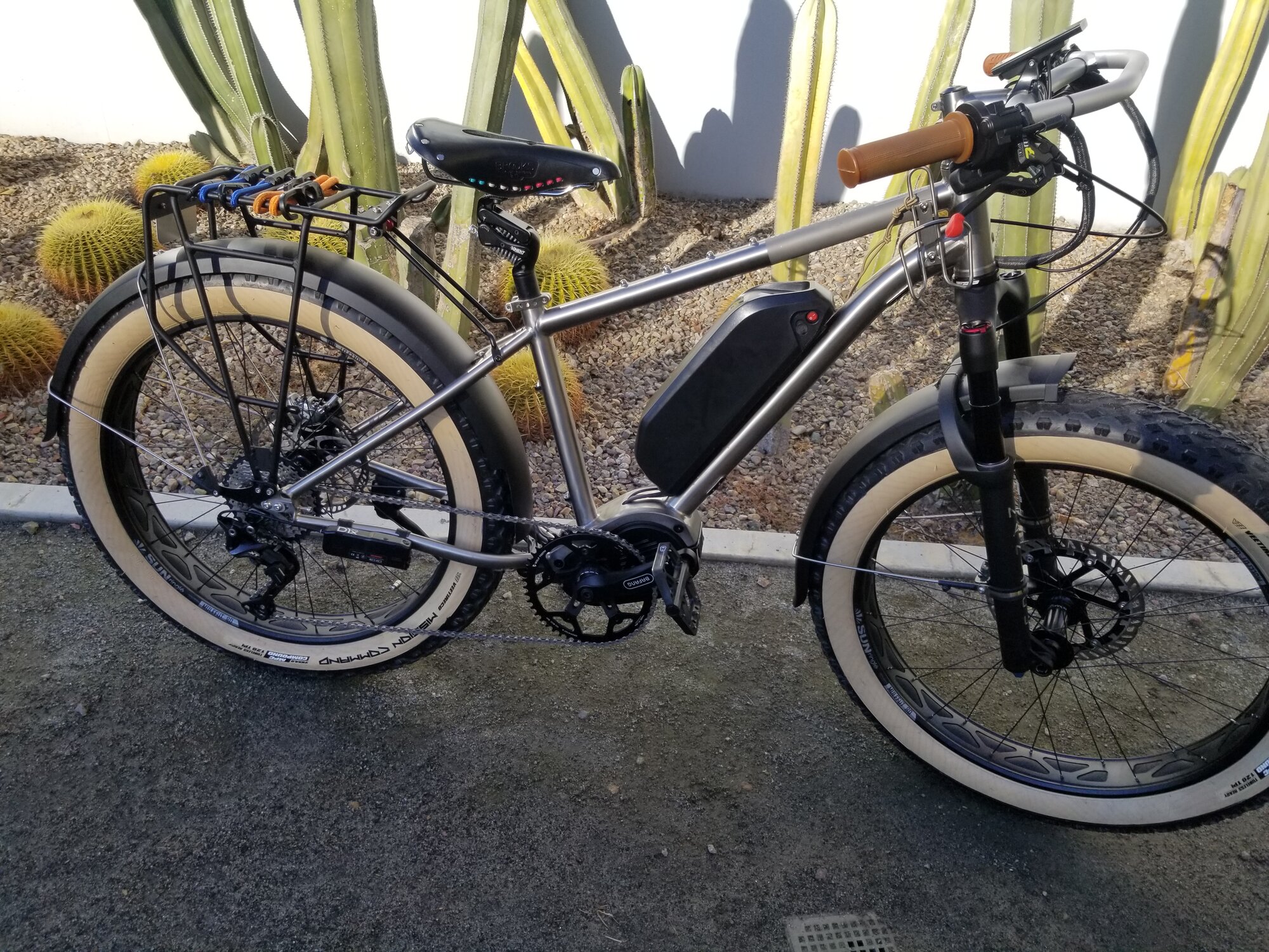

What a great bike! You'll have lot's of fun on that one for sure.
My new stator motor is due this coming week so I removed the rear wheel and will take the motor apart as soon as I can figure out a safe way to remove the stator cover screws, which are apparently installed with LockTite and a bitch to remove w/o stripping the heads. Also had trouble loosening the torque arm on the cable side, as it abuts the derailleur mounting-bolt very tightly. Now that the wheel is off, I think I may dremel the edge of the TA so that it fits w/o rubbing that bolt. If anyone has an opinion on the best way to remove frozen phillips without stripping them, I'm all ears. Right now they're soaking-in some WD40. I have an impact driver but hope I don't have to resort to it.
The first thing you need is real estate on your bars. The Jones H-Bar SG Loop provided that and better geometry, but I still found the cockpit cramped, even with my saddle as far back and as high as possible.
I added an 80mm bar stem, centering the the grips position on the axis of the fork tube by replacing the stock 45mm clamp. It depends on how you ride, more upright or less so; your height and the length of your legs.

I've been mulling over adding a 48T chain ring and was going to order the same ring that you used, then I noticed that yours was a 4-bolt pattern but mine is 5. I emailed R1U tonight, for some BCD advice.

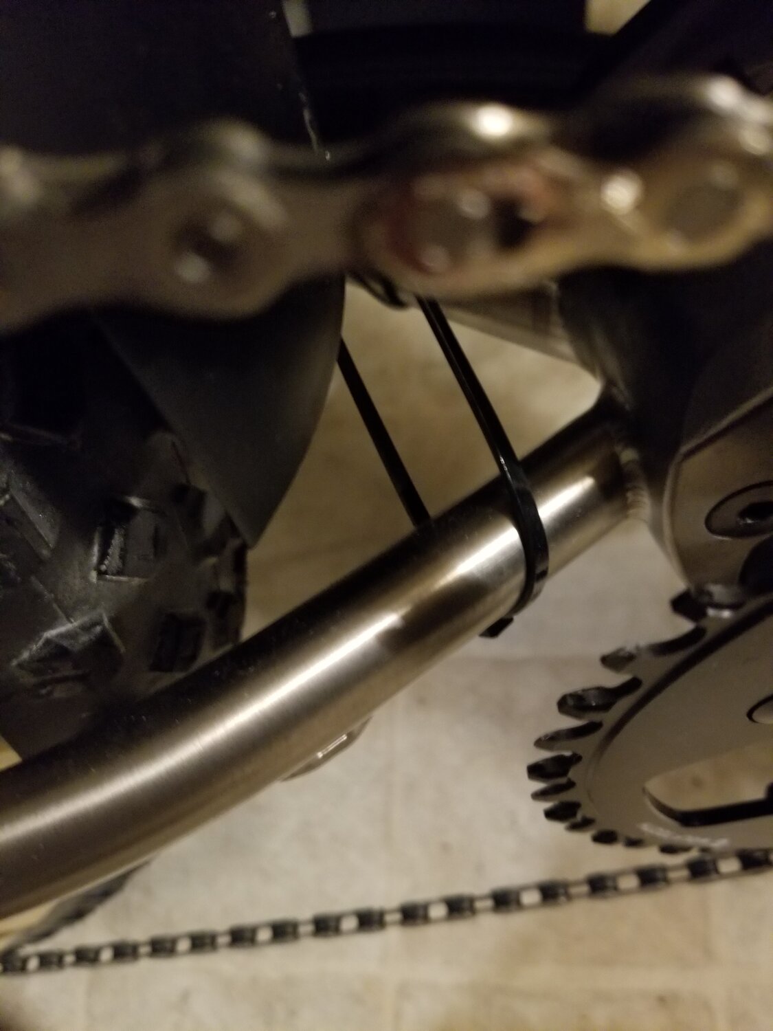

I also notice there is only about 1/4" of clearance between my stock 44T chain ring and the chain stay, so I hope my new ring is not any taller than the one you got. Hopefully 1Up customer svc has heard this query before . There's nothing wrong with the stock gearing but IMO it's too low for someone that rides on flat topography most of the time.
I hear ya and just installed a 50T 130BCD WolfTooth on Gumbo Dacious - closing on 100miles riding - before this storm (It snowed in San Diego Campo area right on the US/ Mexico border. Ugh).
For the Lm'td I found these Decas Ring Gears are inexpensive ($15) and last well.
It should list the sizing on your present ring. If not: Here's a link on how to measure the ring.
I so concur. It's an economical, simple improvement. I'd dare say for any terrain the Lm'td is meant to run.
A 48T, while it won't make the bike faster, improves the Lm'td where you have to pedal less and the gearing is less tilted towards vertical terrain.

Yes, a 48t will be slightly taller. I advise against offsetting, changing the chain-line. Everything I read says it causes excessive wear and (often/ sooner or later) causes shifting problems. I've seen the effect in other applications.
A steel chain with a new (crooked) angle of contact at the interface of the gears; chewing up the alloy ring/ increasing chain wear on steel cogs - will seek to fit by abrading into that groove.
If the chain wears, next up is the derailleur. All these parts are relatively inexpensive, but IMO: still an expensive compromise to use a larger ring that won't make the machine any faster (ie: Bang for the buck).
I'm sure you're studying up - and BTW, Big Congrats on repairing that MXUS!
Nothing on that machine is even slightly beyond your ability.
I couldn't discern if a 48T would fit the Lm'td until I tried it.
Contrary to online instructions, I didn't have to increase the chain length with the Lm'td (44T to 48T, or with Gumbo (46T to 50T).
My only problem was finding a bash plate/ chain-ring guard for the 48T. You won't have that.
Here's the 50T on Gumbo
It made a 9% Difference.
Next up (1000miles down the road), installing a two-link longer chain and a 52T Ring.
That's the 46T. I've got the space.
