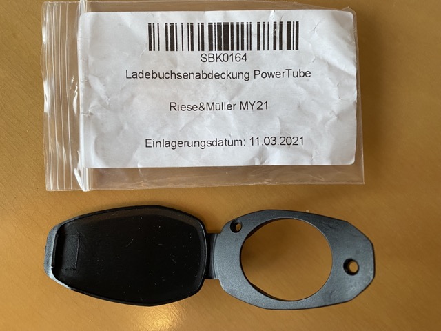

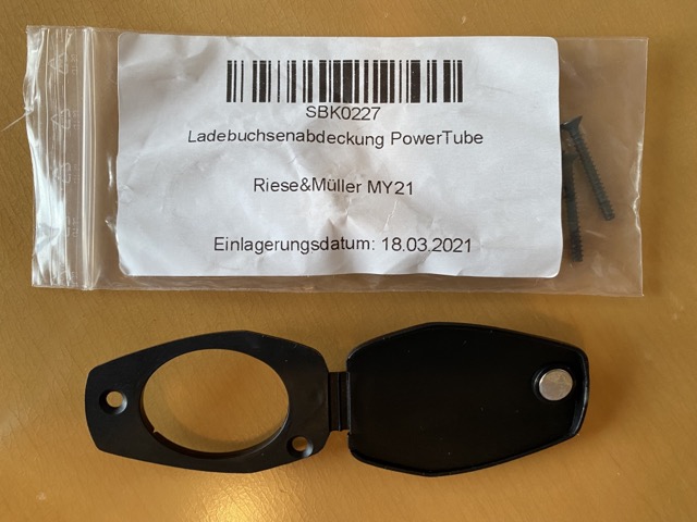

Well, my ever obliging dealer gave me (freebies) four spare charging port covers for my 2020 Superdelite - two of the original design (p/n SBK0164) and two of the slightly newer design (with magnetic catch, p/n SBK0227).
This afternoon I installed the cover with the magnetic latch, with high hopes. Nope - more disappointment! While, off the bike, the cover magnetically engages with the lower mounting screw and closes with satisfying security, on the bike it simply does not stay closed. It immediately pops open to about 90º, ready to be demolished by the first pedal stroke! Worse than the original!
Yep, the problem is the lack of an actual hinge - plastic generally doesn't fold well. If this hasn't been solved by the time I get to Europe in the summer, I may order a few for delivery to my hotel as a community service... 😅
