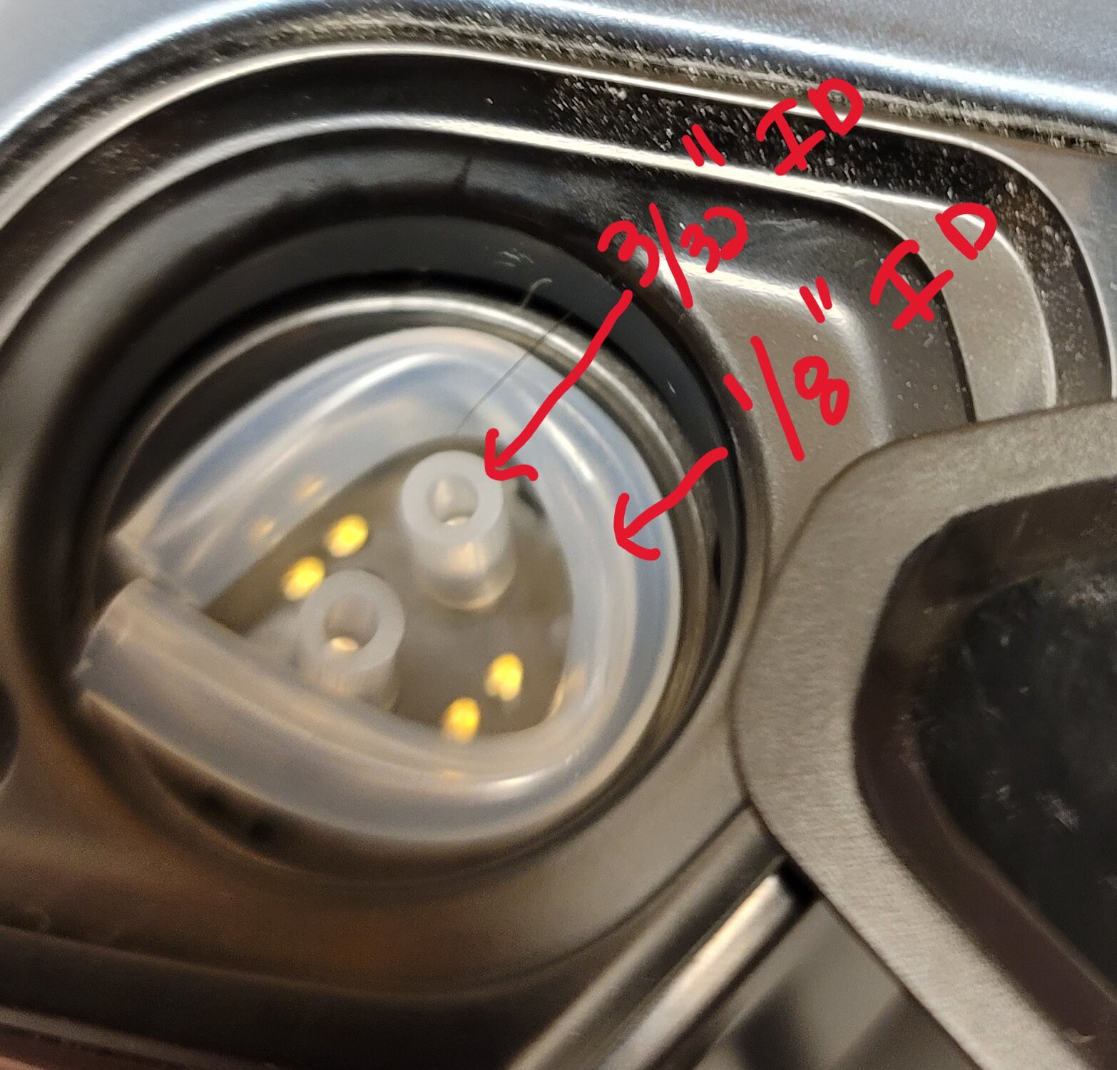

I purchased 2 different sizes of silicon rubber tubing, one with 3/32" (2 mm) inner diameter and the other with 1/8" (3 mm) ID and 3/16" (5 mm) outer diameter. It's possible that some people might have these sizes of silicon tubing in their homes. Tubing like this might be used in fish tanks, water fountains, or therapeutic oxygen concentrators. I didn't happen to have the precise sizes I needed so I purchased mine from Amazon.
For the 3/32" ID tubing, the small inner diameter is important for the application. For the 1/8" ID tubing, the ID and OD are less important, but probably can't be too big. I found the 1/8" ID tubing worked for my application
I cut the 3/32" ID tubing into roughly 1/8" to 1/4" (~3 mm - 5 mm) in lengths and the 1/8" ID tubing into roughly 2" (~5 cm) lengths.

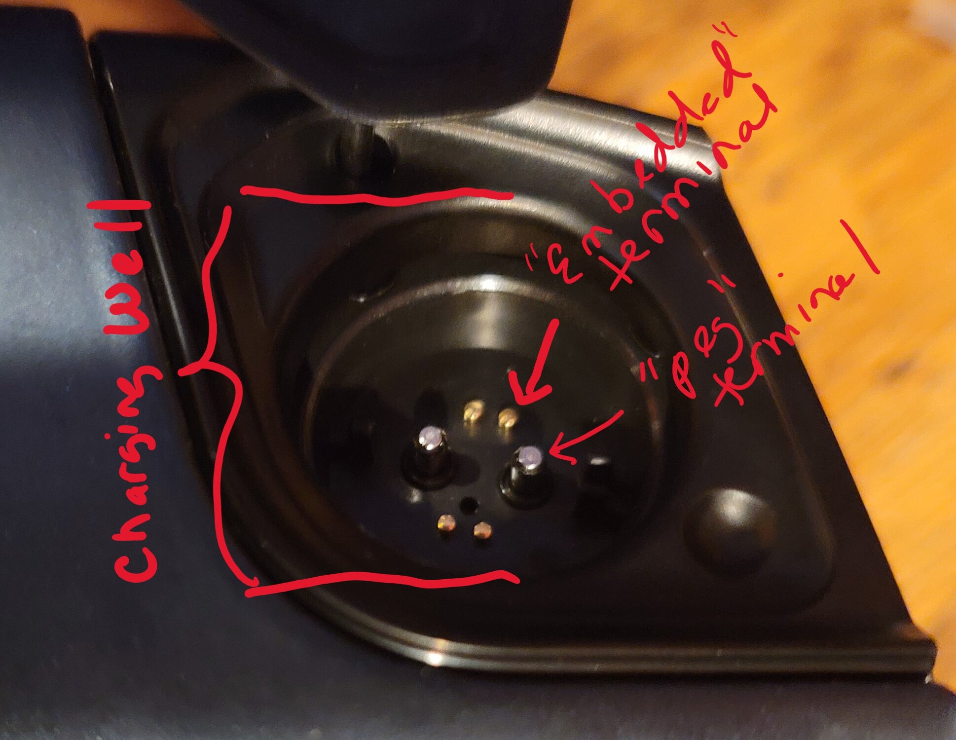

I'm a little fuzzy on the precise technical names for the parts of the charging well so I made up my own terms. See the photo for clarity.
To prevent accidental touches of the "peg" terminals that protrude into the charging well, I placed a section of the 3/32" ID tubing over each "peg" terminal. The 3/32" ID tubing fit perfectly and stayed in place.
To prevent accidental touches of the "embedded" terminals that occur in the base of the well, I curled a 2" section of 1/8" ID tubing into a circle and placed it inside the charging well between the walls of the well and the "peg" terminals. As an alternative to the section of curled 1/8" ID tubing, I'm trying to find a flat silicon or rubber washer (like a faucet or garden hose washer) that will lie flat in the bottom of the well and more completely cover the "embedded" terminals.
When the tubing is in place, the magnetic well cover seats and holds. I rode 21 miles this morning on a moderately bumpy trail. Both the well cover and tubing stayed in place during the ride.
My rule for applying the fix is: If the battery is not connected to the charger, the silicon tubing pieces are in place. Always. No Exceptions.
