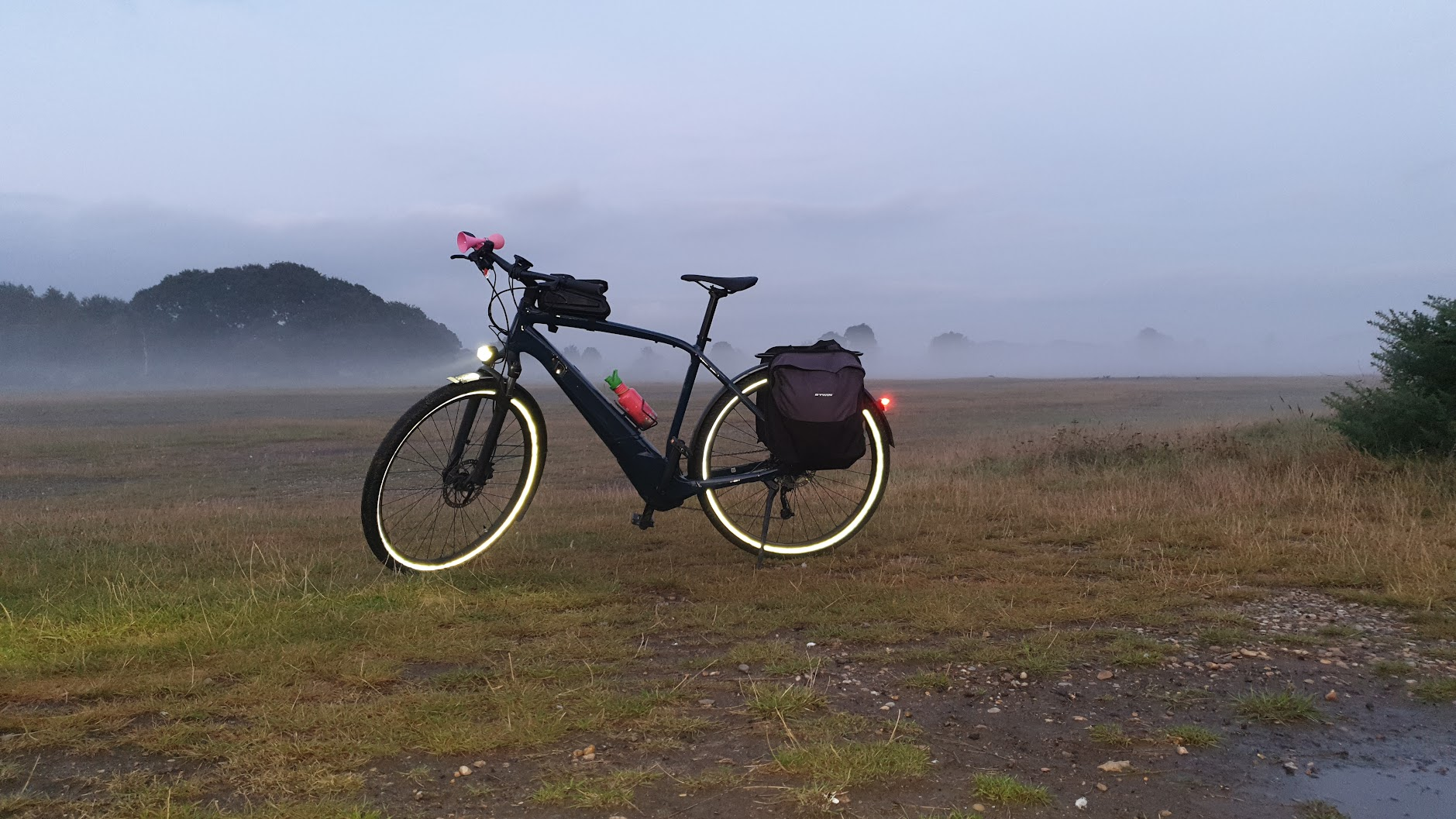

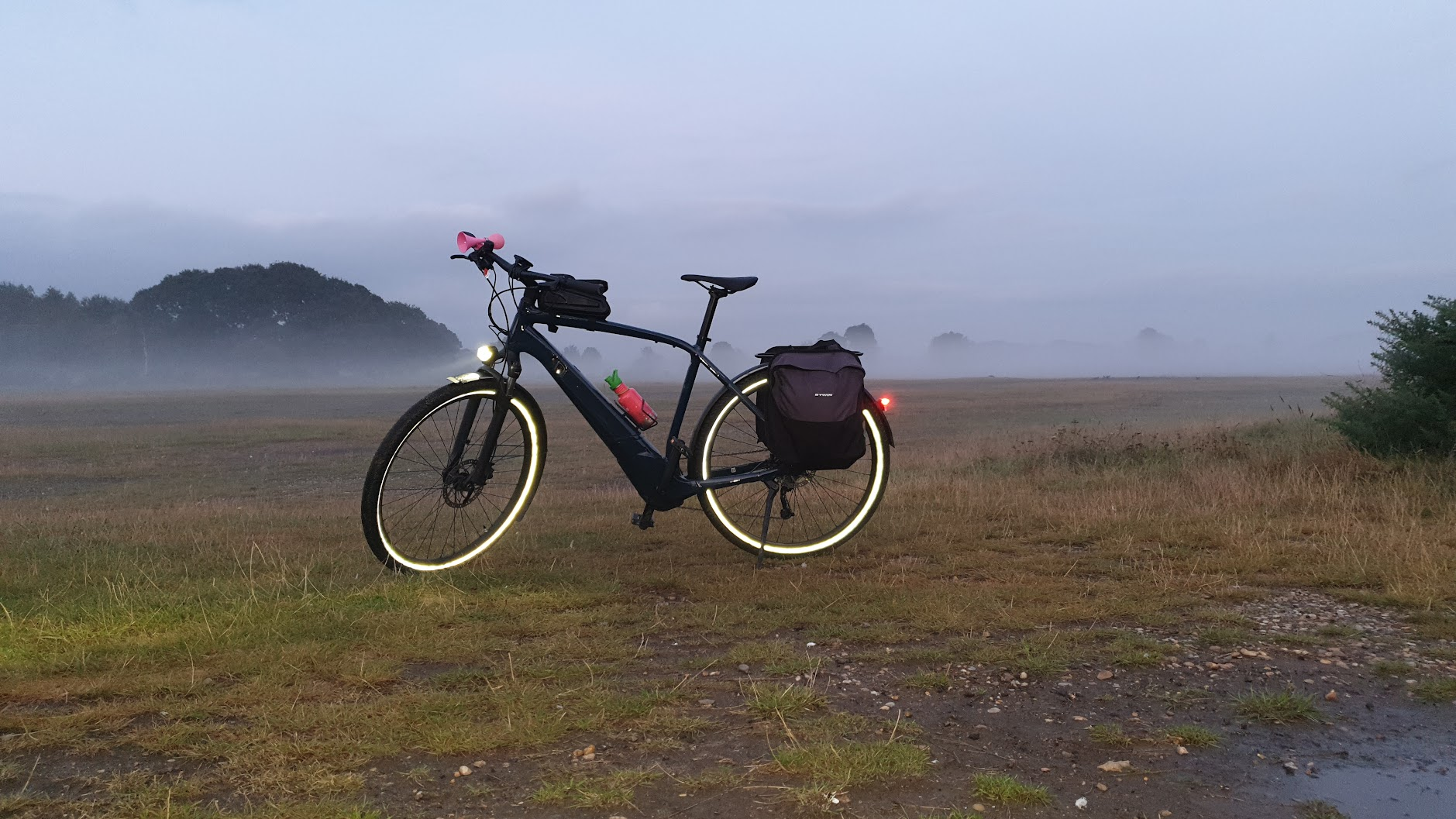

Fun fact.
Allegedly, reflective strip on the tires is applied by hand, hence why when you spin the wheel on a stand it may appear crooked.
Fun fact two. I took this photo about two miles away from the Olympic Village in London...
