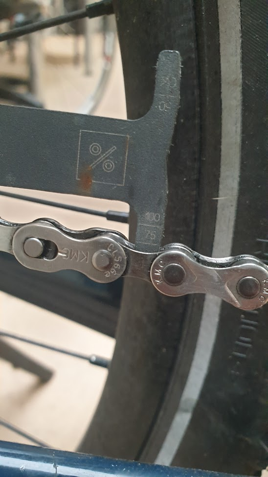

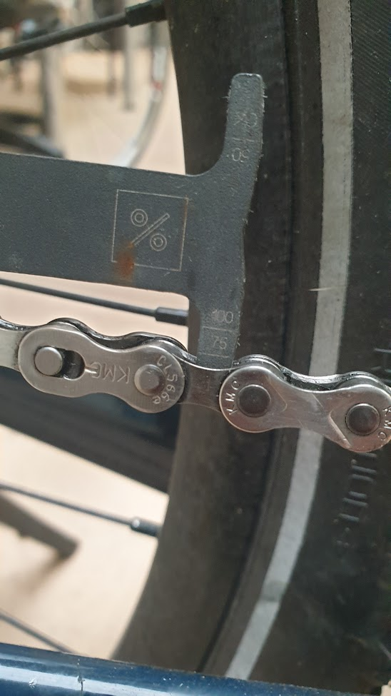

Not happy at all, i can feel the gears grinding even tho wear indicator is at 0.75%

No, Art. The chain should be replaced at 0.5% stretch mark. It all depends on how much you do ride. (Excessively stretched chain is the cassette then chainring killer).

As Stefan said below- chain needs to be replaced when it is worn to say 0.5%. I'm not there yet but I can already feel the gears slipping- it only took 600+ miles, one month of commuting...

I DO read the forum more than I ride, remember ... it's my LBS guess on expected chain replacement, not mine.

Just trying to help you out, since you don't seem to have a cue as to when it's time to replace your chain.
I never said I didn't know when- I only moaned about not being able to lay my hands on the replacement part.
I do agree with you tho- it's good to have this and use regularly- I was lucky as chain was stil at 0.5 (I thought it was0.75) so didn't have to splash out on new cassette- advice from the shop was- get spares while stock lasts...
So, from brand new to worn KMC e9T chain lasted just under 700miles of commuting, mostly on flat, fair bit os stop start due to traffic lights and a lot of shifting, mostly on 50% power and 50assist, occasional 100% 100%
They didn't have that chain, so KMC X9 it is now, we will see how long it will last.
