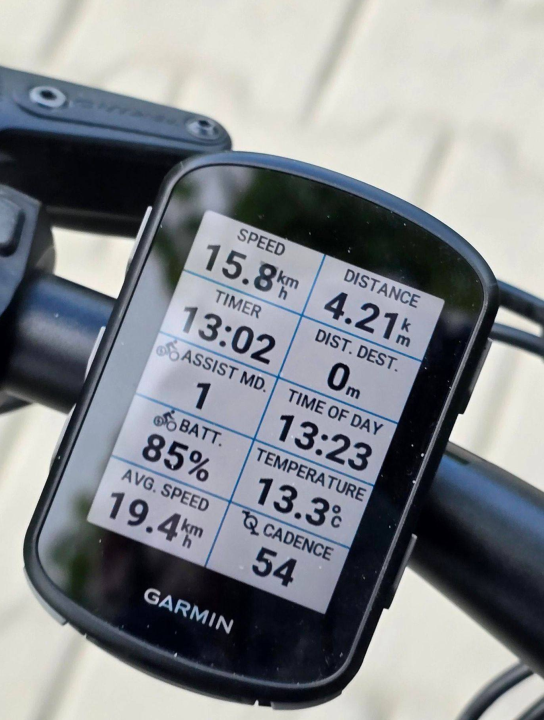

It is doable with Garmin starting from the 540 (Explore 2 might miss the LEV ANT+ capability but I know the 540 supports the protocol). Now, the x35 has the LEV ANT+ protocol built in, so you can connect your e-bike to a Garmin as an E-Bike Sensor.
The primary function of the x35 and Garmin connection is visualising several e-bike parametres on Garmin data screens. Garmin will display the current Travel Mode (which is the assist mode such as ECO) and the ebike battery level. (The third parameter is the Range but it does not always work). I cannot verify the Mahle promises but e-bike speed, your cadence and leg power might be reported on the Garmin as well. (I do not own an x35 e-bike, so I can only say it for other LEV ANT+ compatible motors).
However, you are mostly interested in controlling the motor. According to the information found on the internet, you can change the x35 Assistance Mode in case you also buy a Garmin e-Bike Remote and pair it with the Garmin. I have no idea how you install the Remote on your handlebar (please ask a Garmin dealer).
Importantly, a special E-Bike screen of Garmin devices only works with Shimano motors. You would use native data fields of Garmin such as Speed, Cadence, Power, LEV Travel Mode or LEV Battery % for your setup.
Perhaps some owner of a Mahle x35 motor could chime in?

Well, Mahle promises many parametres to display on a Garmin data screen for the x35:
  • Speed/Distance (from the rear wheel speed sensor)
  • E-Bike Battery Level
  • Travel Mode (Assistance Level)
  • Travel Range
  • Rider Power & Cadence
  • Any error messages.
That matches what I could get on a 540 from my Specialized/Mahle mid-drive motor.
I only have no certain information how you could control the assistance mode of your motor.

Looking for explore 2 or 540. I don't need training features of the 540, so I prefer touch screen. Only miss strava segments, but it isn't really important, just explore 2 doesn't have it, if one day I change my objectives. One big worry is some people say they cannot connect to the bike... with pulsar one, I really don't neeed it, but once I'm going to invest, makes sense the device can connect the bike.
Strava E-Bike Segments are still unavailable on any Garmin or Wahoo and I doubt these will be ever made available to GPS bike computer manufacturers. According to Garmin documentation, the Explore 2 has the e-bike connection capability.
Ok, that"s interesting information... I''m really amateur, so strava segments are interesting if I have it, but not that important. On ebike even less important, as it always depends on the assistance that day.. so that info the ebike segments are not available make my mind to the explore 2. One option is to buy it on Amazon, if I cannot connect to the bike I can always send it back during the 30 days.
