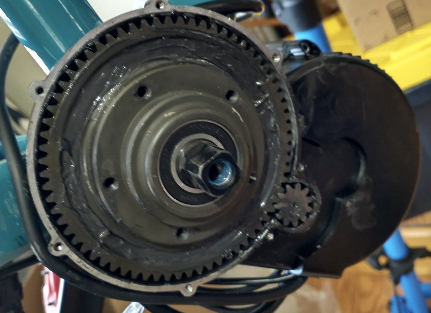

You did say the red lights on the PAS sensor is blinking? Can't see it on the vid.Here is a link to a video of the problem:
The red light on the speed sensor is working. The pedal assist sensor is not visible on this model, to the best of my knowledge. It's inside the motor, I believe.You did say the red lights on the PAS sensor is blinking? Can't see it on the vid.
Try to get a look at the PAS sensor, make sure it didn't get knocked out of place or disconnected etc.The red light on the speed sensor is working. The pedal assist sensor is not visible on this model, to the best of my knowledge. It's inside the motor, I believe.
Thanks. I can't figure out exactly where the PAS is. Is it behind the 2 gear like pieces pictured below?Try to get a look at the PAS sensor, make sure it didn't get knocked out of place or disconnected etc.
If there is a wire conector for the PAS, pull it off and reinsert it to make sure.
It wouldn't be behind those gears, it is a magnet, so it needs to be close to the PAS magnet wheel,you said there was a magnet knocked out of place on the PAS wheel. Look adjacent to where those magnets rotate.Thanks. I can't figure out exactly where the PAS is. Is it behind the 2 gear like pieces pictured below?
Show a pic of the PAS magnet wheel.It wouldn't be behind those gears, it is a magnet, so it needs to be close to the PAS magnet wheel,you said there was a magnet knocked out of place on the PAS wheel. Look adjacent to where those magnets rotate.
I'm sorry, the magnet on the speed sensor is what got knocked out of place.It wouldn't be behind those gears, it is a magnet, so it needs to be close to the PAS magnet wheel,you said there was a magnet knocked out of place on the PAS wheel. Look adjacent to where those magnets rotate.
