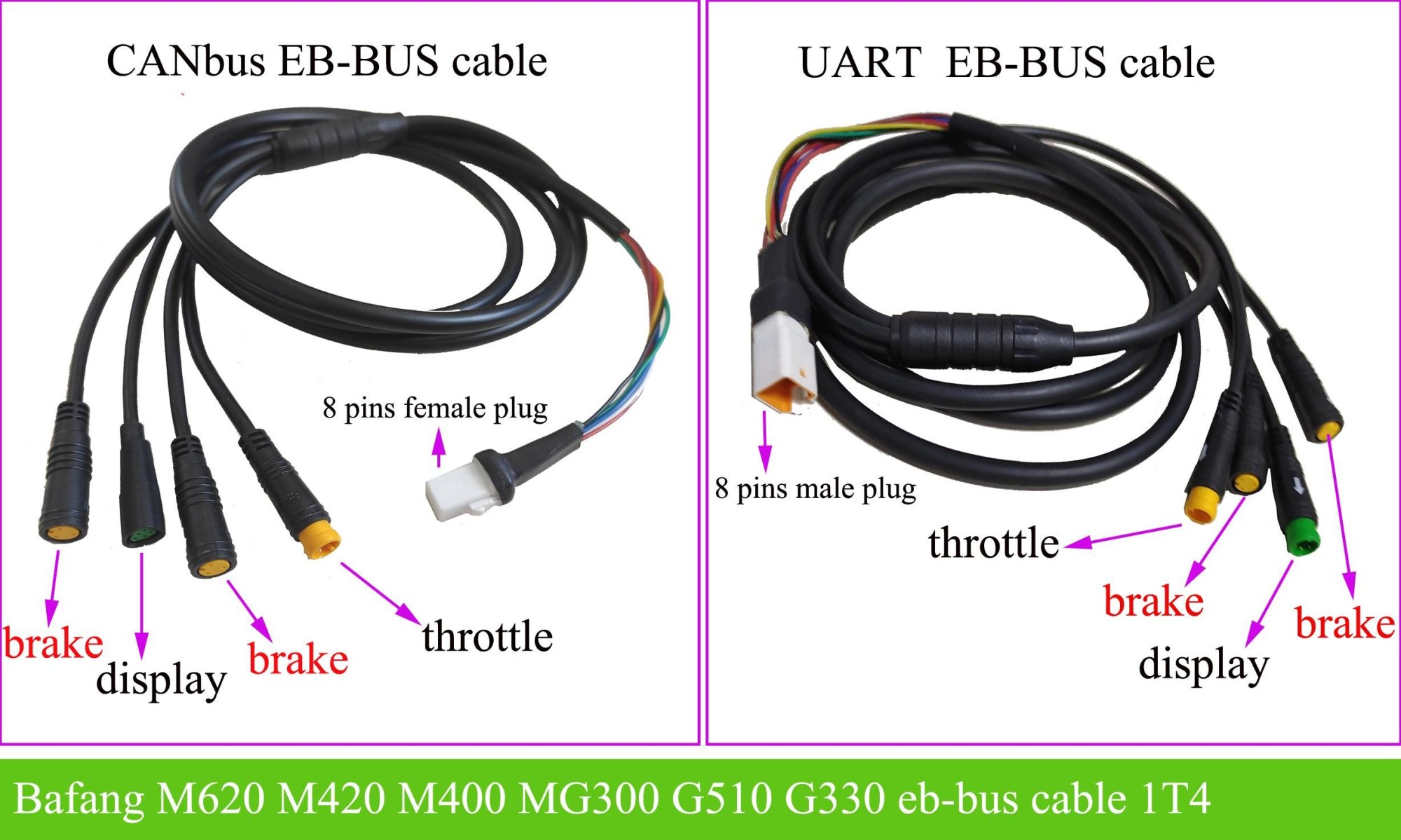

The torque sensor is part of axle assembly that you installed the new clutch on... So follow and check that wiring well.
Then I'd unplug and reset all the connectors on the controller.
If your motor Is UART... You can use the programming software to check the torque sensor output
