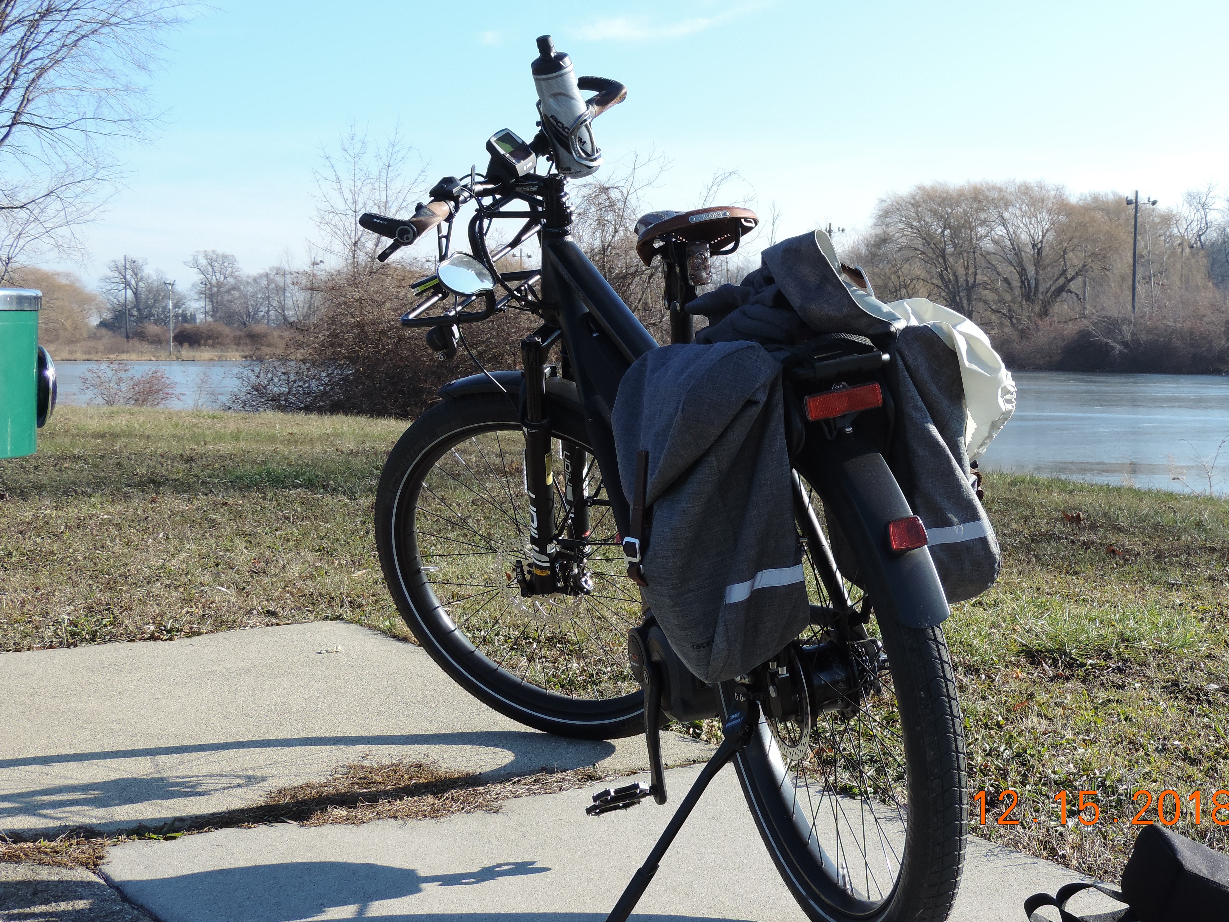

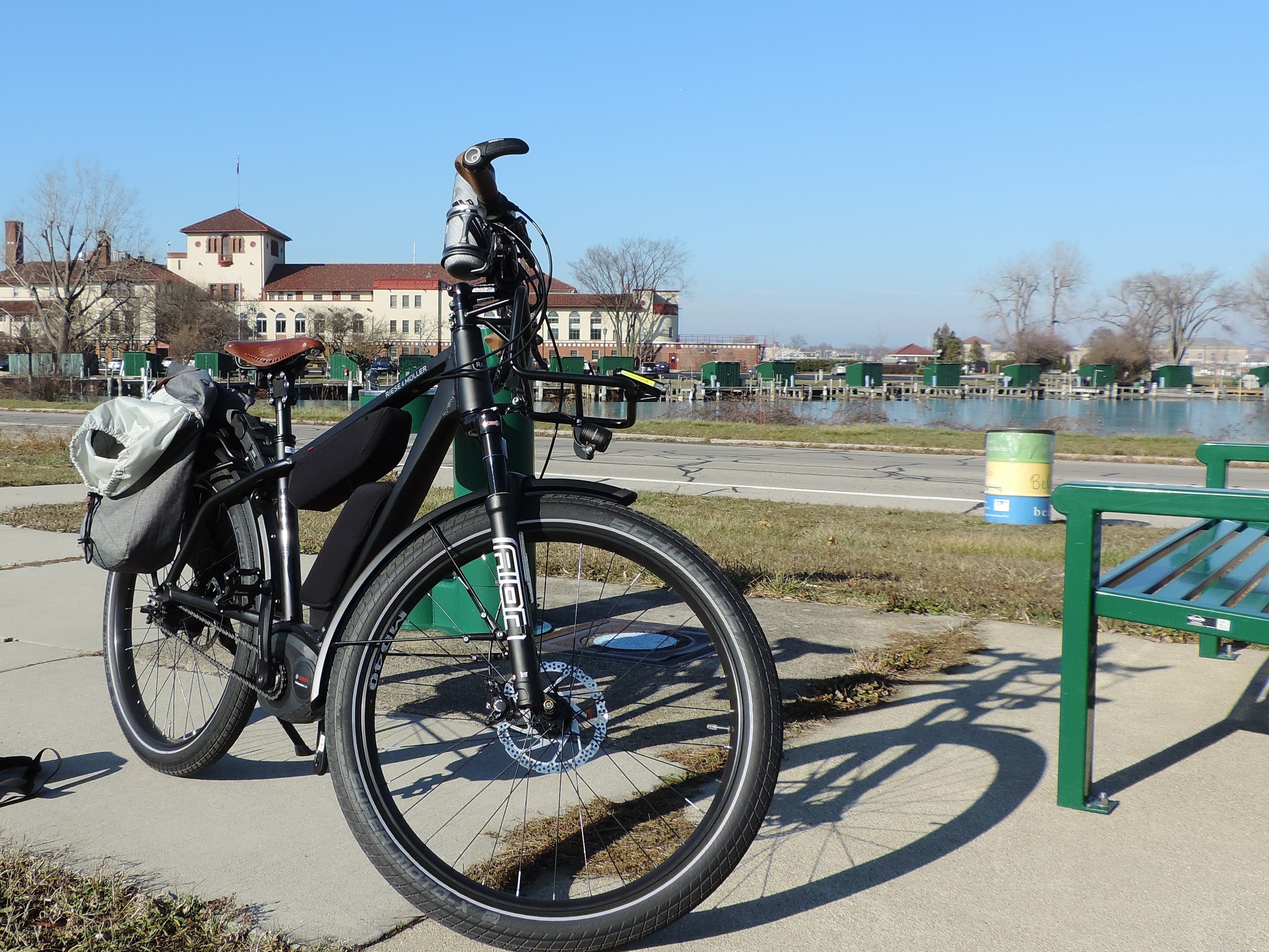

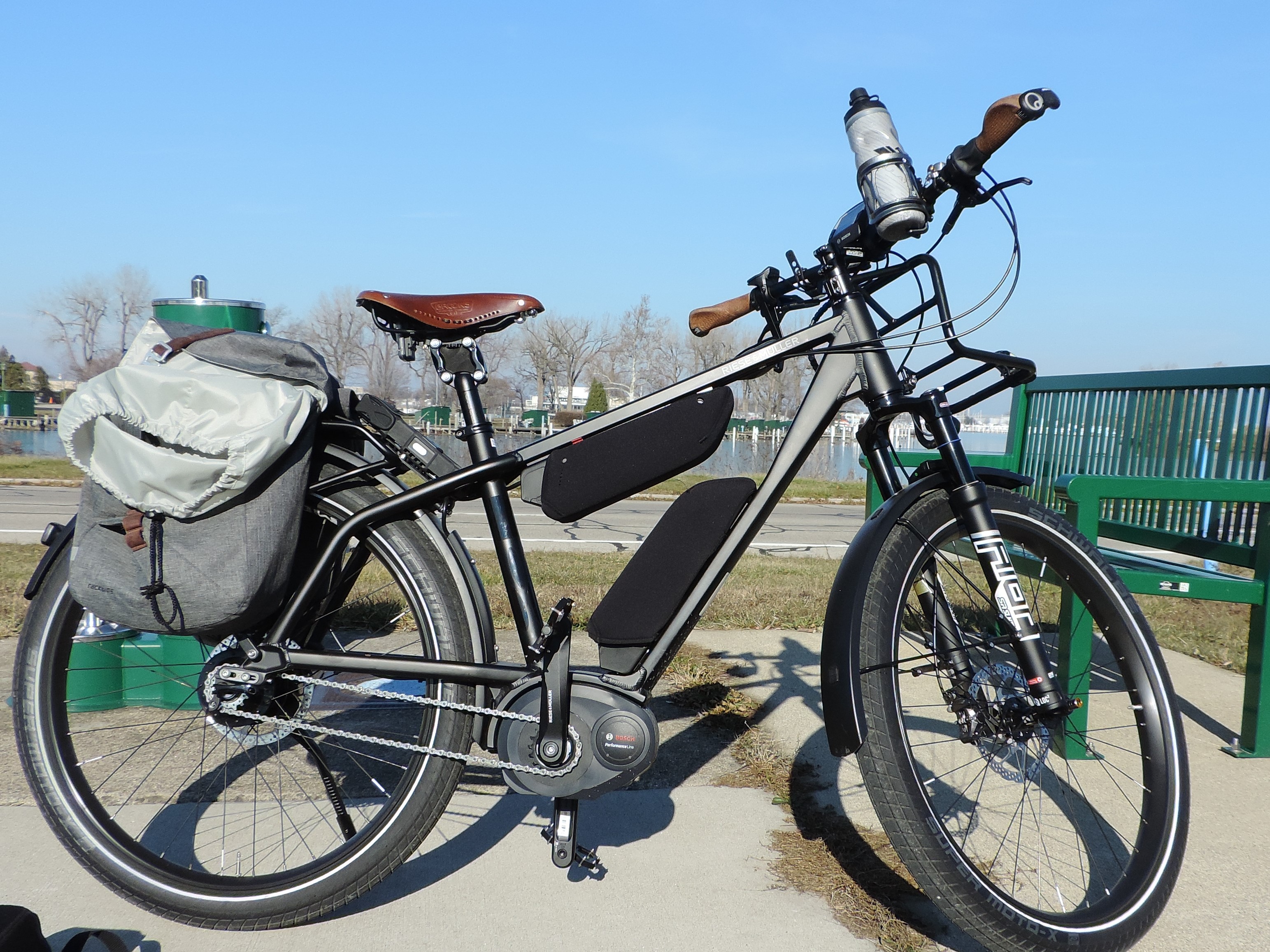

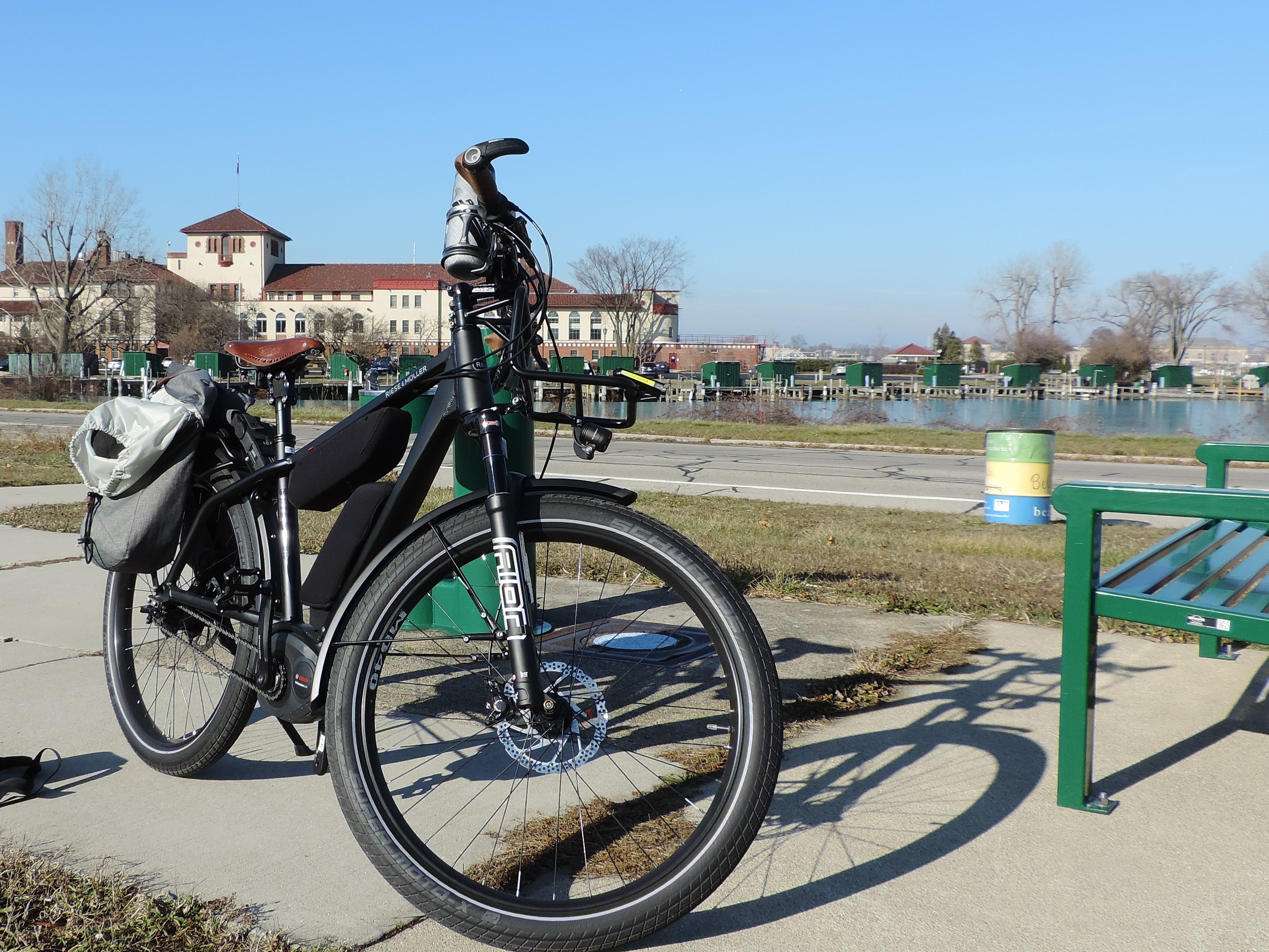

I made my longest ride on this bike today (actually on any bike ever). A nice, unseasonally warm day was forecasted (45F and sunny) so I charged 2 500 wh batteries to around 85-90% (estimating). 32F at outset 9:30a.m. and estimated Eco range was showing 110 miles.
I rode to Belle Isle State Park. Carried along some snacks. Stopped in a museum. Stopped for lunch and coffee. Hope to post a picture tomorrow.
Total ride was 49 miles which I was a bit disappointed with (was hoping to at least pass 50). Ride time was 3 hours 21 minutes. I guess 50 miles is close to my one day limit because I was starting to get a sore rear and lower back. I could have done another 10 for sure but my rear-end and lower back would not have been liking it much. Maybe time to tighten the Brooks just a tad.
I returned showing 53 miles of Eco range so that initial estimate was pretty accurate. I rode (estimating) 38 of the 49 miles in Eco. The rest Tour and maybe less than a mile in Sport. I intentionally took a slow pace for the first half of the ride. Keeping my max speeds around 20 mph (all Eco) with a nice comfortable cadence.

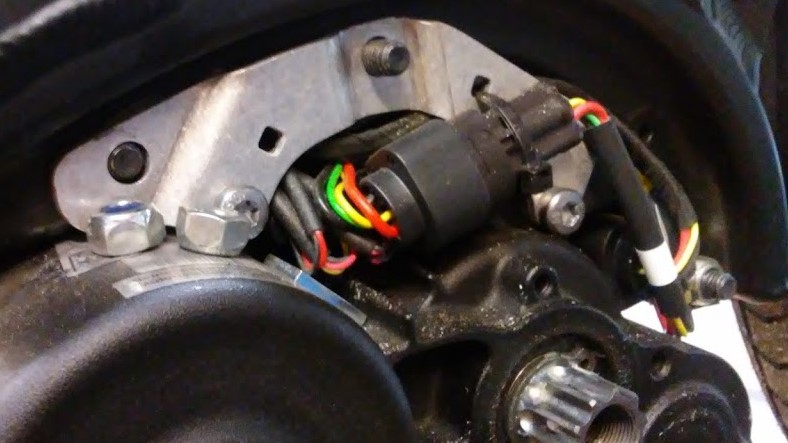

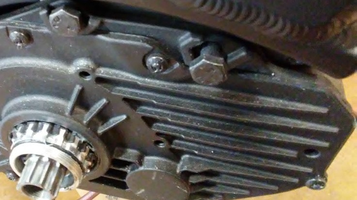

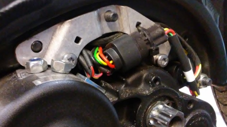

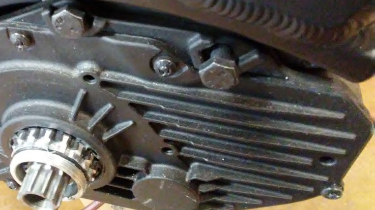

I had a minor issue with the Bosch motor - fortunately caught something early before it became a real issue: On occasion, I turn my bikes with suspension forks upside down - to allow the oil in the forks to flow down and reach the seals. On turning over my Charger GX I heard something rattling around in the motor cover. I was pretty certain it wasn't in the motor itself because there were no performance issues with the motor. I heard this prior to my almost 50 mile ride described above. I heard no noise while riding - probably too much road noise to hear anything rattling. I dropped the bike by the LBS last week and asked them to check it out. They gave me the two pictures attached here. Two of the motor casing nuts had come loose on one side and on the opposite side one of the bolts was backing itself out. It hadn't fallen out because the exterior casing didn't leave it sufficient room to back all the way out. Our roads around here are sometimes pretty bad but I don't have a lot of miles on the bike. I'm supposing things weren't sufficiently torqued down coming from the Bosch factory:20190107_BoschMotor1.jpg20190107_BoschMotor2.jpg
I had a minor issue with the Bosch motor - fortunately caught something early before it became a real issue: On occasion, I turn my bikes with suspension forks upside down - to allow the oil in the forks to flow down and reach the seals. On turning over my Charger GX I heard something rattling around in the motor cover. I was pretty certain it wasn't in the motor itself because there were no performance issues with the motor. I heard this prior to my almost 50 mile ride described above. I heard no noise while riding - probably too much road noise to hear anything rattling. I dropped the bike by the LBS last week and asked them to check it out. They gave me the two pictures attached here. Two of the motor casing nuts had come loose on one side and on the opposite side one of the bolts was backing itself out. It hadn't fallen out because the exterior casing didn't leave it sufficient room to back all the way out. Our roads around here are sometimes pretty bad but I don't have a lot of miles on the bike. I'm supposing things weren't sufficiently torqued down coming from the Bosch factory:View attachment 28881View attachment 28882

Despite the roads, nothing jarred loose. I’ve had more of a problem with the plastics. The mask on the Nyon flew off. First day riding the bike, the round “Performance Line” badge fell off. I was moving slowly along the towpath outside of DC so I saw it happen. I thought for sure it would come off repeatedly until ultimately lost, but surprisingly, after I pushed it back in place, it never came off again. A lot easier to catch compared to pulling off the cranks to check bolts inside the motor!
Isn’t opening up the motor by end user grounds for warranty loss?
That's why I had my LBS (Bosch certified) do it.
Seriously, though. I highly recommend loctite for rack and fender bolts and pretty much everything else that can work loose. Which is pretty much every bolt on the bike.
Good move. I guess a bit of preventive maintenance beats the heck out of being in the middle of nowhere with creeping dread as you realize, yes, the clatter I hear is the motor bolts falling out.
