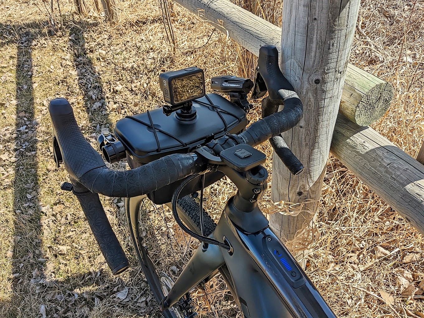

Feel your pain. Having a similar issue (though different) with the Raleigh Competition acoustic bike in NYC. I use it about 10 or 20 times a year at most, and it's $180 to swap out the bars-- and the brakes, cables, etc. Those are full-on drop bars, which I can only stand for a 30-minute fitness ride, and even that isn't wise given how bad my arthritis is AND the fact that I play a lot of guitar on the east coast.
For me, I like under-seat bags best and top-tube bags second gest. Weight is lower, will swing around less. I can stuff a synthetic fabric jacket, a set of wrenches, a little tin for meds, and maybe one other small tool under the seat. The top tube bag is my micro-pump and tubeless fix-a-flat kit.
I would NOT add extra weight to the handlebars under any circumstances. Though I did acoustic bike touring as a kid-- I had a RADIO with two "C" batteries on the handlebars; it was huge, about four inches square and five inches deep, probably weighed four pounds. I loved that thing, though there were few rock music stations on the back roads of Florida in the mid-70s. But I was 17 years old or whatever, this was right before I got sick for the first time, and didn't notice a lot of stuff that I would find uncomfortable, etc.
There are a lot of ways to solve this problem.
You can consider some of the more exotic drop handlebars like the Redshift Kitchen Sink handlebars that have additional gadget space.
If you look around there are some handlebar bags with light mounts and if they have a top map pocket you can improvise a way to carry your phone, a GPS, or a bell with a belt clip, a case, and some epoxy:
You can do the same thing with a front rando rack and front rando bag. Most rando racks have light mounts. You can use the same hacks to mount your phone and a bell to the lid of the rando rack. I like rando bags because they are enormous and roomy (you can usually fit a small bag of groceries in one).

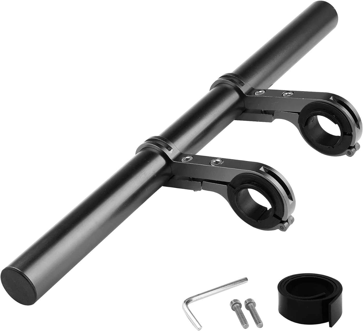

When I rode an anolog touring bike withbdrop bars (Fuji Saratoga). I carried everthing you described except headlight.
Handlebar extenders like this are inexpensive ($8 for this one) and you can cut down the tube if you find it to be too long.
For a little more $ and heavier weight you can get one with an internal battery to charge your phone or GPS in a pinch.
Frame bags are nice for carrying lunch or jacket or whatever, also inexpensive.

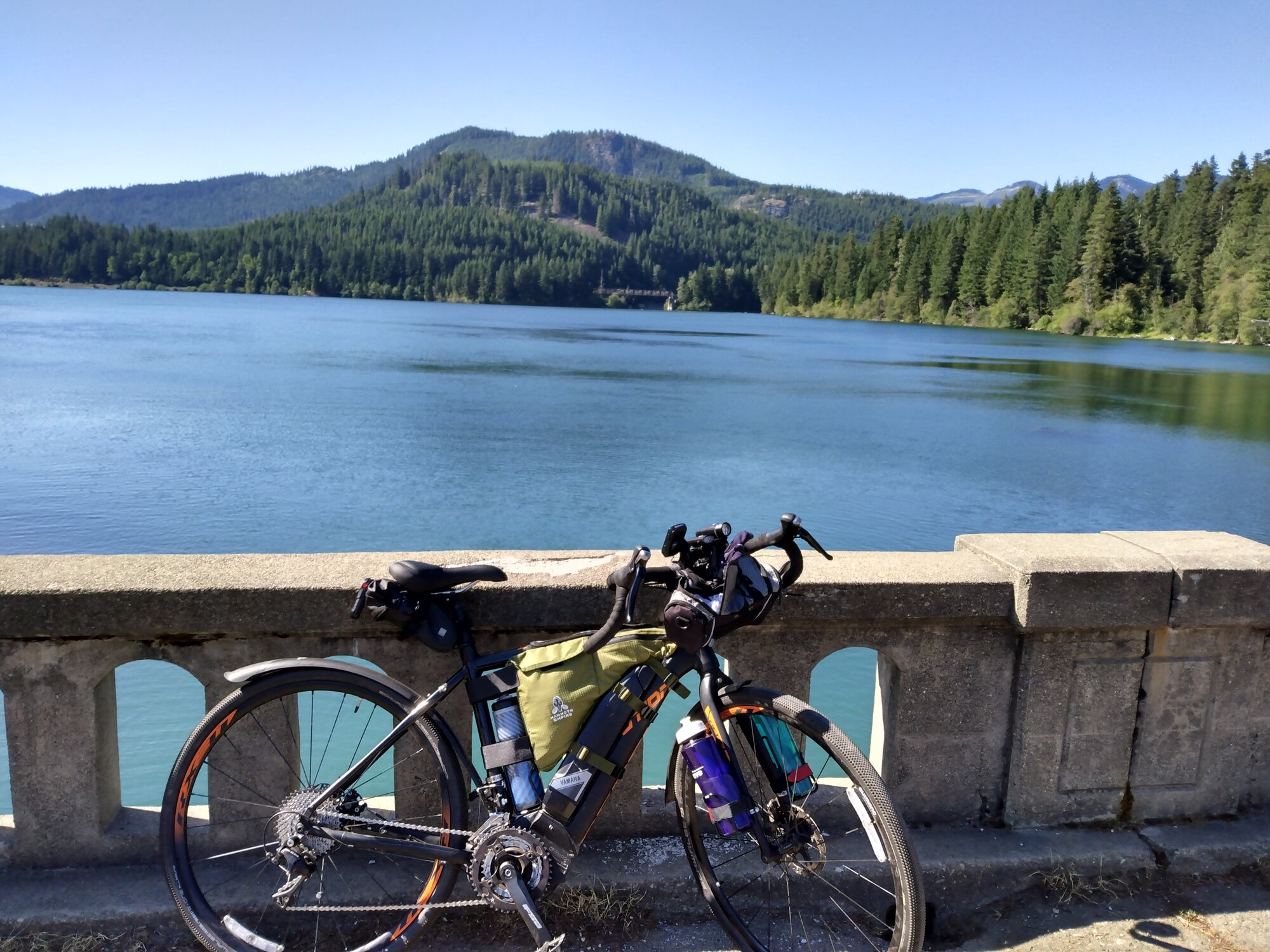

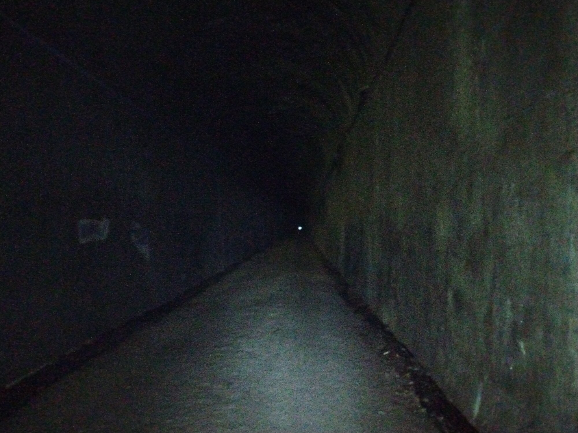

Last week on John Wayne (Palouse to Cascades) trail in WA.
Used the handlebar extender to mount a couple headlights which were needed when riding through the 2.2 mile long Snoqualmie tunnel.

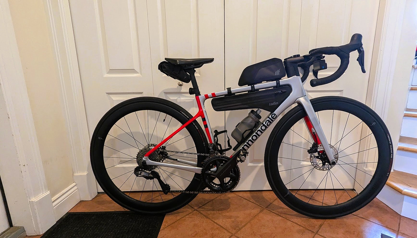

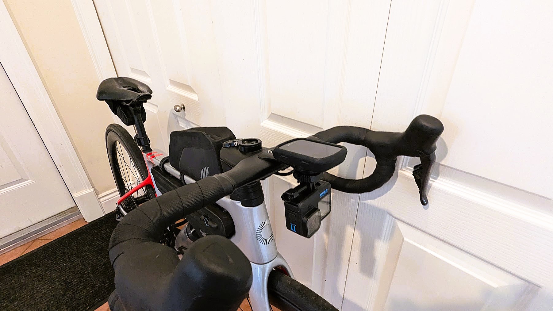

For stowing small items, top tube and frame bags might be ideal for your needs. My road bike will take on the role of a fast-tourer for an upcoming excursion in the fall and this 2.3L half-frame and 1.1L top mounted bag should work well for longer day trips. Multi-day trips will see the addition of a rear rack (thru axle mount) and roll top trunk bag.

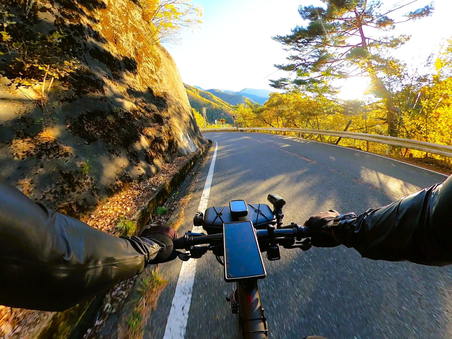

I prefer less bar clutter and use the out front mount on the bike bar to accommodate a Garmin HU along with a GoPro mounted beneath it. I can also swap out the camera with a light and have the option of placing my phone on another adapter attached to the head set cap. Good to know there are now more options for mounting such devices on the Creo 2.
If you require a bit more storage you can choose from a plethora of handlebar bags. We really appreciate the versatility of the Routewerks handlebar bag and find its relatively compact size to be perfect for our needs as we like to travel fast, light and appreciate a clean cockpit. It might not be for everyone though if a larger bag is required for longer trips. I have fitted them to a Creo as well as other bikes without a problem as the bar mounting system only requires four bolts to for attachment. It’s rock solid and unlike other designs that rely on cables to pull taut it won’t droop down over time. The mount design with its flip lever makes the bags super easy to install and remove and I love the fact that the lid can be opened on the fly to access contents. It does weigh more than most soft sided versions due to its metal framework and rigid polymer lid but I believe those are two of its best assets. Downside is that it only fits round bars and is rather pricey.

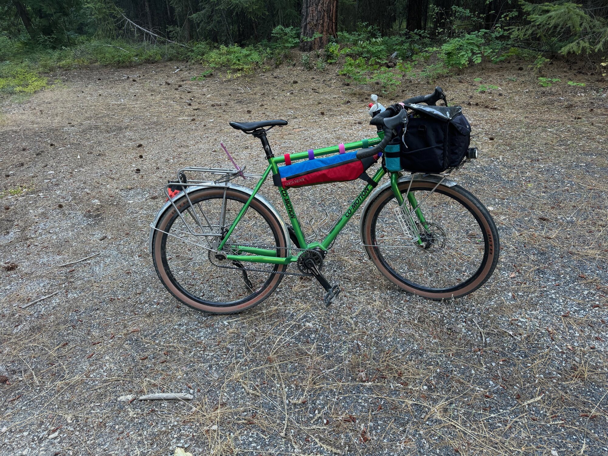

View attachment 179734View attachment 179735

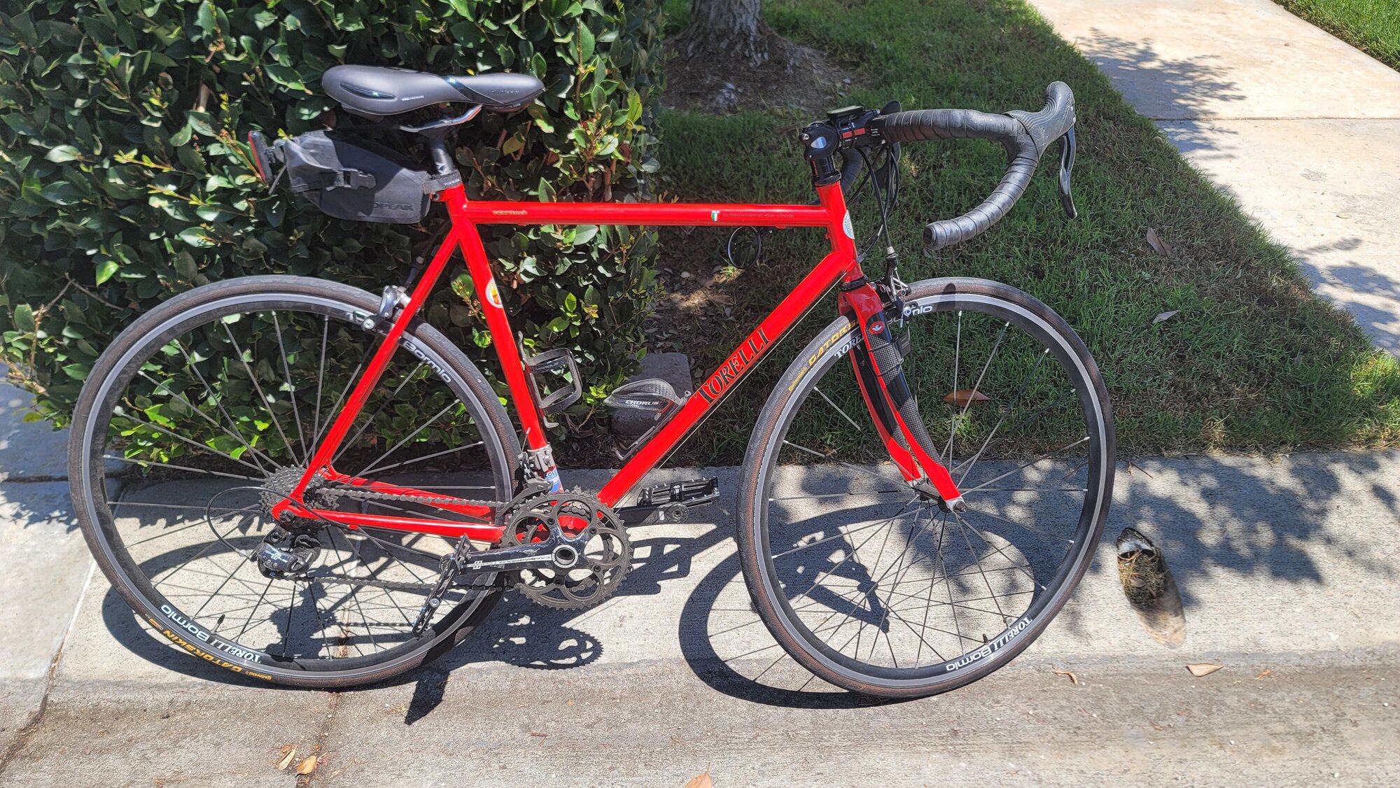

Exactly my thought, so I borrowed this Italian beauty — my neighbor's all-Campy Toricelli — for first-round testing.
The first 5 mi at his low seat height felt promising. Drops were uncomfortable, but the hoods and tops weren't bad.
Then another 5 mi with the seat raised to my height, and every hand position became a no-go. My 76 yo neck went after 3 mi, could see almost nothing ahead. And low back's still sore hours later. Like you, couldn't tolerate the drops at all.
