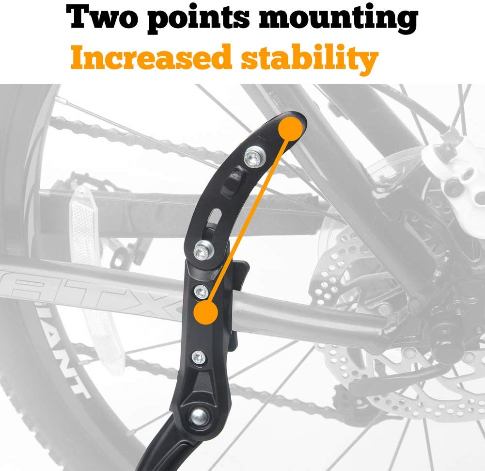

The clip-ons that clamp around a single frame tube are flimsy and may break with a 60 pound bike, You also run the risk of overtightening them so they won't slip and damaging the tube.
If you get one, get the type that clip onto two bars rather than one. At least it won't slip.
This won't work. Like my BH bike with Split Pivot suspension, the chain and seat stay of the OP's bike move independent of each other.

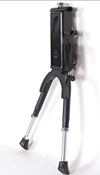

I would really like to find a Motorcycle style double kickstand, but the mid-drive motor prevents mounting on the bottom bracket chain stays.

I have several of the YCS-01 tall. The adventure is finding them as several sellers have dropped them.
I tried googling this and turned up empty handed...?
Yes, me too! California eBike, ebikekit, and one other source had them. They are heavy stands, all steel, but now unobtanium. This is why I wrote, "The adventure is finding them as several sellers have dropped them."
I keep hoping someone has run across them somewhere!
Found it, but derailleurs need the TALL version, not sure what this is. https://www.pistonbikes.com/Bicycle-Adjustable-Center-Kickstand-p/ccasks.htm Pictured is the one I have for derailleur clearance. Still looking. Mind you, theses are quite heavy.

Don't suppose you asked them how thick it is? I was going to buy this some time back but when I look at my thru axle on the threaded side it extends out past the limit of the split axle by an 1/8" maybe tad more than that. Visually the tab for the Luna stand looks thicker which worries me that the thru axle will no longer extend fully through the split axle.
Similar stand I found on Amazon. Do a search for corki mtb stand. Says it can support 40 kg, or 88 lbs. $21 US
Don't suppose you asked them how thick it is? I was going to buy this some time back but when I look at my thru axle on the threaded side it extends out past the limit of the split axle by an 1/8" maybe tad more than that. Visually the tab for the Luna stand looks thicker which worries me that will no longer extend fully through the split axle.
Good land! Luna copied someone else again! Corgi looks nice and two sizes. 10" and 14". Stainless steel instead of Luna aluminum. Interesting Corki adds a "portable storage buckle". Also claim they have a patent. But China never worries about that!
