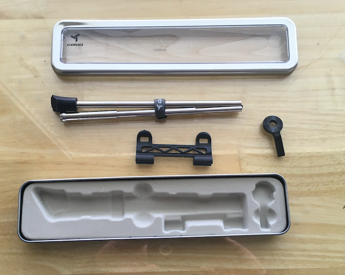

I'm quite impressed with the quality and price point. I tried very hard to bend the stand, it won't fail.
Nicely packaged and really a nice finish and shock-corded sections. Not sure how sturdy the mounting bracket will be but I probably will stow it in a pannier.

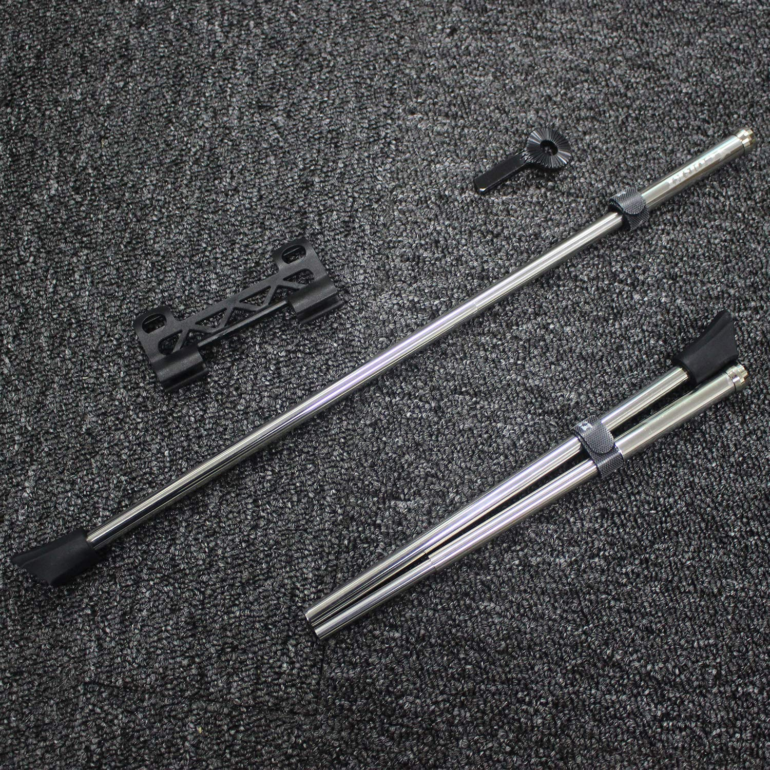

Similar stand I found on Amazon. Do a search for corki mtb stand. Says it can support 40 kg, or 88 lbs. $21 US
Nice find... let's not forget the Carbon Fiber version for the weight weenies... ;)
Good land! Luna copied someone else again! Corgi looks nice and two sizes. 10" and 14". Stainless steel instead of Luna aluminum. Interesting Corki adds a "portable storage buckle". Also claim they have a patent. But China never worries about that!

Ordered the amazon 14" will report back!

I don't think Corki is an OEM or actually manufactures anything, they just sell the same thing that 100 other companies do. More to the point, the link above seemed to be for QuickRelease, not ThruAxel, as are 95% of similar items you'll find online.
I was able to find the same thing on AliExpress, with 12.4mm thru Axel.
